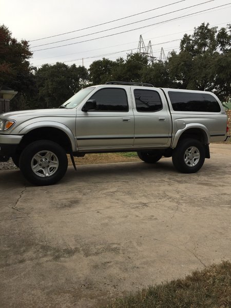

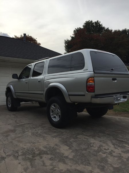

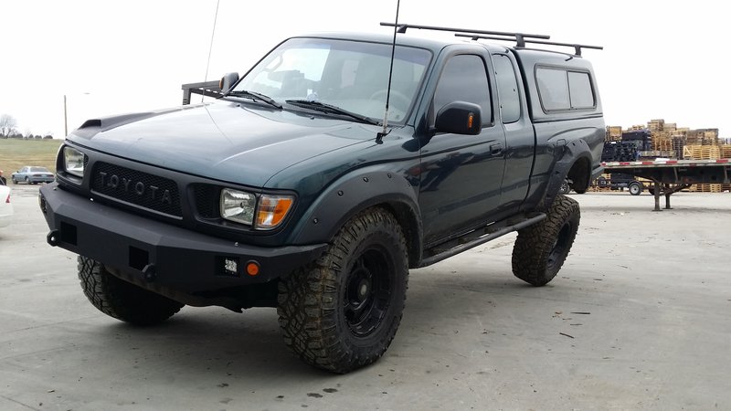

    IMG_0368.jpg Lift finally done, Nitrochargers front/rear, 883's, dakar leaf set. Debating 265/75 v 285/75IMG_0367.jpg

    Looks great. I actually just picked up a set of 2001 4Runner 5 star rims today. I am debating between the 265/75/16 and the 235/85/16. Do you foresee any rubbing issues with either size on a stock access cab? Right now I slightly rub the frame with 265/70/16 on 2nd Gen rims. Thanks for any info

    265/75 should be fine with no trimming, not sure on other size. Your 265/70 shouldn't be rubbing

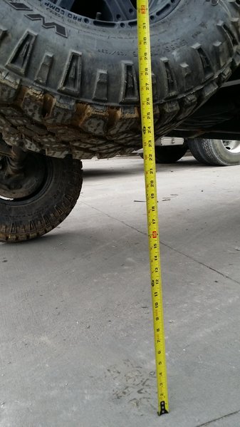

    Almost finished with my install.
    883's, dakars, nitrochargers.
    Overall, pretty happy with how she turned out. Looks like I'm gonna need the add-a-leaf after all, and possibly 1" lift shakles. Also, need to figure out which bumpstops to get.
    For reference, my bro-in-law (pictured) is 6'1.
    bowyer2002, boostedka, jjsul and 6 others like this.

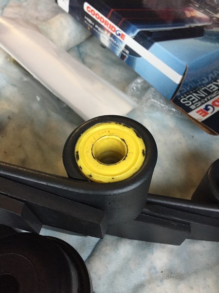

    What bushings are u guys using for the Dakar leaf springs? When I purchased the setup it came with OME bushings for OEM shackles but the one for the eyelet on the leaf is soooo small in diameter! Am I missing something here?
  10. Dec 24, 2016 at 1:52 PM
    #2750
    rngr
    rngr Aix sponsa
    Jan 13, 2015
    #146258
    9,244
    01 SR5 4x4 2.7L
    You lost me. Pics would help.
    You're saying the bushing is too small?
  11. Dec 24, 2016 at 2:05 PM
    #2751
    carofchoice
    carofchoice Well-Known Member
    Dec 30, 2015
    #173539
    699
    Jeff
    Newton, IL
    2003 DC 4X4 TRD, 2012 X-Runner

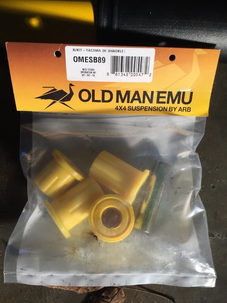

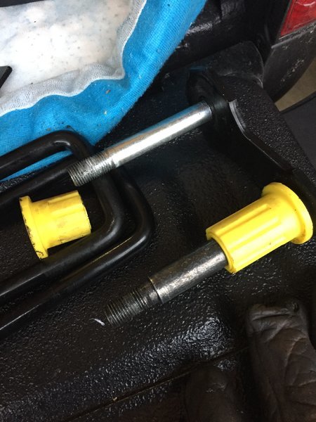

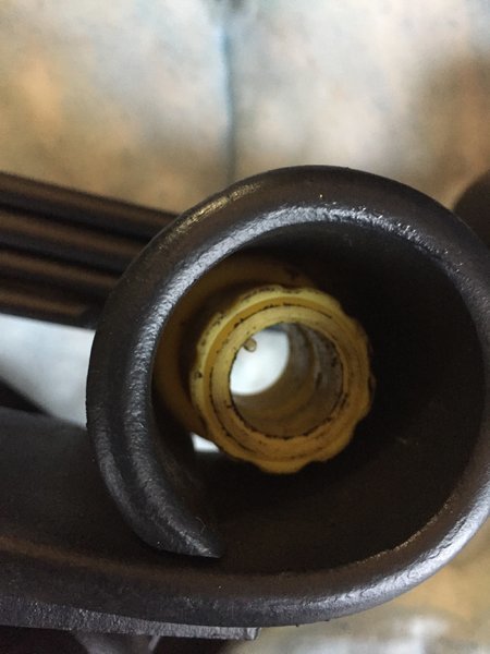

    Correct. Here's what low range sent me.
    Top shackle bushing is fine (on right). The smaller half bushing goes on the lower part of the shackle that connects to the leaf. As u can see in the last pic is the only part of the bushing in contact with the leaf is the outer edge (lip of bushing). I would assume that it's way to much play, am I correct to assume that?IMG_0689.jpgIMG_0691.jpgIMG_0692.jpg
  12. Dec 24, 2016 at 2:09 PM
    #2752
    Deathbysnusnu
    Deathbysnusnu Work is just a daily detour to happy hour.
    Oct 4, 2013
    #113825
    17,087
    Brett
    Fort Crawlins, CO
    Vintage Tundra
    Dog, camper.
    That ain't right, way too small. I used the same kit but didn't have that issue.
  13. Dec 24, 2016 at 2:12 PM
    #2753
    carofchoice
    Dec 30, 2015
    #173539
    699
    Jeff
    Newton, IL
    Kinda what I was thinking. This is the bushing kit they sent me. It says for OEM shackles but they are def way to small. The eyelets on the dakars have a much larger diameter.
  14. Dec 24, 2016 at 2:17 PM
    #2754
    Deathbysnusnu
    Oct 4, 2013
    #113825
    17,087
    Brett
    Fort Crawlins, CO
    Vintage Tundra
    Dog, camper.
    Old pic, and you can just barely see the yellow from the bushing at the top, but there should be a steel sleeve as well. The pic you posted suggests that the yellow bushing is way too small even for that.
  16. Dec 24, 2016 at 2:24 PM
    #2756
    Deathbysnusnu
    Oct 4, 2013
    #113825
    17,087
    Brett
    Fort Crawlins, CO
    Vintage Tundra
    Dog, camper.
    According to Wheelers off road, you may have the wrong part number.
    Rear spring kit, OME #SB88 Complete kit, not sure what springs you have, please verify for yourself.

    Well, will def be getting a hold of low range come Monday morning. Went to put in one of the leafs and found out it was too long. They sent me the wrong ones!!!! They sent me the CS047R for both sides but were supposed to send me CS046RA/RB. Fantastic!!
