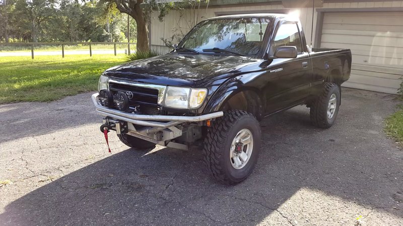

    So I've tried to read up on the OME lift for my 2003 Tacoma Double Cab 4wd. I have an ARB bumper and winch and it is sagging pretty bad and the rear springs are pretty much shot. I'm planning to get the Dakars for the rear with Nitrochargers. My question is should I do 882s up front with the top plate spacer or just get 883s. I'm mostly gonna be doing trail riding and DDing. I would like the truck to have a little rake. What do the experts say?DSCN2849.jpg

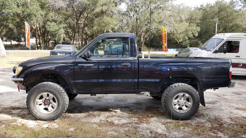

    I have 881s, trail gear low pro, smittybilt 9500
    And bud built skid. Look at my last post.

    V6? Id go with 883

    Another one

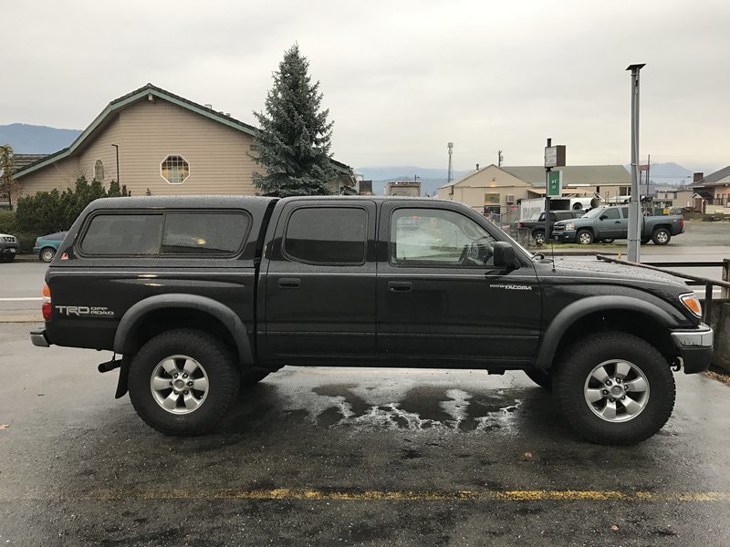

    2003 TRD Double Cab
    Bone stock so far
    DJB1, boostedka and 49erfan like this.

    Same here, nice combo!

    883s are the same size lift as 881s just stiffer for more weight. The 882 will give the most lift but will hold more weight than 881s but less than 883s

    882 or 883, forget the top plate spacer, it causes more harm than good.
    With that bumper and winch and double cab, I'd maybe lean towards the 883.
