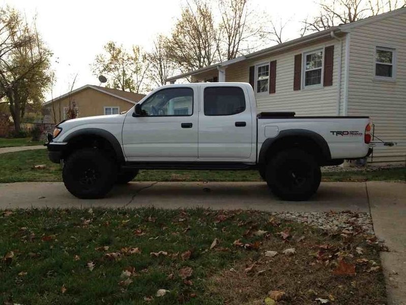

    OME 881 1/4" top plate spacer OME Dakars OME Nitrochargers Light Racing UCA
    OME 881 with driver side trim packer and 1/4" top plate spacer. Dakar rear springs. I'm sitting at 39" in front and 38" in the rear with 32x11.50x15 bfg atko.
    buckmaster243 likes this.

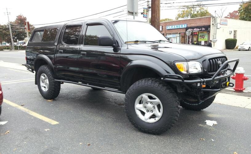

    I'd also say it is BS. Last month I bought 882s from Wheelers.
    882s Front & Dakar Rears - Nitrocharger Sports all around.

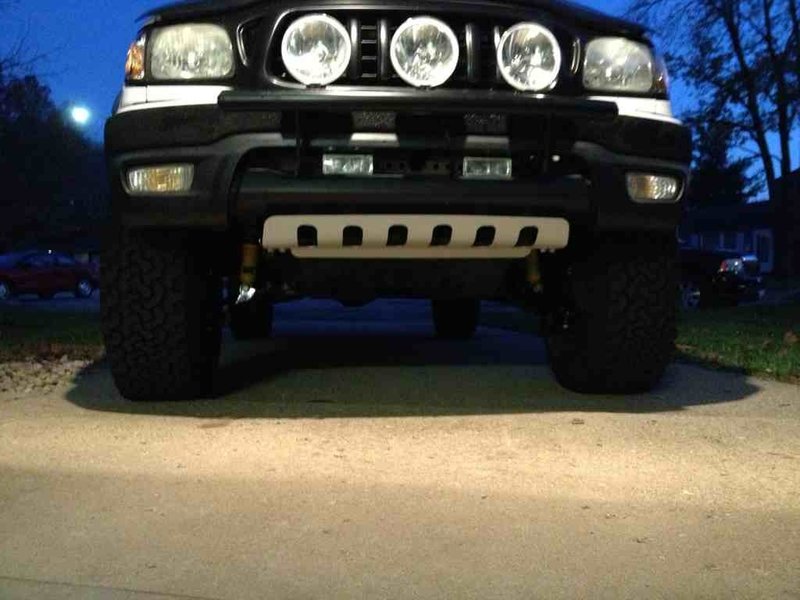

    882's, Nitrocharger sports front and rear, Skyjacker leaf springs

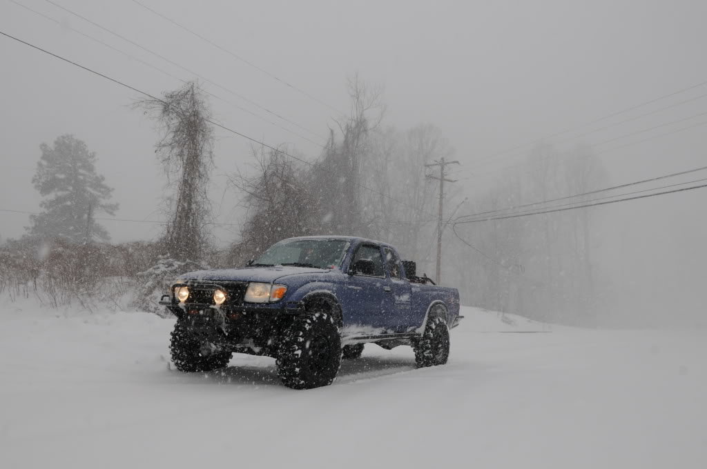

    I'm running 2nd gen OME 883#'s on 1st gen Tundra 5100's set on zero, at first shot me up over 3", now have settled a little at 3", no plans to go higher for alignments sake & CV angle
  20. Jan 12, 2013 at 6:36 AM
    #280
    JDMcQ
    JDMcQ Well-Known Member
    Nov 7, 2008
    #10561
    39,041
    John
    The Mushroom Capital of the World
    You paint them blue Doug?
