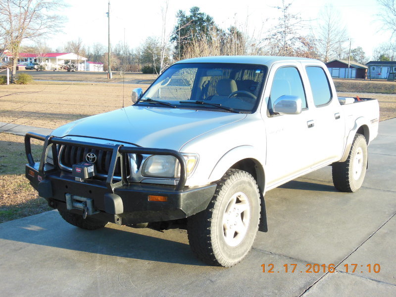

    From personal experience with my truck, and not just stats on paper:
    881s, Dakars, stock bumper - perfect setup w/perfect rake
    881s, Dakars, ARB - "need to re-adjust headlights" rake
    882s, Dakars, ARB w/Synthetic - Perfectly level. Debating Add a Leaf.
    I wish someone had done something like this before I bought my stuff. But like anything, too much "here say" and not enough personal experience.
    Truck is a 2004 Xtra cab 4x4 5spd w/ ARB (no duh) and lots of extras (4500lbs over the scales). Lift over saggy stock height is approx. 2" or so. 265/75/16s

    That looks about right!! Thanks for all the input. Do you have the top spacer plate on the 882s?

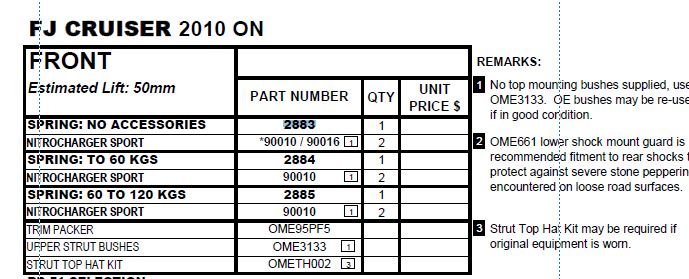

    WOW.... I'M LOOKING RIGHT at the OME CATALOG 883 fit FJ's. fallowing pics are out of there catalog.

    882 are listed for a Prado but the work because there the same size just longer

    I'm looking at my post. I stand corrected they will fit according to the measurements. My bad,
