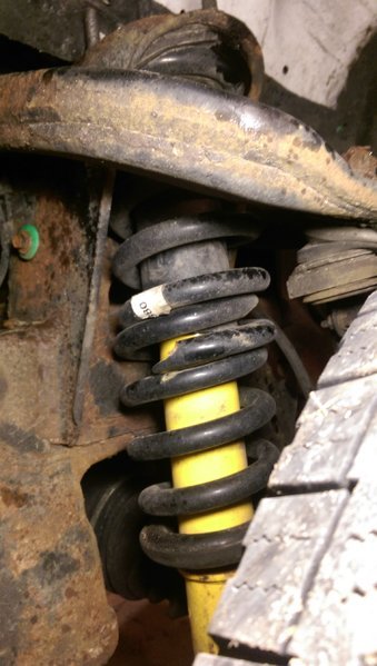

    My set up didn't last long. I estimate 10k miles. I hit a big, Michigan pot hole and this was the result.
    Can I buy 1 OME 880 spring?
    They were on such a short time, my original TRD/Bilsteins were still sitting on the shop floor. Swapped out the assemblies and 20 minutes later I was rolling out the door.
    I drove the truck for a week apparently. I remember hitting the pot hole then hearing a weird rubbing sound. It reminded me of of the rubber dust cover on the shock. I figured that was what was making the noise, so I continued to drive it. It sounded like rubber rubbing on metal. The best I can describe it.

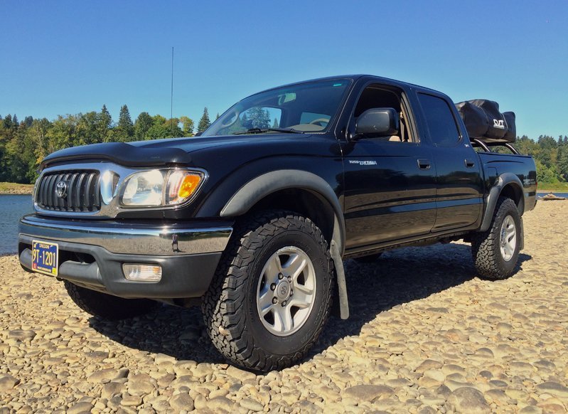

    Somebody already answered, but yes 235/85/16 will work on stock suspension. I have no rubbing, still have the OEM mud flaps, and did not have trim.
