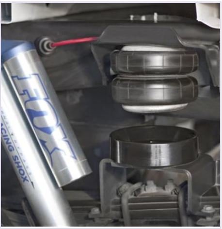

    Building Some brackets myself now. I have an AAL and it rides like shit. But I do a lot of hauling like you. So bags would work better for me. Plan on running the Daystar cradles to allow suspension movement when needed.daystar cradles.jpg

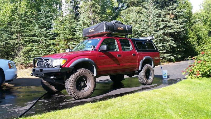

    883 with a stock bumper was fine. CVs slung a tiny bit of grease a year and a half in, but nothing serious. Then added a plate bumper and they only improved in ride. I actually think they'll be too soft once I add a winch.

    Nice bumper! Who makes it?

    Bruteforce Fab
