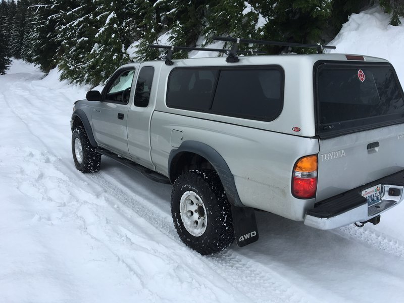

    OME's gave me a 3" lift, no noise or squeaks. Love em'IMG_0271.jpg IMG_2466.jpg

  15. Jan 28, 2017 at 7:25 PM

    I like your rims and tires. What are they?

    2002 Tacoma 2.7l 5spd

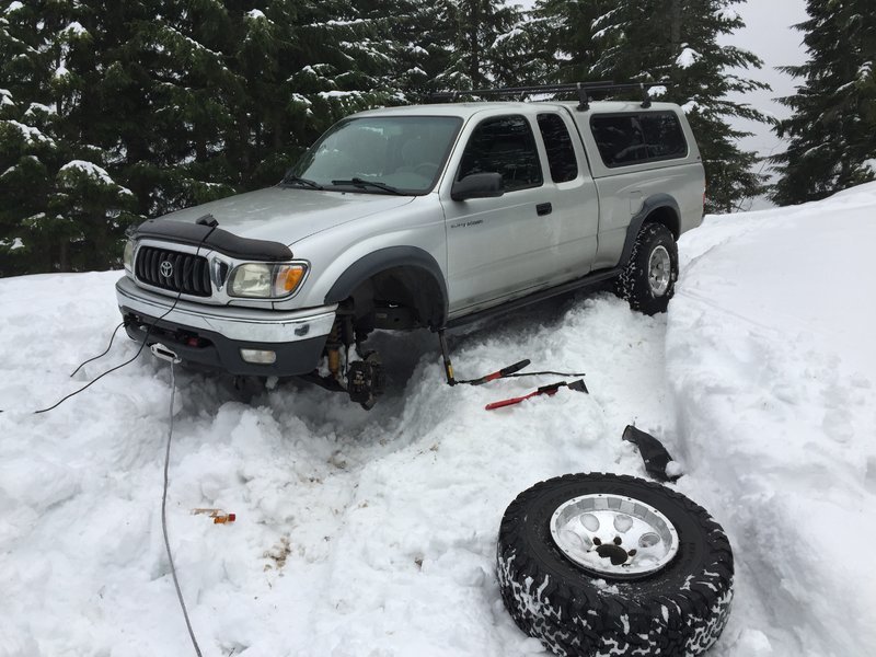

    I'll try to find out about the rims - don't know if I still have paperwork on those. The tires are BF Goodrich AT KO2's. 31's. This is what they look when you air them down to 15psi and then get stuck and winch sideways! Since that trip I now always carry my hi-lift and starter fluid to reset the bead! And yes, that is a bottle of whiskey sitting in the snow about 3 feet in front of the bumper, lolIMG_2485.jpg
