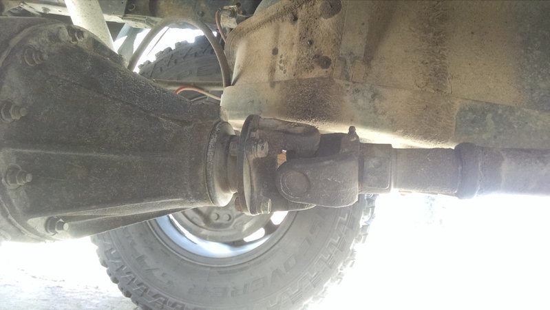

    It all comes down to the pinion and the driveshaft angle at the axle. Since 1st gens were blessed with a double cardan joint, (something that 2nd gens are severely lacking)
    all we have to do is set the axle pinion so that it is in line with the driveshaft. It will most likely need to be rotated up with new springs. Really very simple operation compared to the nightmare the 2nd gens are subjected to.

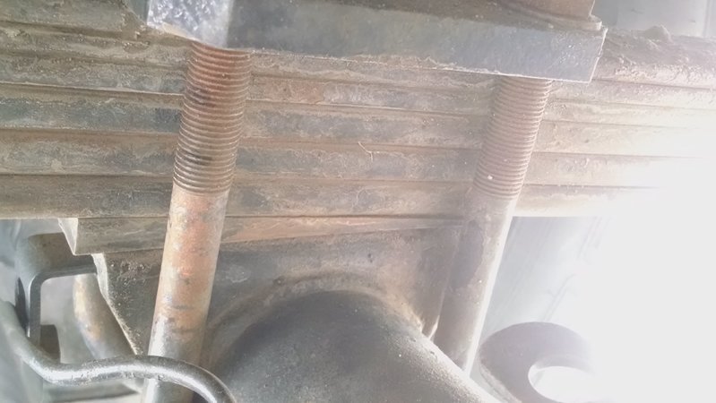

    A 3° or 4° set of tapered shims is usually all it takes. I used 4° shims as they were available locally.
    Use steel shims, avoid the aluminum ones as they will deform quickly.

    4° shim at the bottom of the pack, on top of the perch. The fat end goes towards the rear of the vehicle. It rotates the snout of the axle up when installed like this.
    to achieve this.

    Has anyone ran shims in conjunction with axle relocation plates? Thoughts?
    I'm running dakars, and have the 55-60 mph vibe that I would like to be rid of. However, it seems like stacking the shim on top of the relo-plate is getting the springs a long way from the axle. I don't want to end up with some crazy axle wrap.
