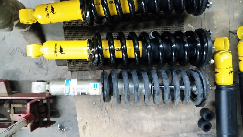

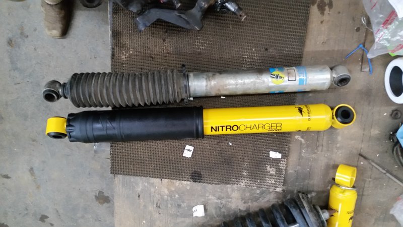

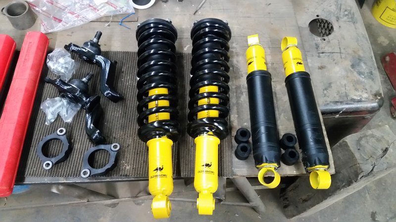

    Just got my 881's and nitorcharger sports on this morning. Put some new cooper at3's and OEM LBJ's on too. Huge difference in ride quality, truck feels good and solid now and much smoother. I had 5100's with stock coils at third notch up front and 5125's on the rear. Was also running Mickey Thompson mtz's so no surprise it rides better.
    I have an ARB bumper with no winch and it has minimal rake. Once it settles, I should have just enough rake to sit level when loaded with gear. I've got my old tires and wheels in the bed in the pictures. 20170318_103020.jpg 20170318_103050.jpg 20170318_051002.jpg 20170318_055719.jpg 20170318_085730.jpg
