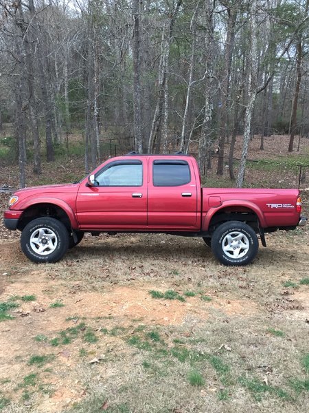

    Joined the OME team last week. Swapped Eibach 620's for 881's with 3/8" lift enhancer and removed sway bar in front. Swapped factory leaf packs with add-a-leafs for Dakar's in rear. Way better ride and flex. 881 FTW. Now deciding on 255/85/16 ST Maxx or 265/75/16 K02!! Decisions!! IMG_0737.jpg

    Thanks @m3bassman ! Like the way the KO2 looks but I've heard great things on the ST Maxx. I leaning towards 255's. what size you running ? 285 ?

    I had 285 with the 620 Eibachs. They rubbed bad.i don't want that much rubbing. Sold them and prob gonna try 255. Wish they made 255 in a K02!!

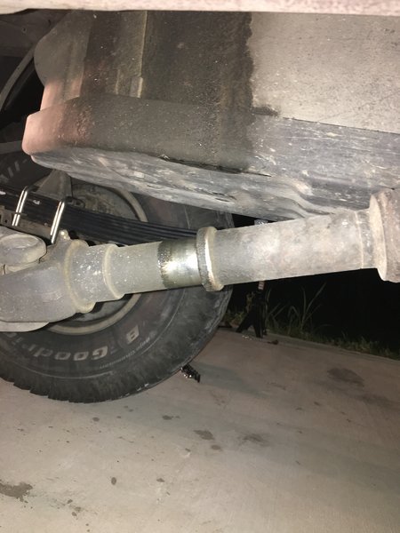

    So...I got the leafs installed tonite. Dakars with AAL. It jacked the rear end wayyyy up. How much will it settle with a few hundred miles? If it doesn't settle down some I'm gonna have to take out the extra leafs. Also, it's vibrating pretty bad now when I drive it. What causes that? Is it the drive shaft? Here's a couple pictures.

    Can you use old man emu add a leaf Springs on stock leaf packs

    Mine didn't settle much if any, i just did the Dakars w/o aal

    If you do carrier bearing drop it might help your vibration out some

    The damn thing is also still leaning like a son of a bitch. Almost an inch and a half to the drivers side, which is how bad it was before. What the hell?

    I have the same issue I have bilstein 5100 in the front and I have the drivers side adjusted up and the back still leans in the back

    Did leafs come with + and -

    One had a - and one had a 0. I put the 0 on the drivers side. I'm going to start a new thread so as not to hijack this one

    You installed on correct side

    Yea 5100's. lowest setting. Lost about 1/2 to 3/4 inch. But I put 3/8" lift enhancement on. I'm. 1/2" rake lower in front now. Eibachs were way to stiff and to high. I've had 880 both lowest sitting and middle setting on 5100,881,882 and 620 Eibach. 881 is perfect for MY setup. Best ride and lift. What rear springs are you on ?

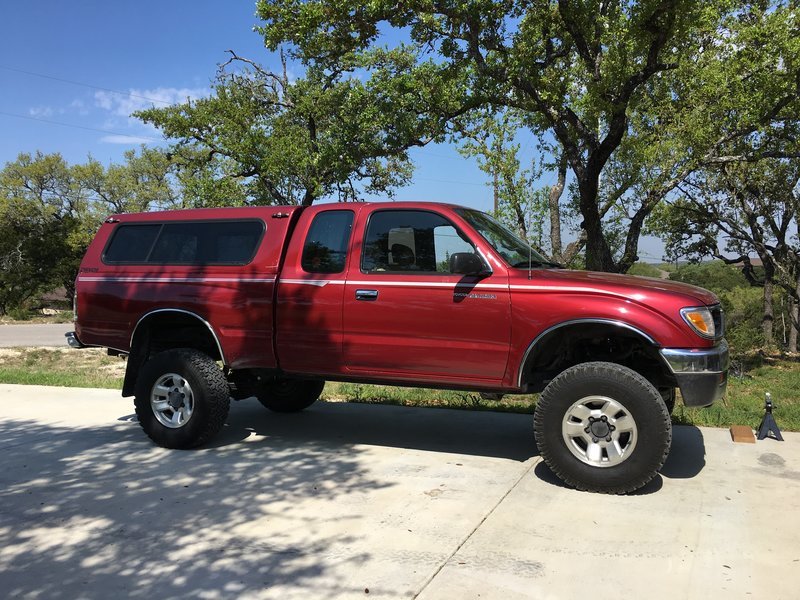

    96 4wd Ext Cab 5spd 3.4
    OME Dakars with AAL in the rear, 883s up front. Bilstein 5100s all the way around. Tires are 31x10.50

    Good looking truck!
