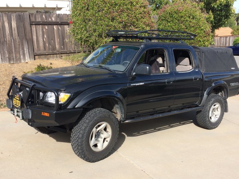

    Bought 883 coils with my OME lift, was running my ARB bumper and BudBuilt engine skid before our Death Valley trip in late 2015...tore a boot, which lead to this:
    3 wheel drive from Saline Springs, through Steel Pass.
    Post trip, I ended up replacing both CV axles, completed the CV boot mod, AND installed my WARN 8000 winch.
    Now almost 18 months later, no issues.
    Just installed 73 lbs. of steel sliders, and with the Dakar HD leaf pack in the rear, this is how I sit:
