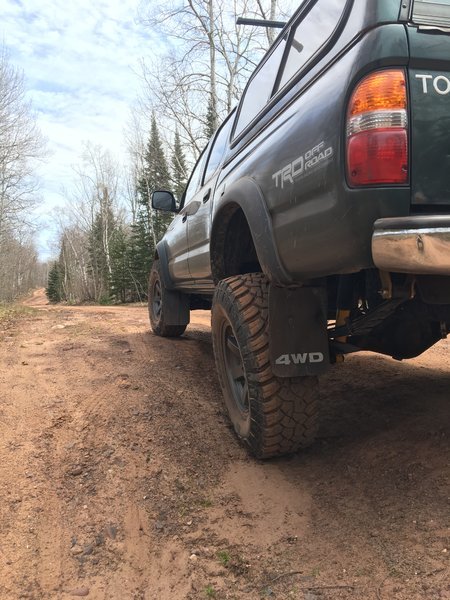

    Finally got a chance to test out the OME suspension. Eventually the road washed out. Mind you, I was by myself 600 miles from home so I didn't push it (7 mile venture to hilltop) so far, I'm satisfied!

    To remove the mudflaps....or to keep them....?
