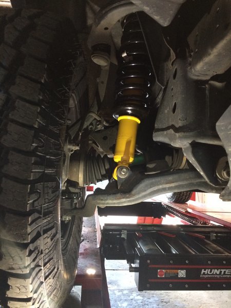

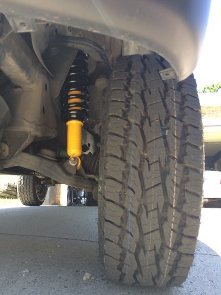

    Anyone recommend axle relocation plates or does this look okay?
  15. Jun 10, 2017 at 1:59 PM
    #3155
    rngr
    rngr Aix sponsa
    Jan 13, 2015
    #146258
    9,244
    01 SR5 4x4 2.7L
    Are you having a lot more rubbing on one side of the well than the other?

    Northern IL
    2015 Tacoma
    I haven't really flexed farther than that since I haven't installed bump stops but it looks like it would hit the front side first.
