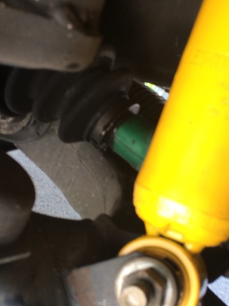

    Pretty sure you said eairler on to keep a eye on my boots. The inner on this side is the only one leaking. I think that's all it doing but thanks for the heads up.

    Did you do the diff drop kit? Mine looked like that before I put mine on and then I decided to "test out" the suspension by jumping a double speed bump and ripped both my boots :luvya:

    Yeah I have the diff drop on. It's just the inner boot on my drivers side which is weird lol

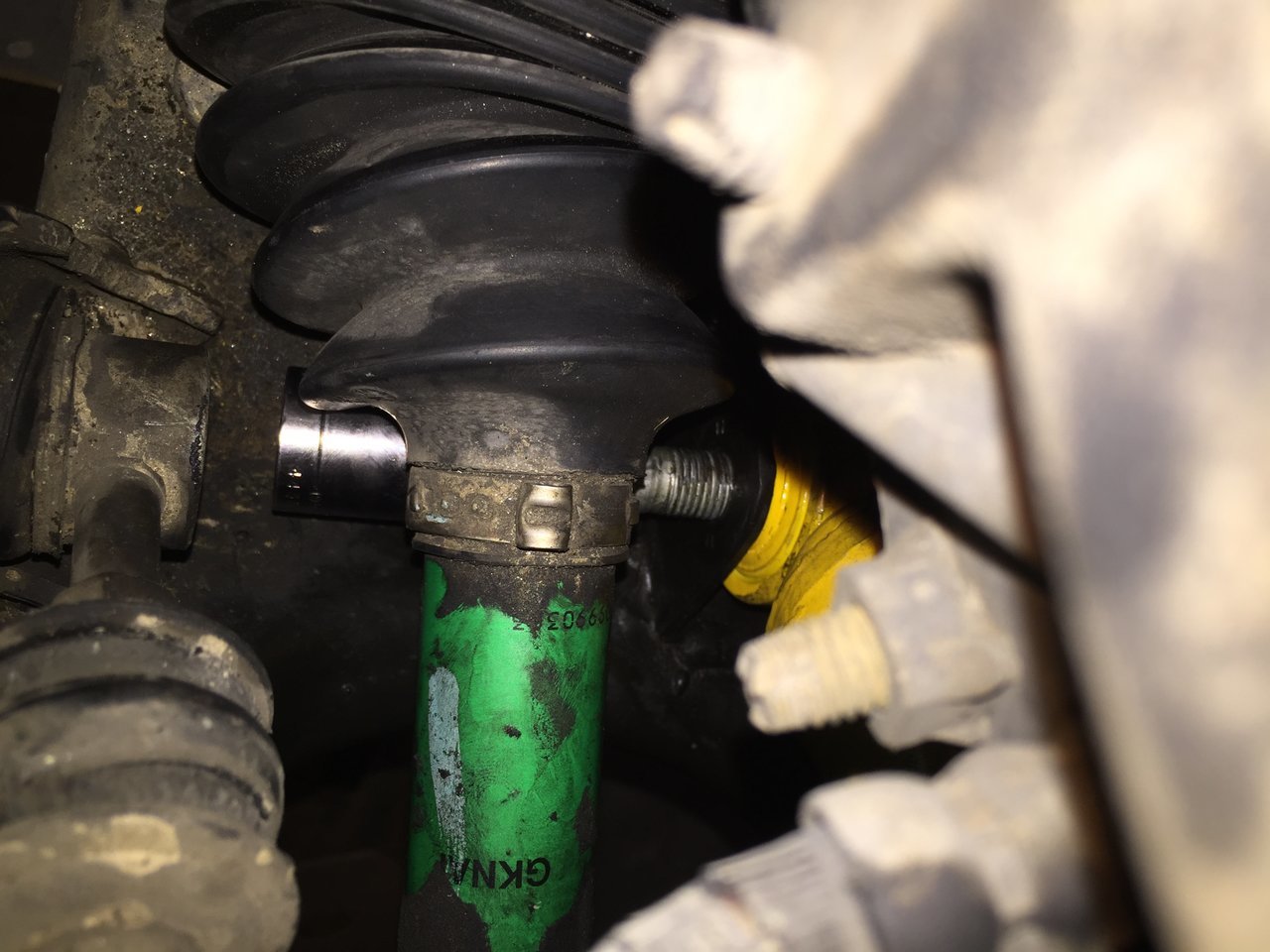

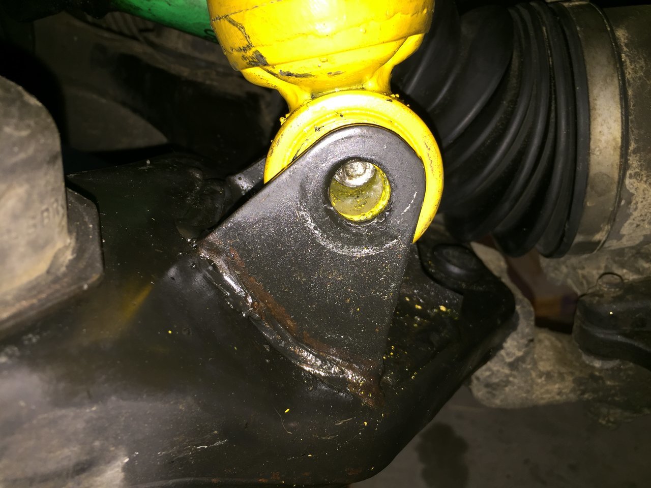

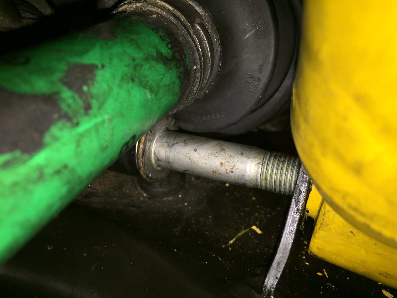

    Putting the 881's on a 1999 and I'm doing all i learned here about the bottle jack pushing the LCA down to line up the lower bolt...
    but it isn't lining up very nicely... it would seem the CV boot is getting in the way and putting the bolt at difficult angle to work with...
    I can't even figure a decent way to just hammer it home... any thoughts?

    So the bolt holes of the lower shock mount aren't exactly in line with the hole on the shock?
    If so, have someone twist the shock while you slide the bolt in.

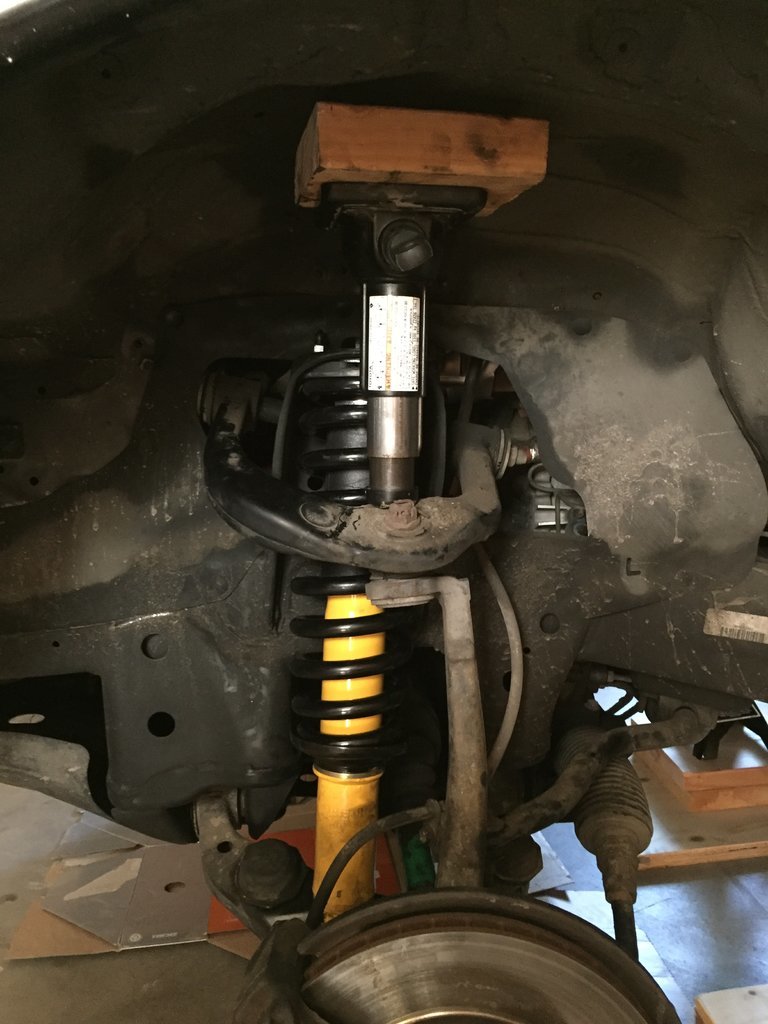

    The contraption was from info I found on this very thread, works okay...
    I thought about putting the bolt in the other way, definitely seems easier, I was only trying to put the bolt back in the way I found it, and I haven't come up with any reason not to... unless someone else has some reason not to I'll probably go that route, the cv boot is really screwing with me this way.

    I have done it by myself, but it's definitely easier with an extra set of hands. I used a long crow bar and wedged the end under a coil, and pushed down on the upper control arm. While I did that had a budy twist on the coilover and slide bolt in.

    Got the drivers side done all by me lonesome. (putting the bolt in the other way while rotating the strut around 'till it fit through was all too easy). One buddy available tomorrow. will hopefully finish up with remaining three struts and brake line then take the ol' girl for new shoes and alignment, maybe worry about the diff drop somewhere's in there later.
