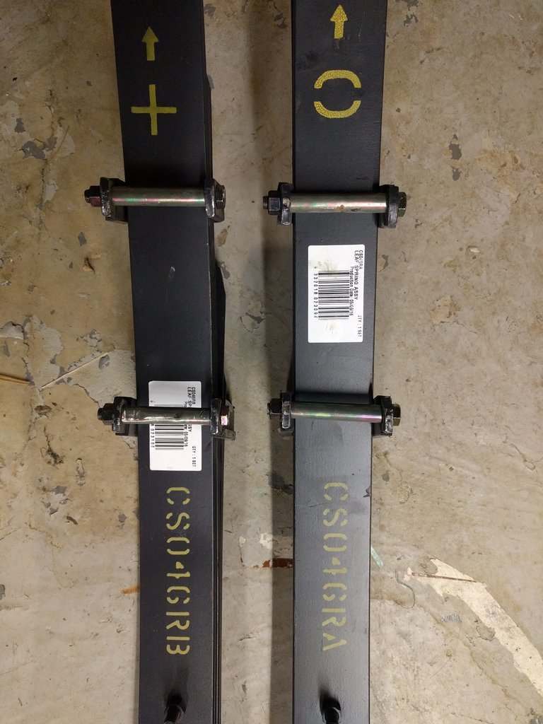

    Full OME kit was delivered today, can't wait to install this weekend! Will post pics here when finished...
    Looking at my Dakars, one is labeled CS046RA and one is labeled CS046RB. There is also a "+" sign on one and a "0" on the other. From everything I've gathered on the forums, "A" is for driver side and "B" is for passenger. The pack with "+" sign indicates slightly above spec and therefore should be installed on the heavier drivers side to combat lean, a "0" indicates on spec, and should be installed on the passenger side. The following link supports this: http://www.cruiseroutfitters.com/tech_OME_leaf_tech.html
    However, my "A" pack is marked with a "0", while my "B" pack is marked with a "+", which I think is the opposite of what it should be. Which pack should I put on which side, and does it even matter on our 1st gens?

    I believe + is for drivers side to compensate for lean

    A is drivers side, B is passenger side. + just means it's slightly over spec, O means it's at spec. You still want to install the A on the drivers side and your B on your passenger side.

    Thanks, I think you're right, letters take precedent over symbols. To test, I placed a straight piece of wood across the length of each spring pack, then measured the distance from floor to wood at the center pin. The "A" pack was about 3/8" inch higher. I'm assuming that will translate to slightly more lift.

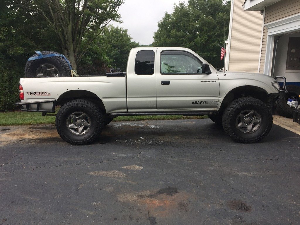

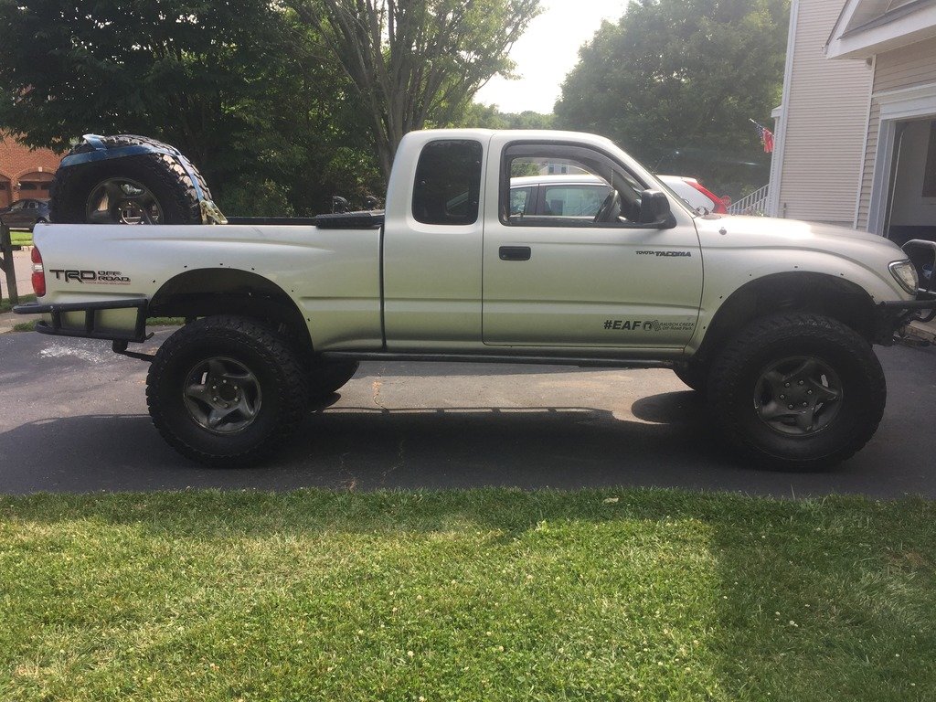

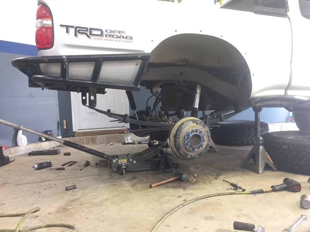

    Installed my Dakars yesterday. A couple questions... What is limiting everyones down travel? With these leaves and my lift shackles, with no shocks installed, I am getting so much droop that my extended brake line was tight and the drive shaft looked like it would pull out. Now with shocks on I am definitely in the clear, but that means at full droop the axle is being held by the shock. The leaves should droop fully before the shocks run out of travel right?
    Full setup is Daystar 1.25" lift shackles, All prop axle relocation plates, Dakars, and 9" travel 5125's.

    My OME shocks limit my down travel. Same boat as you, there is a lot of usable droop left unused.

    Yes, shock length would control droop. Otherwise, in flex, the stuffing of the tire on the other side would maybe limit. Some people have used straps if the shock has longer travel.

    I just feel like there is a ton of weight being held by the shock I guess. I mean my tires alone are 75 lbs a piece plus the weight of the springs/axles.

    It will definitely kill the shocks. I ruined one OME and one Rancho, both on the driver side.
    Your only solution is to do a shock relocate. :thumbsup:

    Definitely will happen, just not before Moab unfortunately. As long as I don't kill them before/during then I'll be happy. Also I am assuming now that I moved the axle back I would need different bump stop heights for each side to take advantage of full shock travel, depending on how far back the axle was adjusted?

    Even if you do blow it, you won't notice a ride difference until you take it off.
    @Squeaky Penguin and I are using Wheelers Superbumps and an added spacer to make contact. My spacer was about 1 1/2"
