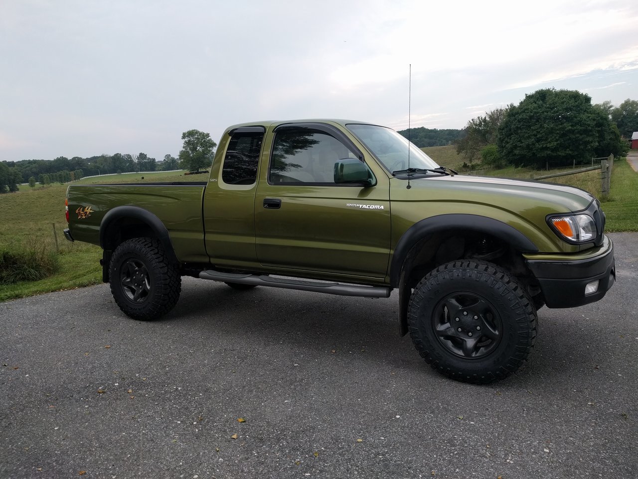

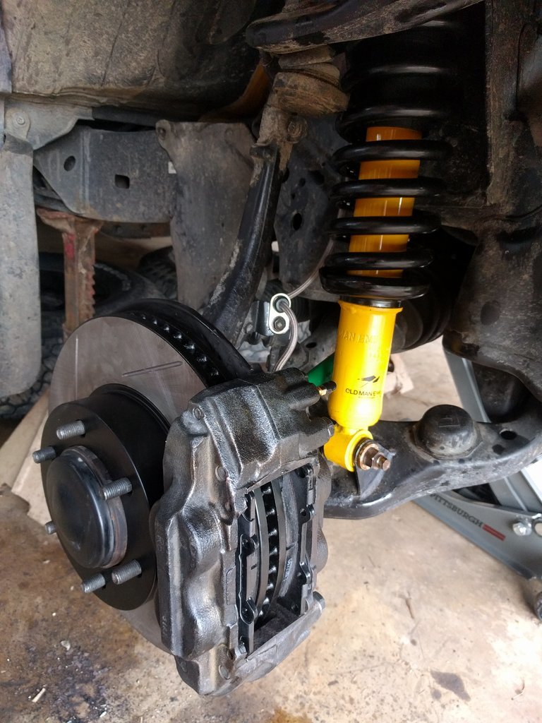

    Got the full OME install done by myself over a long, hot 3 day weekend along with the Tundra brake upgrade with stainless lines front & back. It wasn't easy, a few bolts were seized (F#@#% brake line & leaf eye bolts!), but I couldn't have done it without tips from this forum. Wouldn't have thought to use ratchet straps to get the axles in position, upside down bottle jack against the control arm to get struts in place, and many other techniques.
    One piece of advice that I'd like to pass along: Don't hesitate to break out the angle grinder on the leaf spring eye bolts. I wrestled with one for at least an hour using a breaker bar, impact wrench, obscene phrases, and buckets of sweat, to no avail. I had never used an angle grinder before, but it took me all of 5 minutes to hack the bolt in 2 places :facepalm:

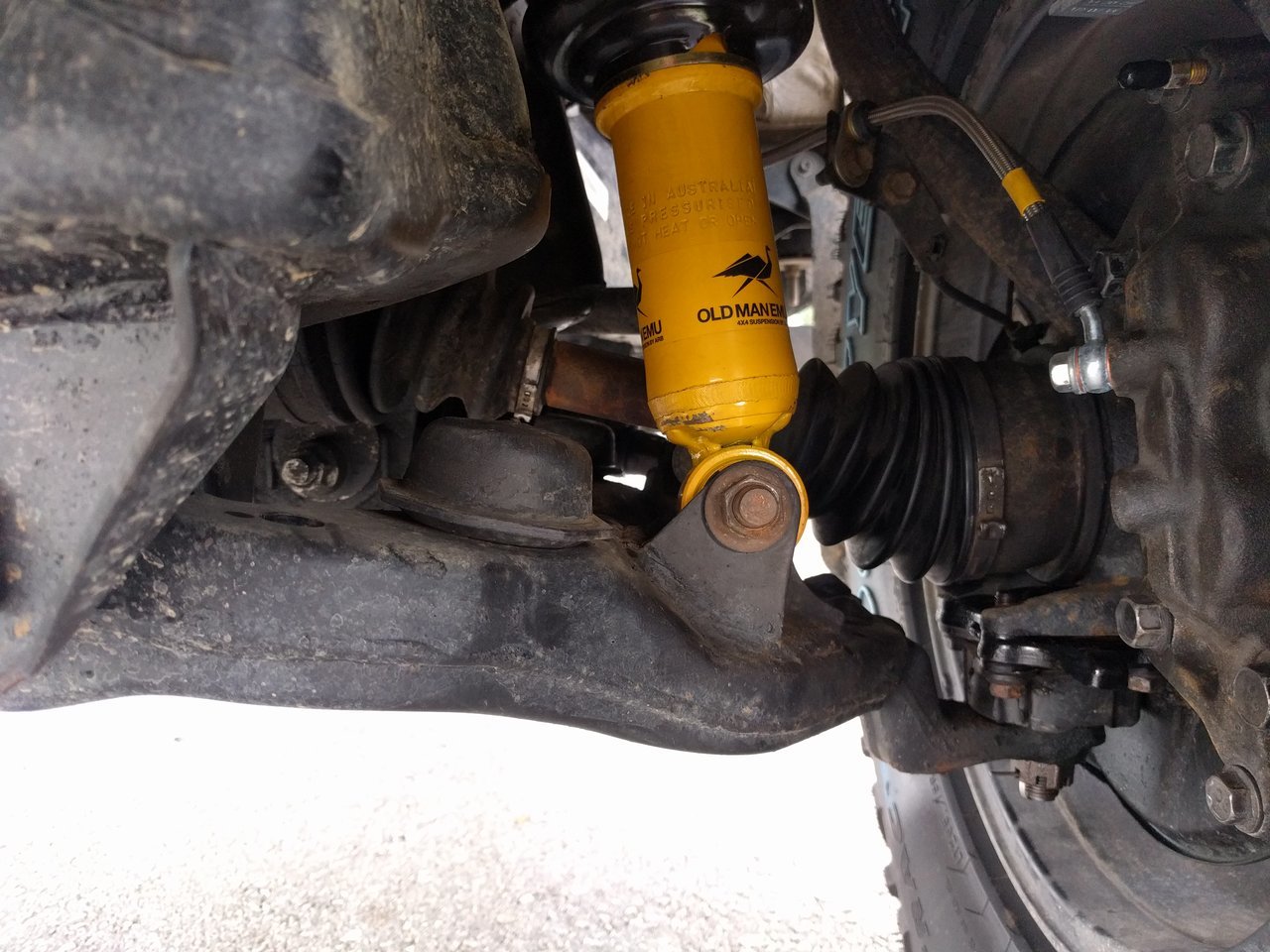

    Post install questions:
    My CV angles look pretty steep, do you guys think a diff drop (ordered) will be enough to give me some time or do I need to accelerate my bumper/winch shopping too?

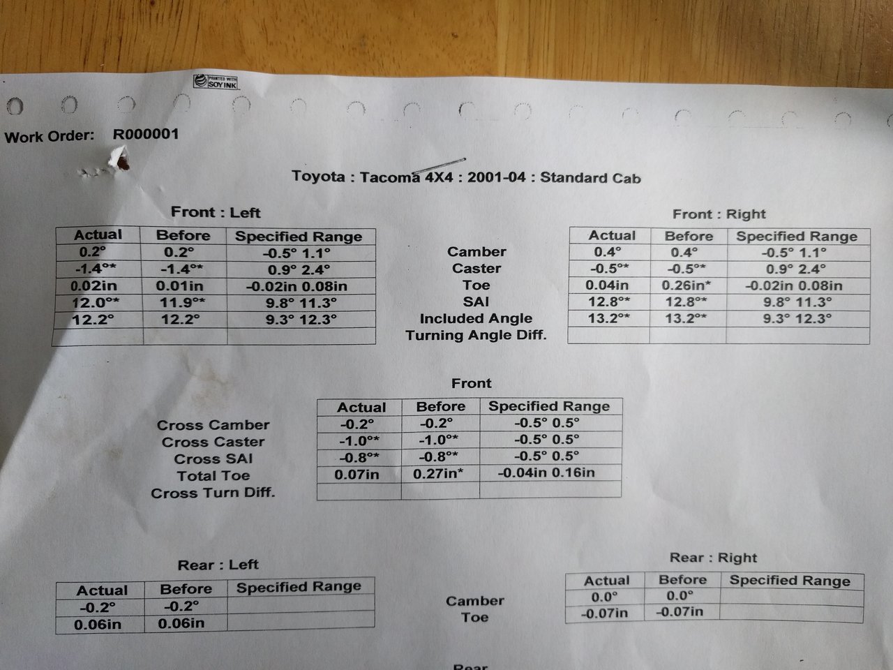

    After the install I took it to the dealer for the LBJ recall & alignment, but it looks like they only adjusted toe. Is it possible that even with the lift & bigger tires that the alignment was mostly ok, even with stock UCA's?
    Thanks in advance!

    Whoa man, that color is freaking sick!
    jmaack likes this.

    Those alignent specs are piss-poor. They ought to be ashamed of themselve for taking it off the rack with those numbers. Negative caster? Really? I'll bet it has bumpsteer on the highway.
    You want 0* camber, 0* toe and 2.5* + of caster. But without aftermarket UCAs you will be lucky to see 1.5* of caster.
    * = degrees
    Love the color of your truck btw.

    What Tundra brakes did you use in your upgrade? It will be good to know since a lot of people wonder whether or not they will work with the stock 16" alloys. Good work man!

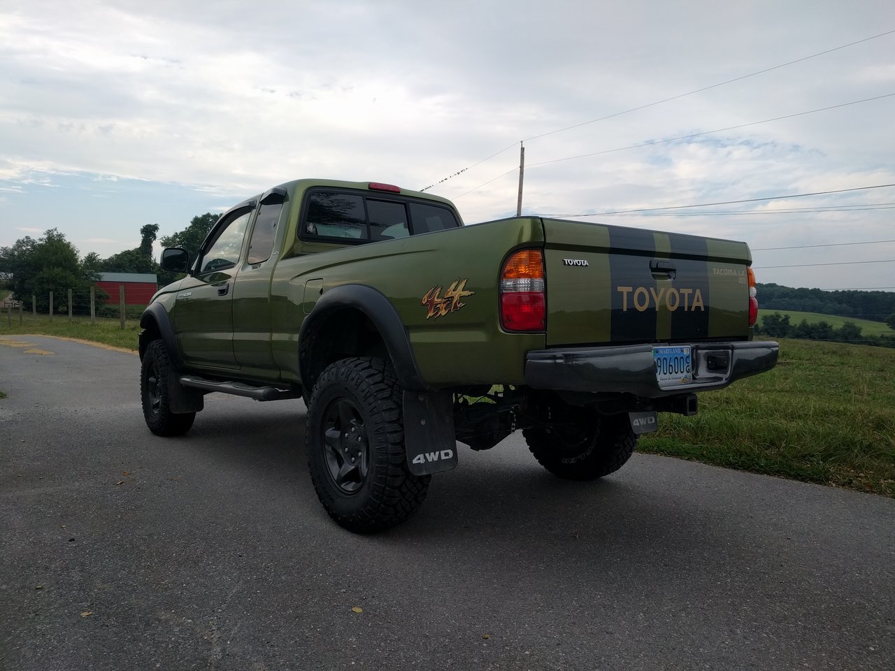

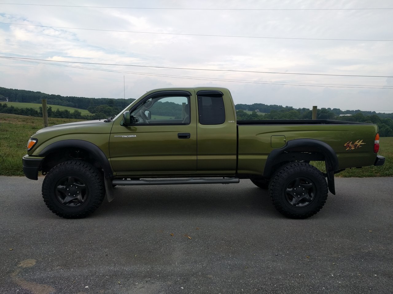

    Thanks fellas, looks like everyone likes the Rescue Green!
    Brakes: I sourced 13WL calipers from a junkyard 2007 Sequoia, and rebuilt them with the Carlson repair kits, Centric pins, & Russell speed bleeders. Rotors are StopTech PowerSlots. Pads are Akebono. Everything fit nicely in the stock 16's with a little trimming & bending of the dust shields.
    For the alignment, I guess they didn't want to bother fixing what the lift threw out of whack, I guess the toe is the only thing affected by replacing the lbj's? I mean, they didn't get any money out of me, and they also replaced the spare tire lift assembly, so I guess I should be happy with what I got, but I'm still gonna call them and ask about the specs. Not sure about bumpsteer, I didn't want to drive it too much or too fast before I install the diff drop. I'm worried about the CV boots.

    Oh like said really liking the color never seen it before on any truck
