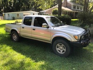

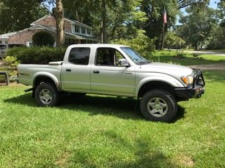

    Just put on my OME 883/ Dakar lift today! It rides so much better and the axle wrap from the worn out rear leaf springs is gone! It sit pretty much level and raised the truck quite a bit!IMG_1104.jpg IMG_1105.jpgThanks goes out to Cruiser Outfitters and Dbenke from the Low Country Land Cruisers for his much needed help!!
