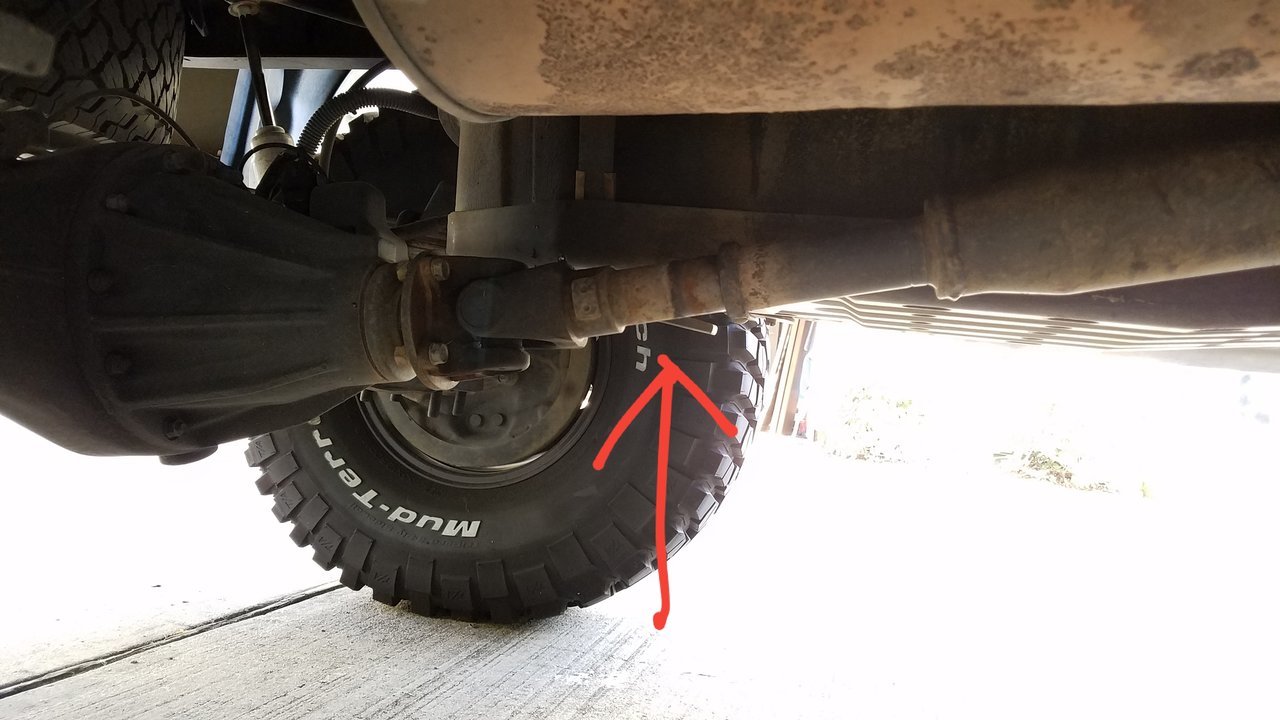

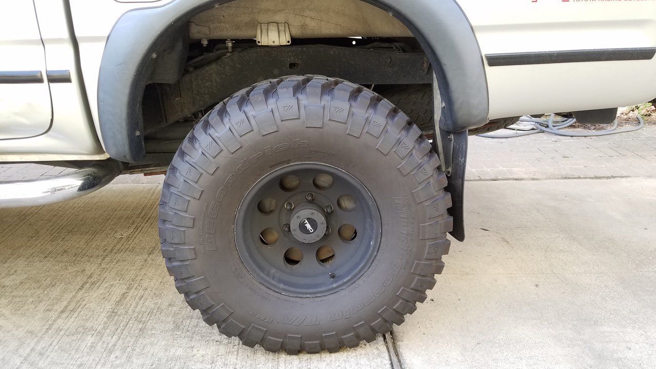

    I am about to install the full OME kit. I made the mistake of lifting with blocks and no diff drop and blew 2 inner boots. I also just noticed that my rear axel seems to be further back towards the rear of the truck. Is this normal after a lift? Or should it be centered with the fender? The gap between the tire and the fender towards the front of the truck is bigger than the back gap. The shaft looks like a slipped a couple of inches as well. Im a newbie to trucks. So when I installed the block lift myself I never thought to consider axel movement. Can i please get some knowledge dropped on me before i delve into the OME install? Thanks TW
  9. Oct 12, 2017 at 8:08 AM
    #3289
    BlackPearl
    BlackPearl Well-Known Member
    Apr 17, 2017
    #216527
    1,361
    Alex
    Toyota Tacoma TRD
    3” lift. Sway a ways 2.5 on 285 75 16 and much more
    I believe you need an axle relocation bracket. Seems to be a common problem with tacoma lifts. Here is link to one:
    allprooffroad.com/shop/axle-relocation-plates/

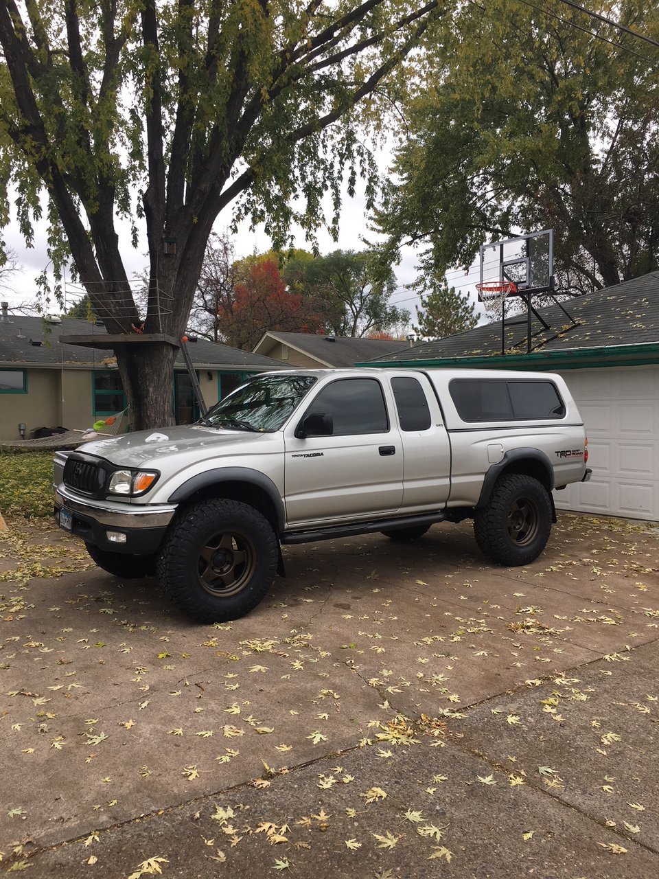

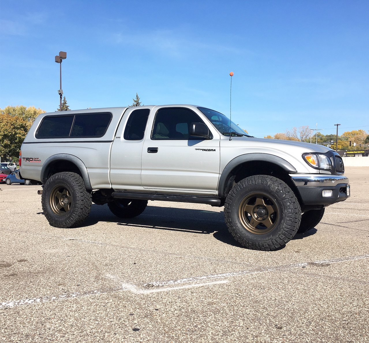

    just something I have laying around that runs
    Heres my recent install
    before/after:
  13. Oct 23, 2017 at 7:00 PM
    #3293
    Adude
    Adude Well-Known Member
    Jan 5, 2017
    #206699
    1,232
    Pnw
    04 Double cab
    Looks great, but why did you ditch the steelys
  14. Oct 24, 2017 at 5:53 PM
    #3294
    Dr. Dill
    Dr. Dill Member
    Sep 28, 2015
    #165382
    11
    Dill
    01 TRD
    I wanted a slightly wider wheel and wanted to save a little weight. The new tires are 285/75/r17 (34") and with that size I knew they'd be significantly heavier then the 31" KO2's. I have also really admired the look of the SCS F5 wheels.

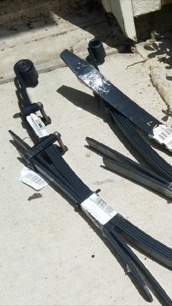

    Hey everybody first I want to thank everyone for all their helpful info throughout this thread.
    I'm in the process of putting this lift together for my 04 tacoma but I'm gonna use some some takoff oem springs to save a few bucks( hi mileage truck). Also installing wheelers add a leaf. However the springs appear to be slightly different and I was hoping someone on here could help me figure which side is left/right. Thanks in advance
  16. Oct 25, 2017 at 12:24 PM
    #3296
    Adude
    Jan 5, 2017
    #206699
    1,232
    Pnw
    04 Double cab
    When I was digging up info on springs, I called a few dealers to get the spring rate and height. They couldnt tell me anything but they are the same part number, and no different side to side.
