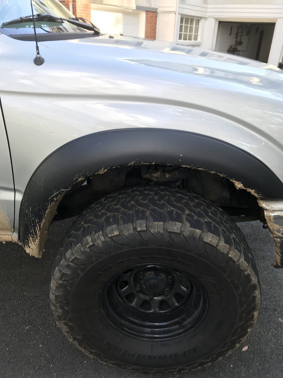

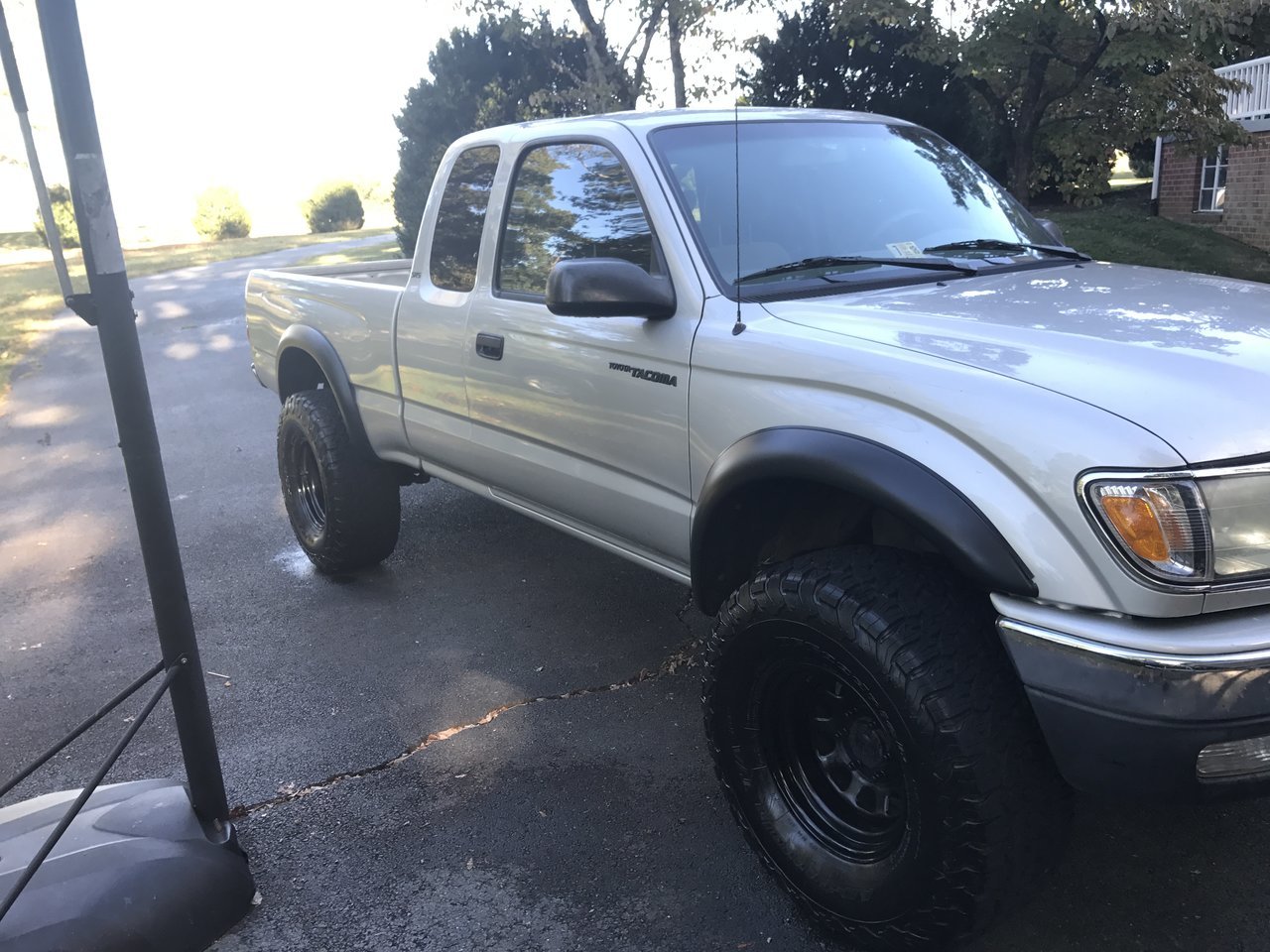

    Wasn’t sure where to ask this so I guess I’ll just put it here. How do you guys get accurate hub to fender measurements? Maybe it’s just me, but it’s a pain because my tire has some bulge as in it sticks quite a bit out from the hub and also from the fender. It’s a 33x12.50 on a 15x8 wheel. Here’s a couple of pics as well. 04BD6C2C-AD54-47DB-9628-F28F1D71A647.jpg3F126461-73E1-4854-94B6-D5D95BE700E6.jpg

    Eyeball it or use a little torpedo level

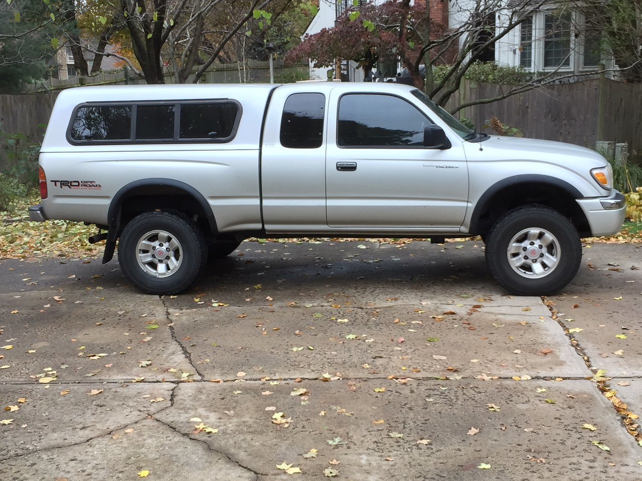

    Got my 881's installed, 5100 on bottom setting. Gained a little over 3/4 inch, over the stock springs on the middle setting. I've got about 3/4in. of rake front to back, with my 1.5 aal.
    jjsul, m3bassman and boostedka like this.

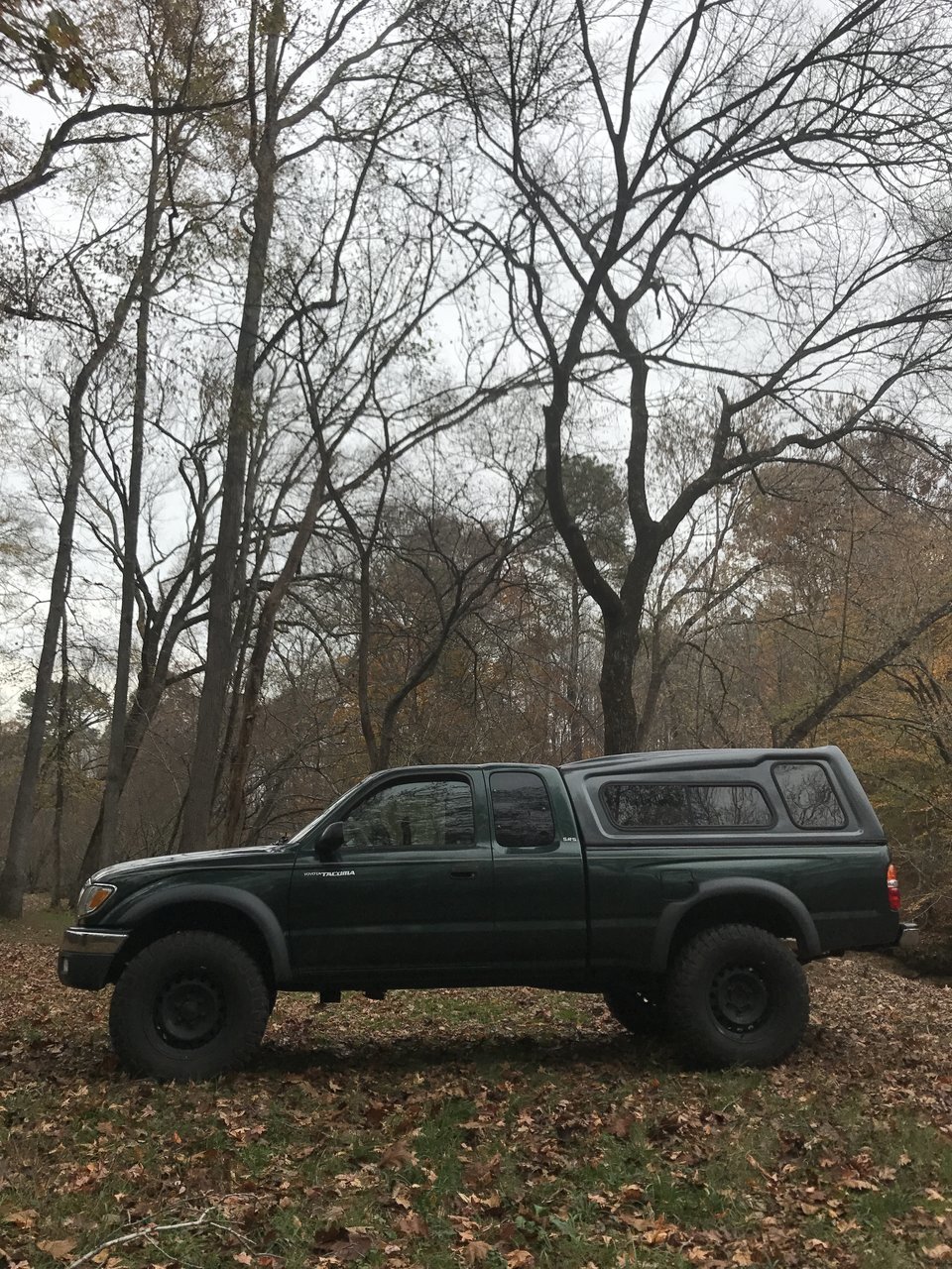

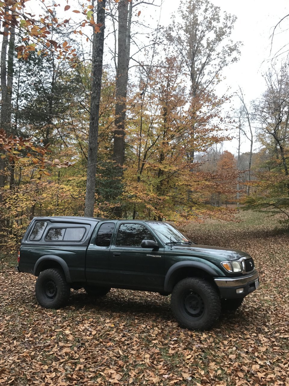

    Recently installed ome 881 with 5100's and aal in the rear. Overall really happy with the ride quality.
    Forgive the poser shots I was just putting around nearby

    What size tires? Looks good, I like the stock steel wheels.
