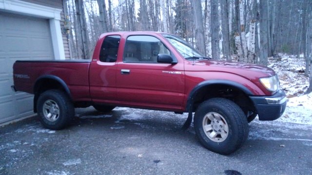

    99 Tacoma under construction
    Now that I've got my 99 done I can finally whore it out in this thread. I used OME 881's in front and Dakar rear springs. There's about 200 lbs of sand bags in the back.
    JKU3000, Deathbysnusnu, Adude and 3 others like this.

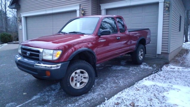

    Kyle
    Northern IL
    2015 Tacoma
    I have a recent poser shot too. Hopefully I’ll have a cooler one soon:luvya:
  16. Nov 27, 2017 at 2:02 PM
    #3336
    Angler
    Angler Well-Known Member
    Dec 29, 2014
    #145192
    47
    Ontario
    2017 TRD OR
    What's the setup and tire size? Looookin goooood
  17. Nov 28, 2017 at 7:28 AM
    #3337
    labrador01
    labrador01 Well-Known Member
    May 29, 2016
    #188186
    305
    Kyle
    Northern IL
    2015 Tacoma
    thanks. ome 883 coils, dakars + aal, ome shackles & nitrochargers. tires are 285s general x3. was hoping to purchase a bumper over black friday with a check that I got due to a shingle lift falling over and scuffing my truck, but this is my 3rd wk on strike @ work. no telling what is going to happen.
