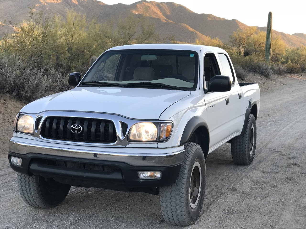

    I’m baffled at much of this. I realize everyone’s situation and experience seems to
    differ slightly but nonetheless I am looking for input. It’s my DD and I do some minor off roading/hunting on the weekends. Nothing crazy.
    I have a 2002 4x4 DC V6. The suspension is stock besides 5100s up front at highest setting and 4600 on the rear. My stock rear leafs look good and as of now it sits pretty level but the ride seems a little stiff.
    I’m looking for a better ride, maybe a tad bit higher all around but as long as I can stay level with rear. Ideally I’d like to go as high as possible without having to do brake lines or cv’s. I already have the poor mans level with the 5100s set high but I’m looking to go a little further and get a better ride.
    It’s a lot to ask but any suggestions are greatly appreciated. Thanks fellas.

    Going higher can be a slippery slope and expensive. What is your hub center to bottom of the flare measurements on the 4 corners now?

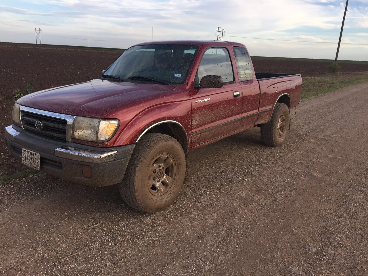

    E8EA372B-C1D9-4D99-B53C-90725C2BA596.jpg Ok can someone here please help a guy out. I have a 98 4x4 running on 5100 all around with stock coils up front. My leafs are SHOT and I want to replace them ASAP. Can anyone just give me advice as to what I need to replace my leafs with to have as little lift as possible so I can still be leveled using the highest setting on the front 5100?
    Like Dakar’s, Denver’s or another brand?
    Again I’m not looking for hella lift, just the max I can get using the 5100. Thanks guys

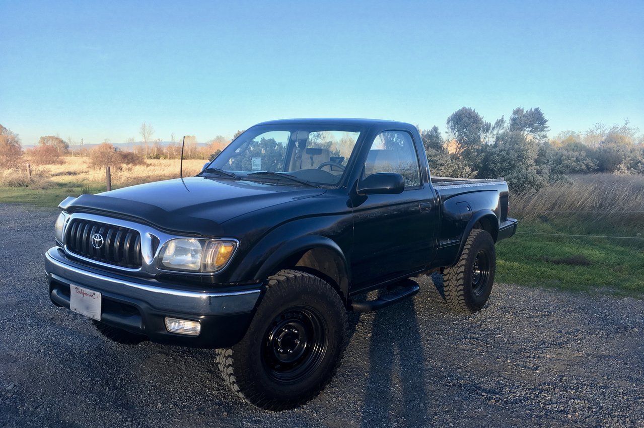

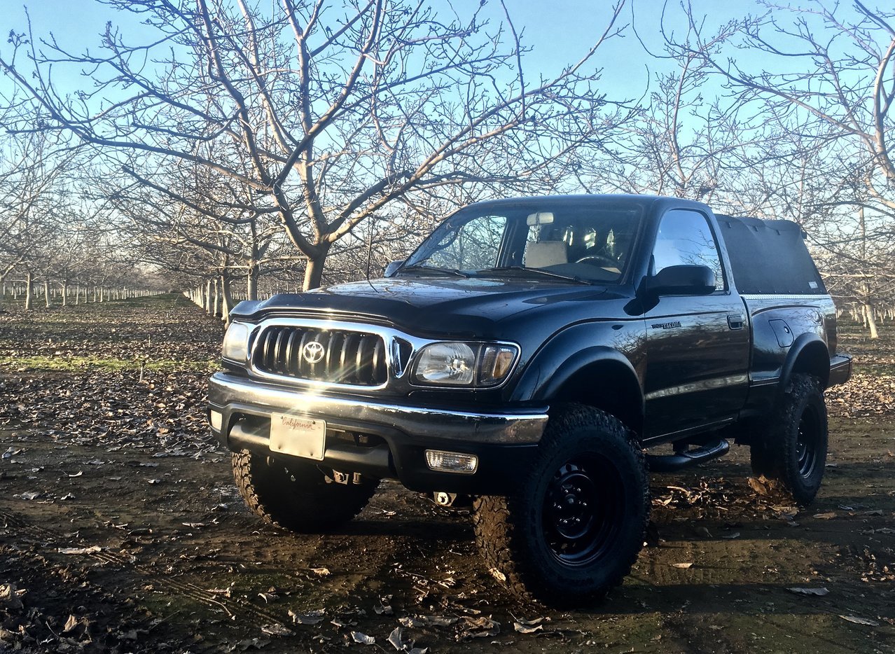

    880s front and full pack -3rd leaf rear.... gained about 1 1/2" up front and 2" rear, but note i have a Reg Cab 4cyl and this is before the new parts have settled... so you 6cyl XC and DC guys would get even less lift with this set up... Hope this helps
    Before :
    After :fullsizeoutput_17c1.jpg
