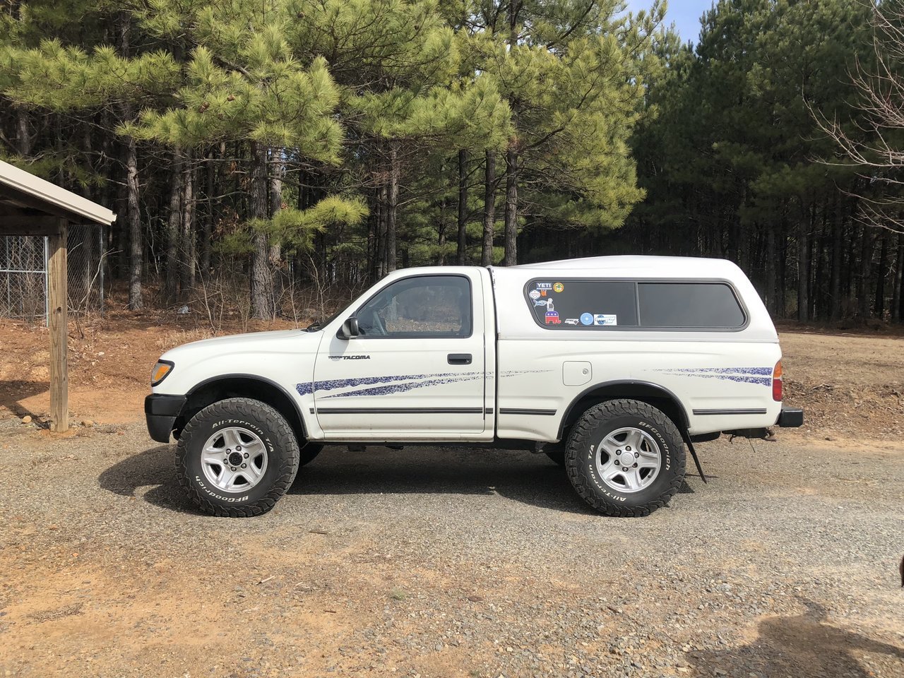

    880 with 1/2” top plate spacer, dakar leaf pack, nitrochargers on all corners.

    Thanks. I was originally going to go with 881’s but wheelers off-road advised I go with 880’s since I don’t have any additional weight up front. They said it would be pretty stiff up front.

    I’ll probably get an ARB bumper eventually but it’ll be a while. If it’s too much weight after that then I’ll just swap to 881’s.

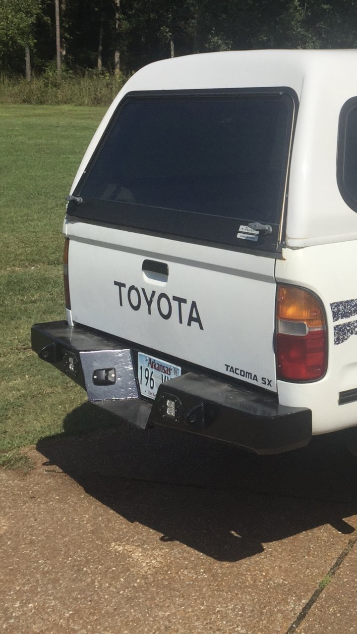

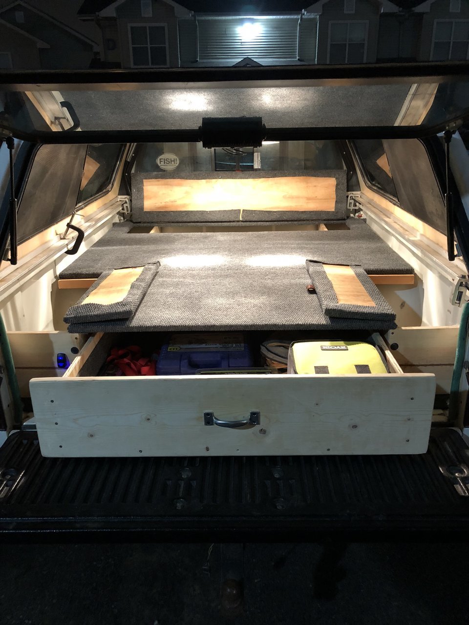

    You might try without the add a leaf first and then go from there. I thought I needed it as well but wheelers off-road advised against it. I have a camper shell, wooden sleeping platform with slide out drawer and tools, and a steel plate bumper on the rear and I’m glad I didn’t get the AAL. Now my suspension is new and hasn’t settled but the AAL would’ve put me way too high in the rear. And I can barely make the rear suspension bounce jumping up and down on the bumper. Just my initial thoughts after installing my setup this weekend.

    Thanks. Tires are 265/75/16. Really wanted 235/85/16 but found these cheap on Craigslist. Here are my measurements before and after install
    Before: driver front 37” pass front: 36 7/8”
    driver rear 35 5/16” pass rear 35 1/2”
    After: driver front 39 1/4” pass front 39 1/4”
    driver rear 39 5/8” pass rear 39 7/8”
    So looks like about 2.25” in the front and a little over 4” in the rear. But my stock suspension was completely shot. You can see that the rear sat 1.5” lower than the front initially.
