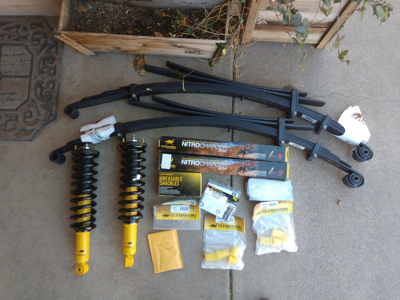

  15. Feb 20, 2018 at 1:42 PM
    #3435
    tymeson
    tymeson Let's ride
    Jun 25, 2017
    #222342
    2,918
    Steven
    In the desert
    03 Gold Prerunner
    The rest came in the mail today, I didn't ask for assembly but got it anyways thanks @HeadStrong Off-Road :)
    I wanted to paint them red but I don't want to disassemble them, I feel like I should just slap em on rn :D IMG_20180220_143652521~2.jpg
