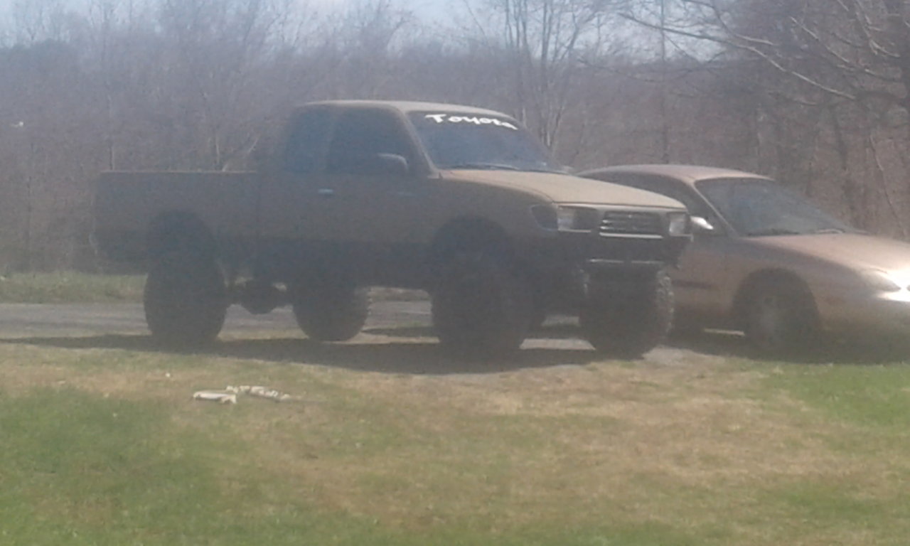

    20180302_123441.jpg OME heavy duty suspension kit

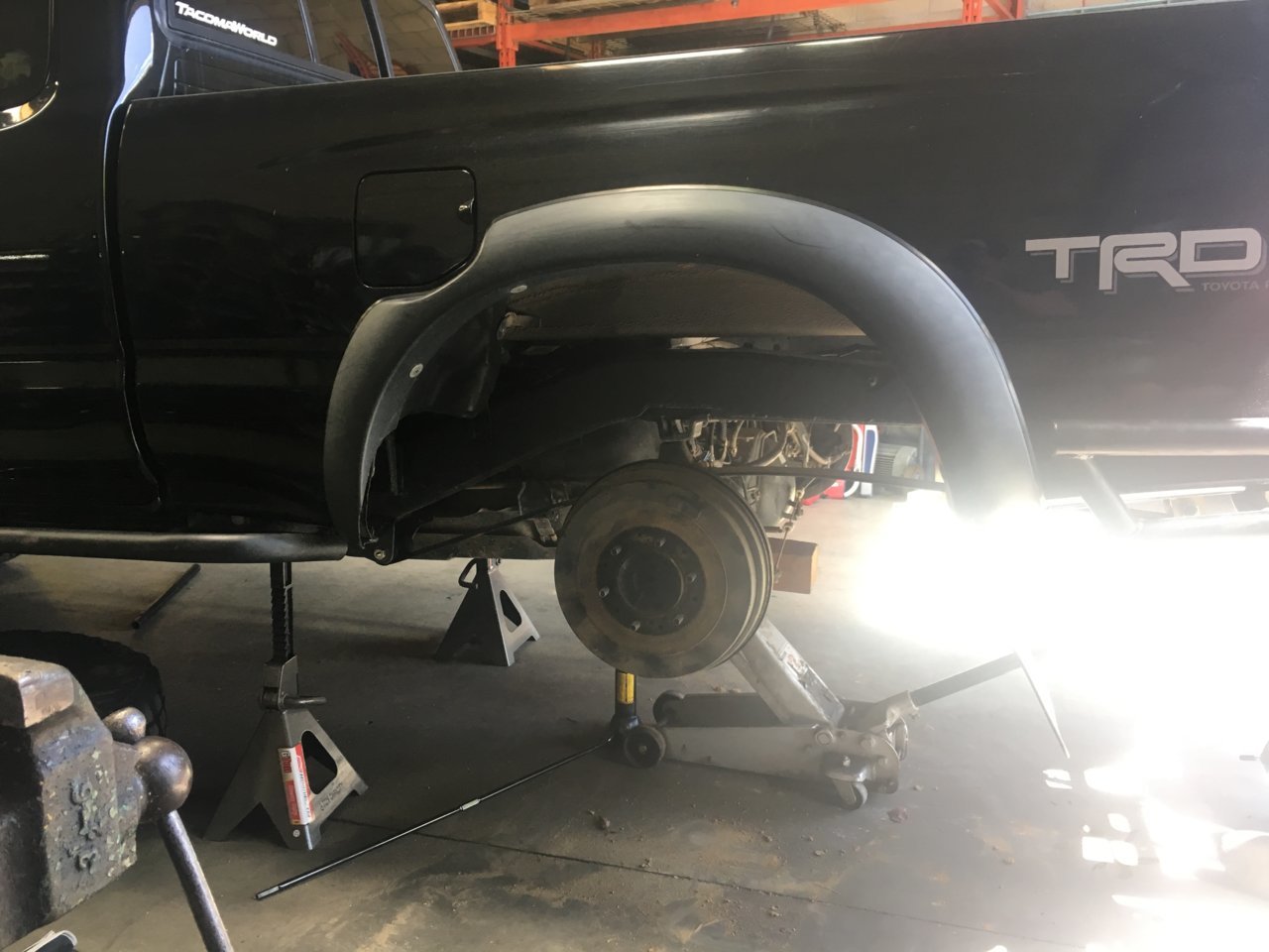

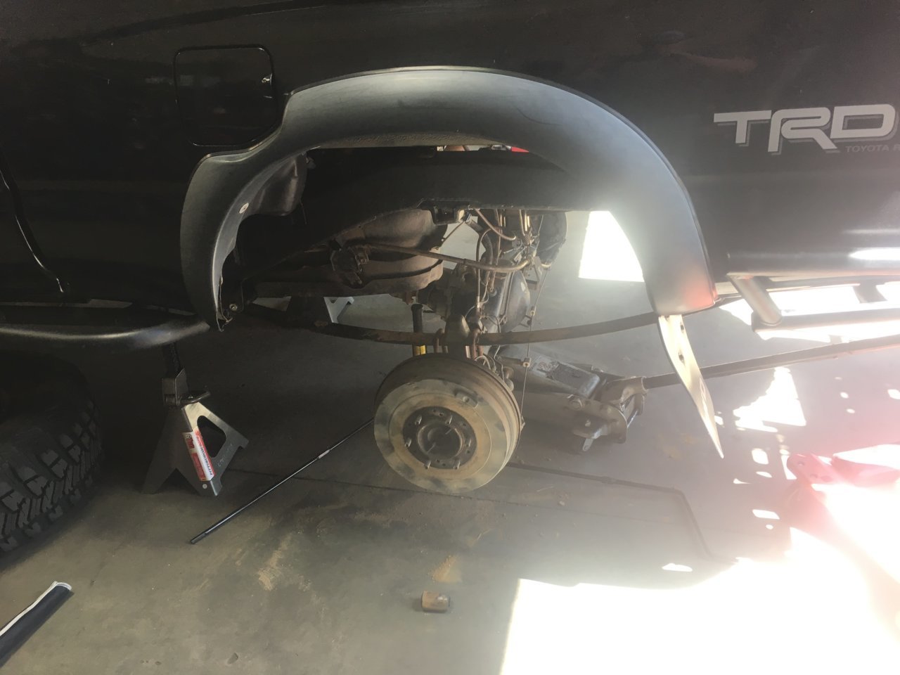

    883s up front and aal in the back. Far superior to the stock TRD suspension. People on this site definitely overhype that the 883s are too stiff. Haha 20180403_194759.jpg 20180317_084326.jpg
