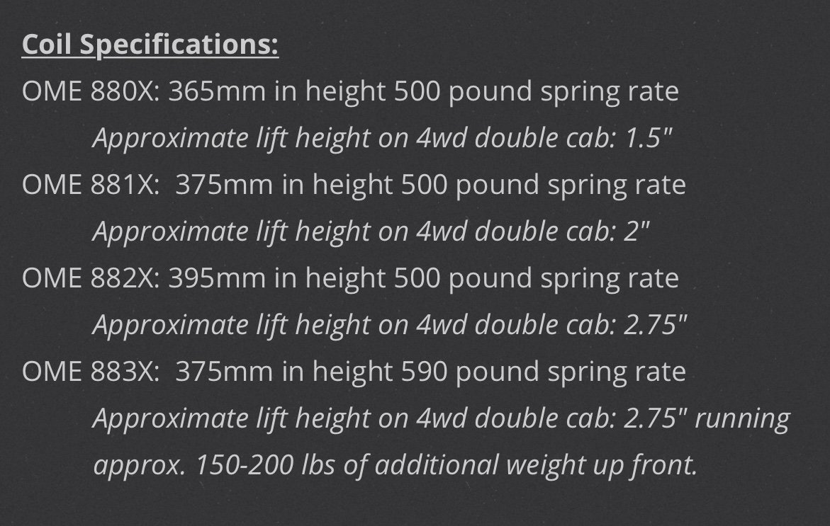

    All those springs aren't suited to 1st gens bud. You need 880, 881, 882, and at the max 883.
    880 = 0"-1.5 lift on V6
    881 = 2.5" if lift on V6 (500lbs)
    882 = same spring rate as 881 but 20mm taller allowing for more weight but similar ride. V6 only.
    883= same ride height as 881 just stiffer spring (590 lbs). Different approach to added weight. V6 only.
    Area51Runner likes this.

    Yes I know the rates and key word FREE spring length of all the 1st and 2nd gen OME springs. Along with what they are advertised to fit, I currently have 882s on my v6 double cab truck. After I add what I Fab up on the truck. I am going to run a spring with a higher rate and 5mm "887" longer to achieve the setup I'm after.

    I just feel like we need to post to spring rates every few pages on this thread, so other people can get info and we can stick to the important things like: what did you fab up I wana seeeee

    Can a coil be shortened by cutting some material off one or both the ends?I wanna make my 882's a little shorter cus I don't got the weight up front....
