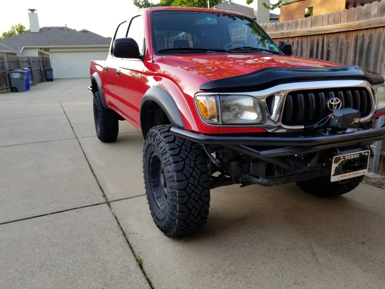

    2010 DCLB

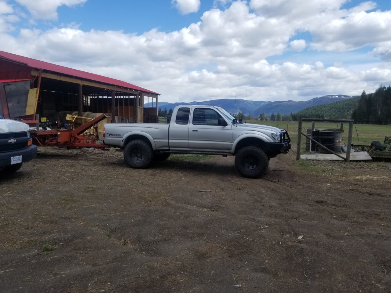

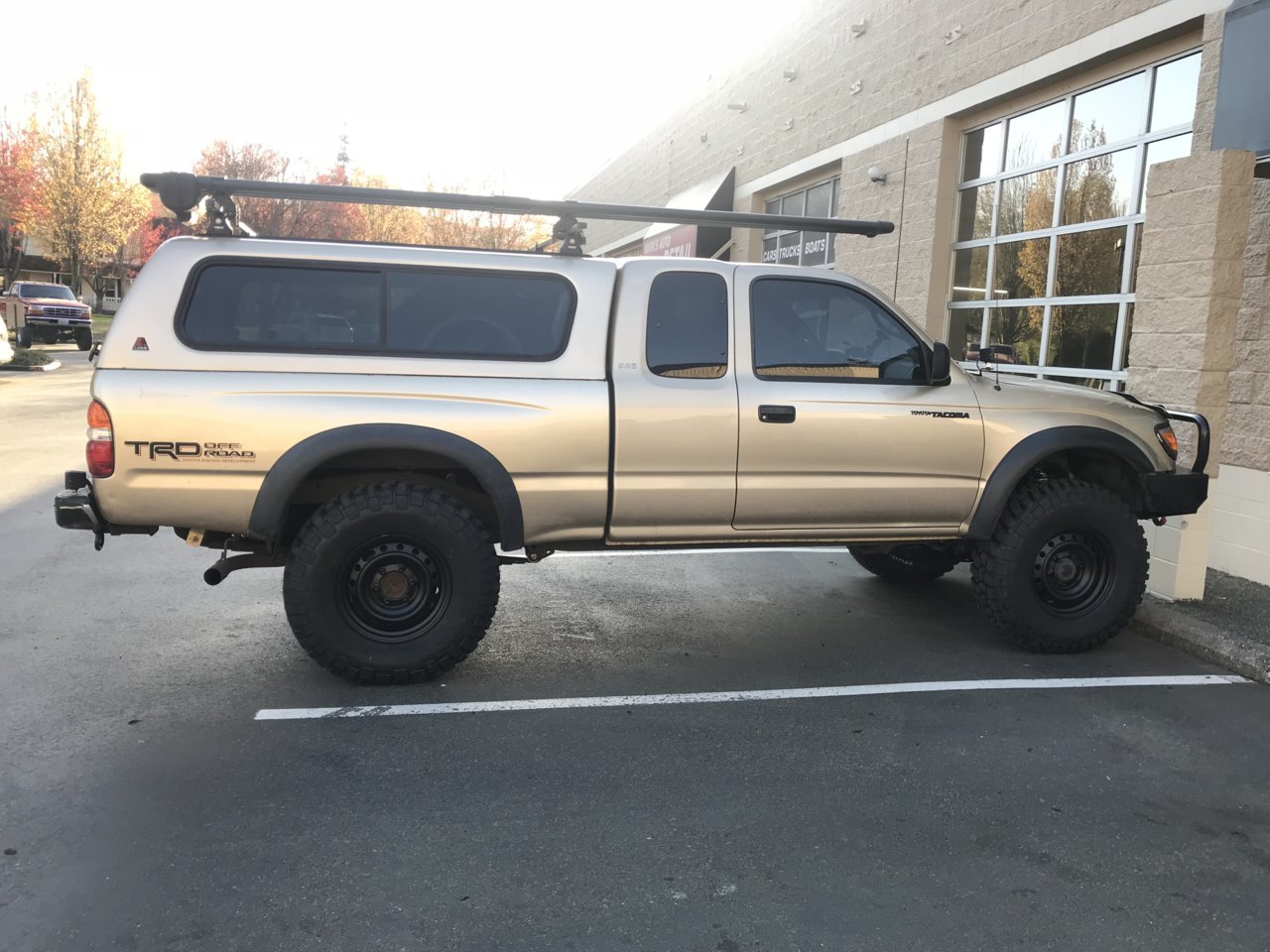

    They are a 7-leaf pack. They are SOFT for springs. Even with the AAL they cap out at around the same weight as the payload . So with 3" of lift they compress more than OEM.
    Here is mine with a Bale wagon hooked up. No idea on weight. Maybe 800-1000lbs tongue weight.

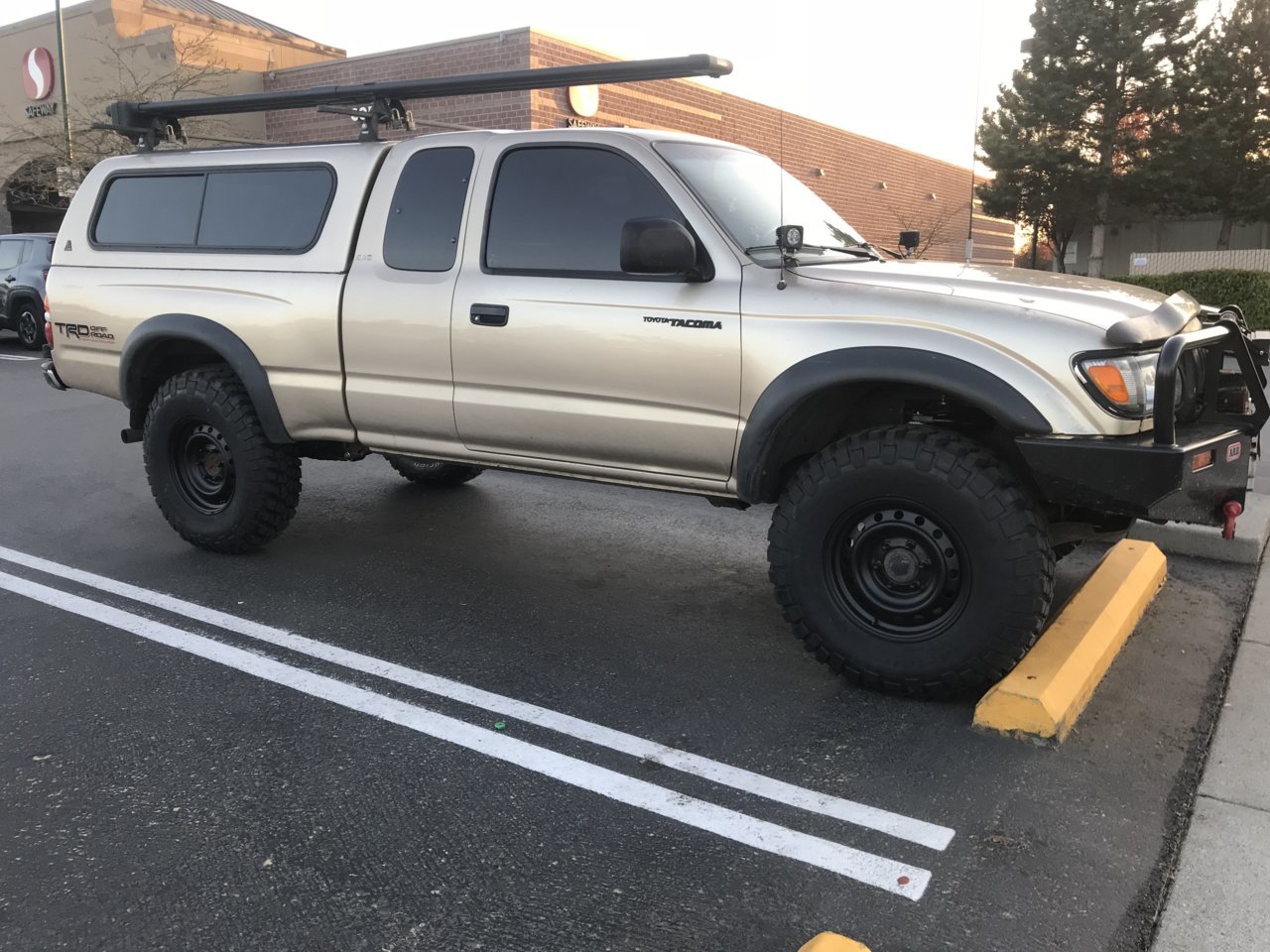

    I have the OME extended exhaust hanger but it looks like I'll end up cutting anyways :sawzall:Had to cut the driver side hanger bolt but everything else went relatively smoothly..

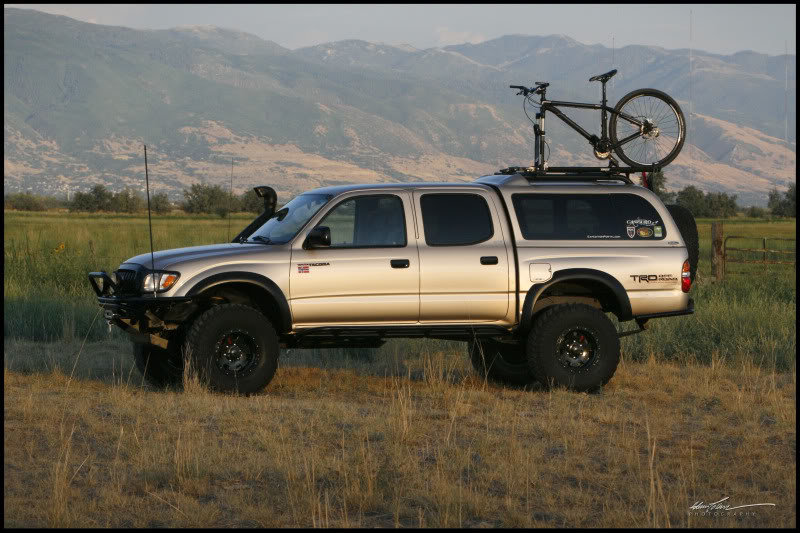

    Nice truck! What rear bumper are you running and do you have any better pics of it? Thanks!

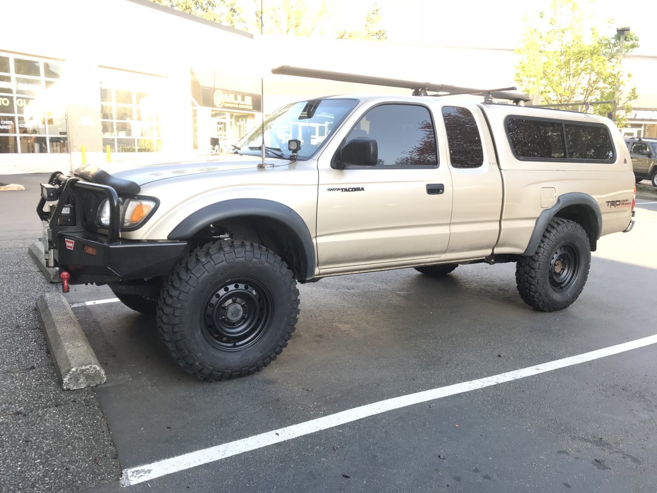

    This is the main reason why I went with the AAL lol

    I also went with the AAL because I have a camper shell on that almost never comes off. Along with a full size spare (in the bed) along with a kennel and whatever gear I have at that time. I still have rake lol

    It's a CBI Outback rear bumper.. I'll try to get pics later today...

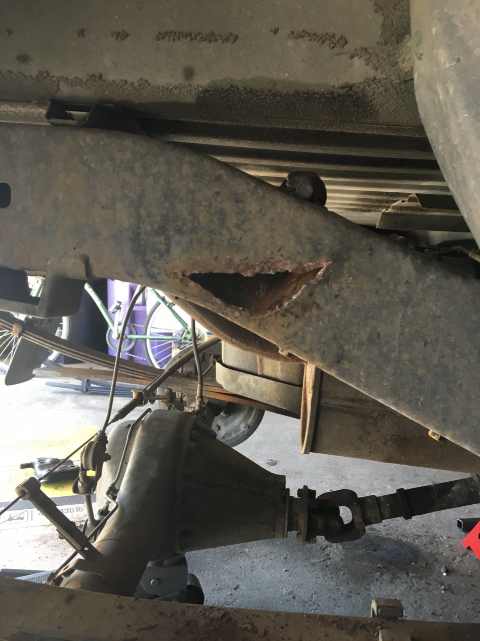

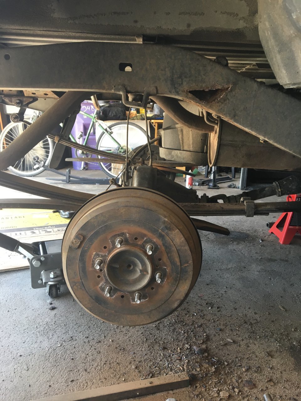

    Started on the back, everything came out easy enough, but I'm waiting on a coworker (he has a grinder) so we can cut out the front leaf spring bolts. However, I found some rust on the passenger side of the frame that didn't look too good, so after taking a hammer to it, my frame has a nice new hole:
    How would you attack this? I'm gonna reach out to another friend who has a MIG welder, maybe we can fix this on the cheap? My mechanic recommended a body/frame shop as well, waiting on a call back from them.

    I was referred to a local welder for mine to clean out all of the rust, weld new steel and put a coating onto it. Not particularly a body shop, they may end up charging you a bit. Not sure how much you are looking to spend in regards to "cheap" depends how much more damage there is to the frame. Mine was pretty bad lol

    That area of the frame also flexes. In fact, there have been instances where the frame has actually bent/deformed in the same spots where your rust holes are.
    Not sure about the underside repairs, but several companies make frame reinforcement plates for the frame sides in that area. They are of course weld-on plates. Might want to consider using a set of those as part of your repairs.

    That's exactly what I'm thinking. The driver's side looks perfect because the shock mount is rear of the axle, for whatever reason that pocket didn't collect any dirt. This side was full of crap, dropped through as I punched it out. The frame does look a bit deformed right at the top corner of that hole, to be honest might be a slight bend.
    I think I'll spray some rust inhibitor to stop it, talk to some friends with welding capabilities, and order the frame plates. But first, I'm gonna finish my OME install

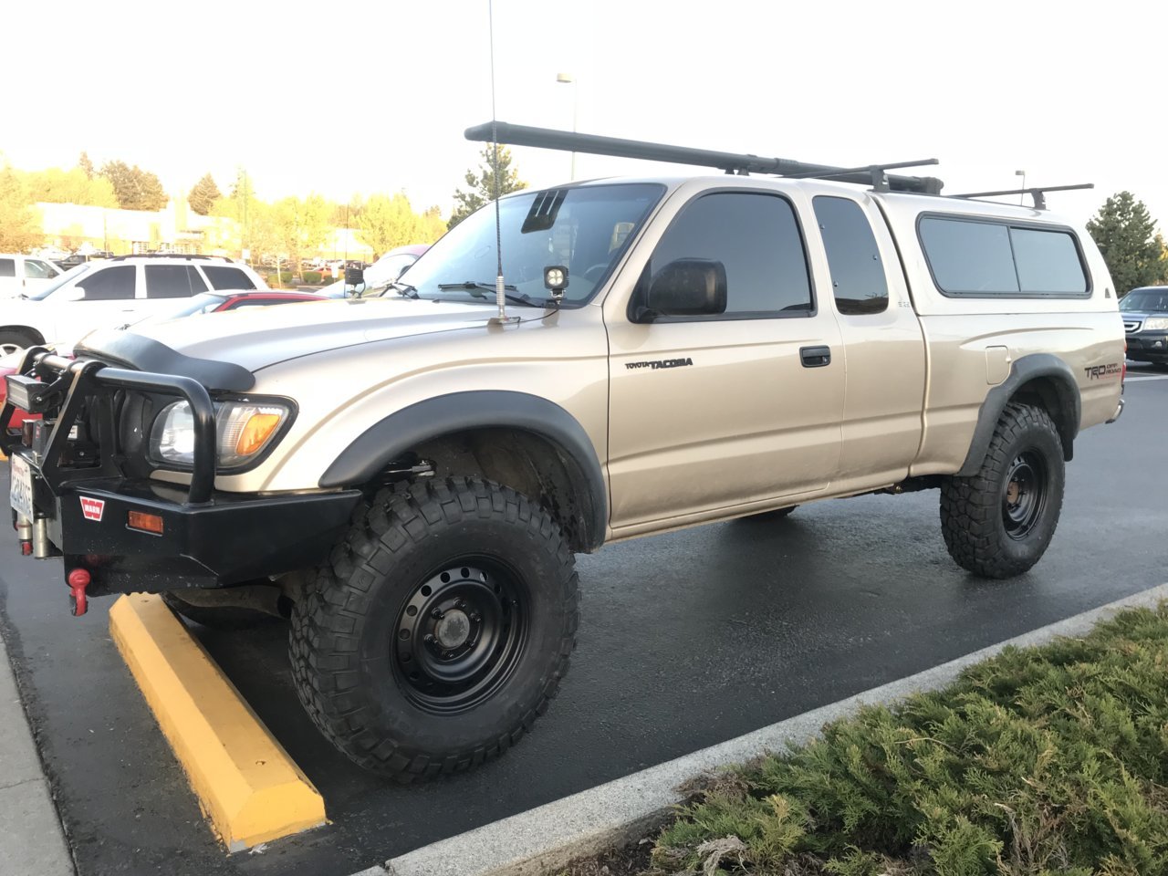

    I really want to see your cv angles when you get a chance

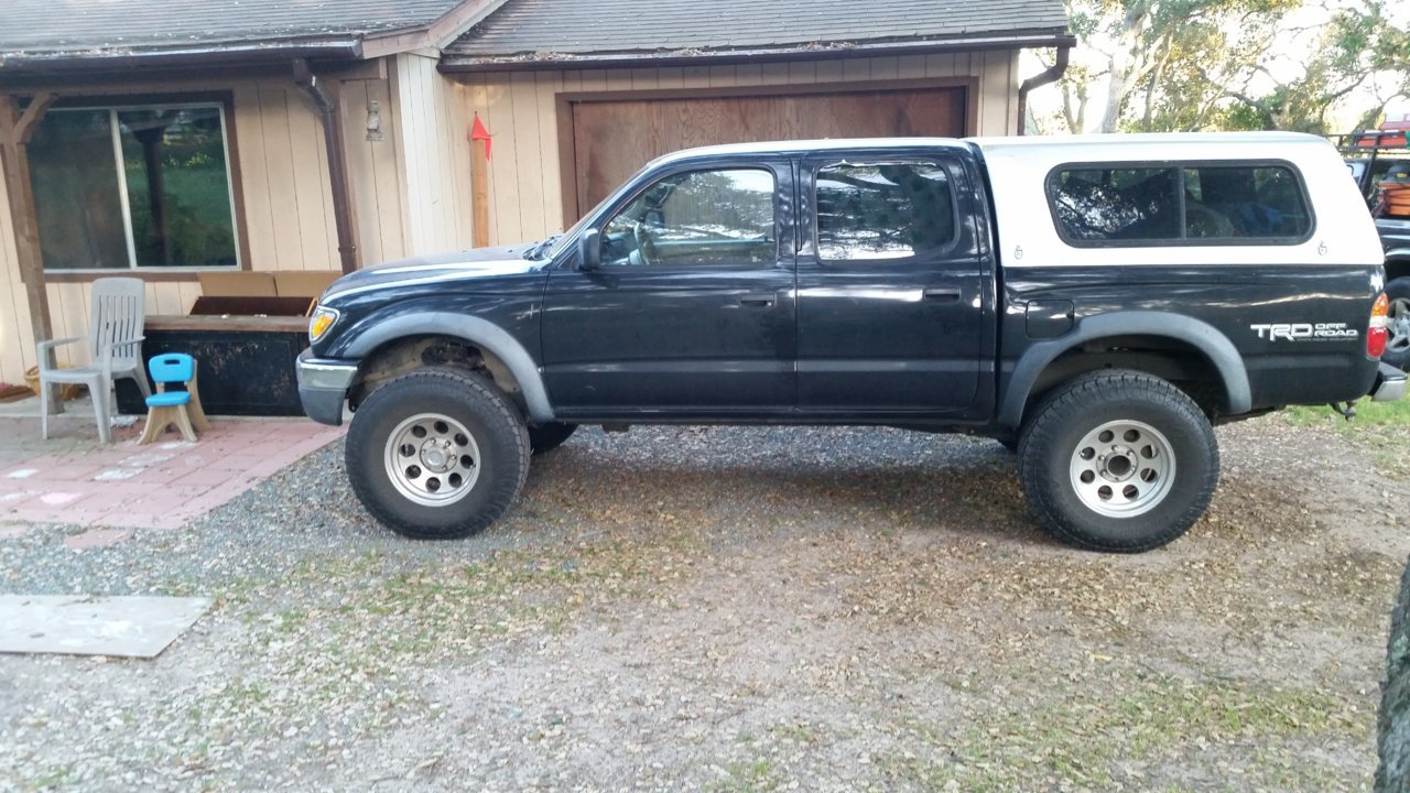

    This is my rig with dakars, camper shell and probably 150 lbs in the bed. Just my EDC. when I camp there's probably another 150 lbs in the bed. Family of 5. Center of hub to fender in the rear is 21". I wish I had put on the aal. Also, there are adjustable lift shackles you can get. Don't remember if they were on wheelers or toytec I'm gonna add both later. Read up on axle shims. They are supposed to help center your tire in the well. I don't know how they work but you can see how close my tire is to front of rear fender. 285 75 16.20180428_190059.jpg
