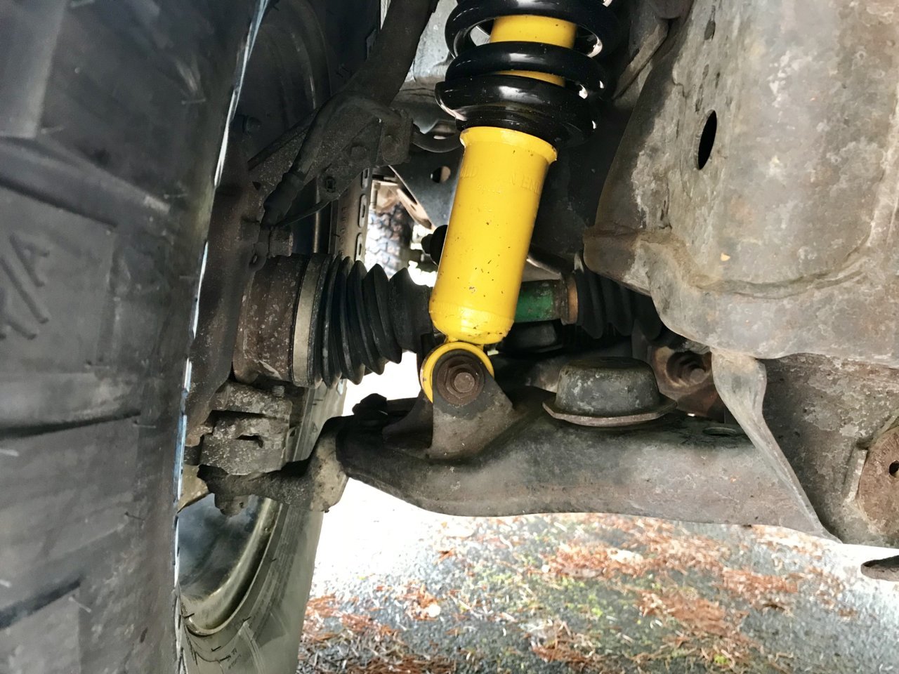

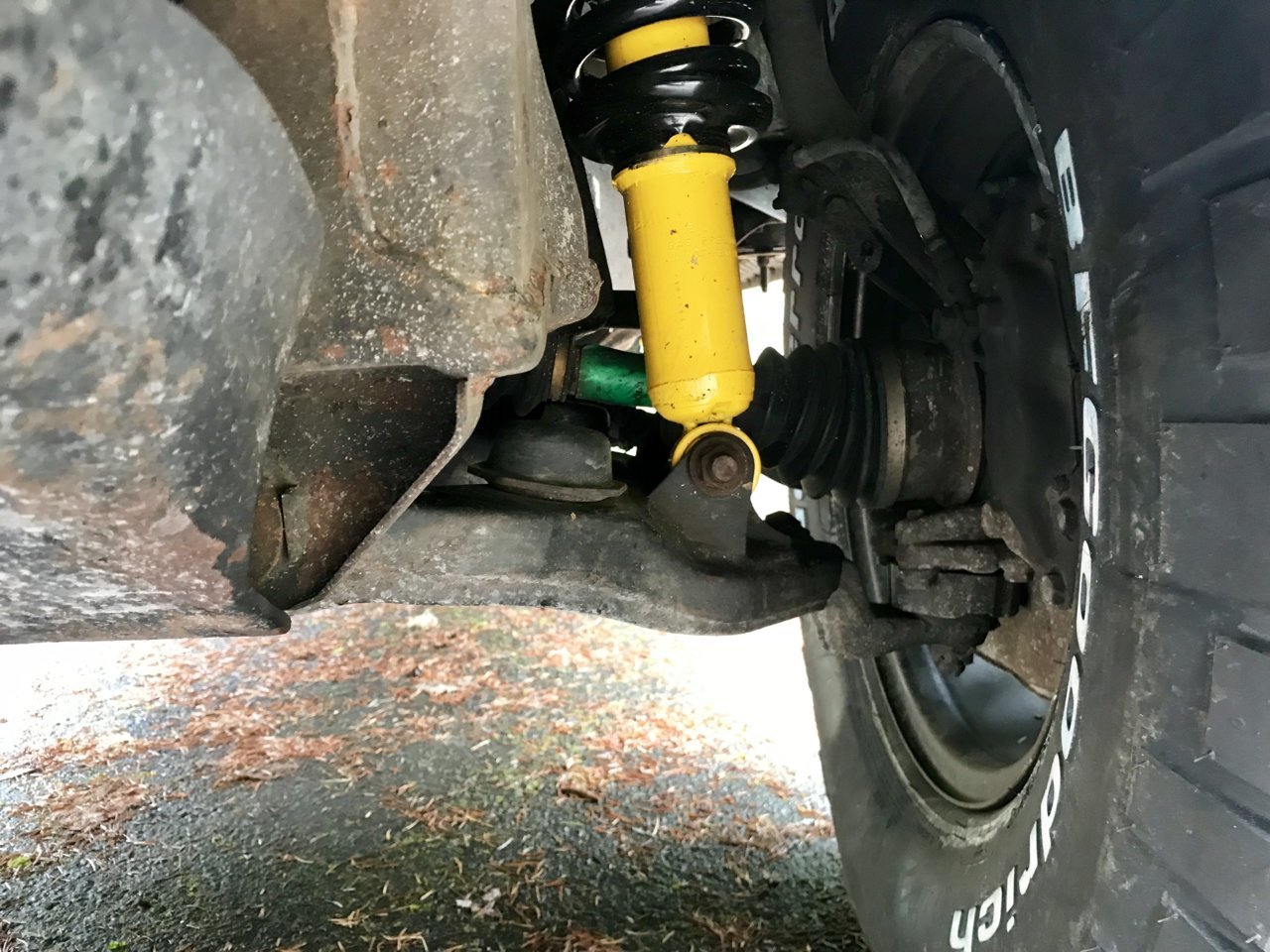

    Passenger IMG_6621(Edited).jpg Driver IMG_6622(Edited).jpg @SouthernYoder .........here ya go.
  11. May 1, 2018 at 9:36 PM
    #3671
    Malek
    Malek Well-Known Member
    Aug 23, 2012
    #85356
    120
    Malek
    Denver
    02 DC TRD
    1UZFE VVTi 5spd Swap
    Sorry for the late reply!
    Before:
    FD: ~20.5"
    FP: ~20.75"
    After:
    FD: ~24.25"
    FP: ~24.25"
    I don't have but 100mi or so on them so I am expecting to come down a little bit after breaking them in.
