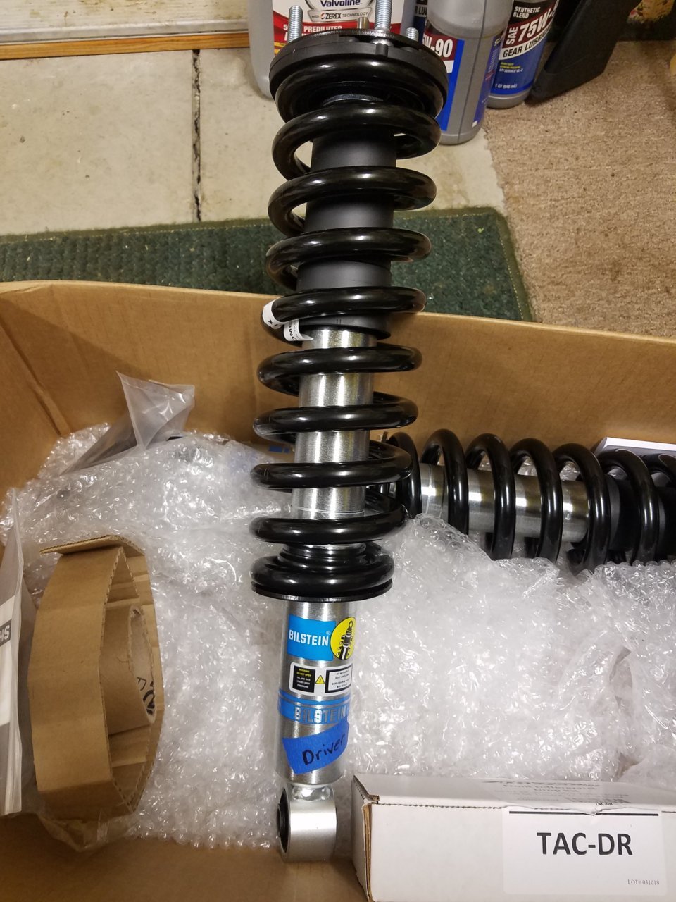

    Money sent to Wheeler’s on my new setup! I’ve got feelings of excitement and pain, all at the same time!
    881s pre-assembled to my shocks
    Nitro chargers all ‘round
    Dakars w/ no aal
    LR UCAs, because I’m replacing pretty much everything else, suspension-wise, too.
    Yup. Gonna be fun. Louisiana has been fairly nice to my truck, so far. Should I start hosing down stuff with WD40 anyway?

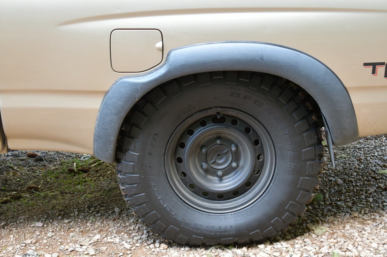

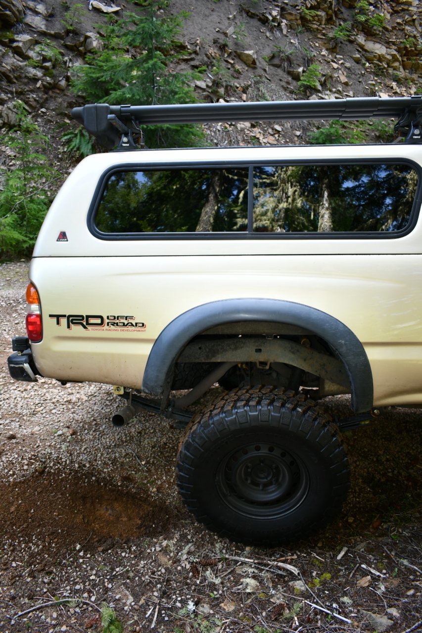

    Nice tire stuff. Any rubbing back there? Did you use axle relocation plates?

    Thanks! Minor rubbing. No on the relocation plates.
