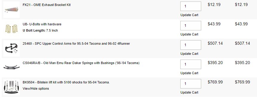

    I'm really close to pulling the trigger on Wheelers OME full kit + dakars. Been researching for WAY too long.This would be my first suspension install. Iv read 100s of pages of this and other forum posts. All the other options i.e 5100 + eibachs seem to be aimed at 3in+ and lots of weight (toytech: eibachs are like 620 or 650 right?) Also when i start pricing out 5100 + dakars +?? coils i always end up 300$+ more for lower cost(not saying they aren't good) shocks. Problem:
    -Cannot decide on 881 vs 883. I understand they are the same length 881(500lb) & 883(590lb). I have been told I could "get away with 881s if this is all the weight I have". Would rather a LITTLE firm over sagging too soon. Planning to keep it for awhile.
    Facts:
    -270k
    -Leaves are sagging
    -4600 shocks are leaking
    -recently installed a RockDefense low profile bolt on bumper, picture attached. This is only extra weight. I estimate +70lb over stock w/ the cross-member. Picture Attached.
    -dont seem to have noticed a huge difference in height(ie going down) after the bumper was added. Has me questioning if I need the 883
