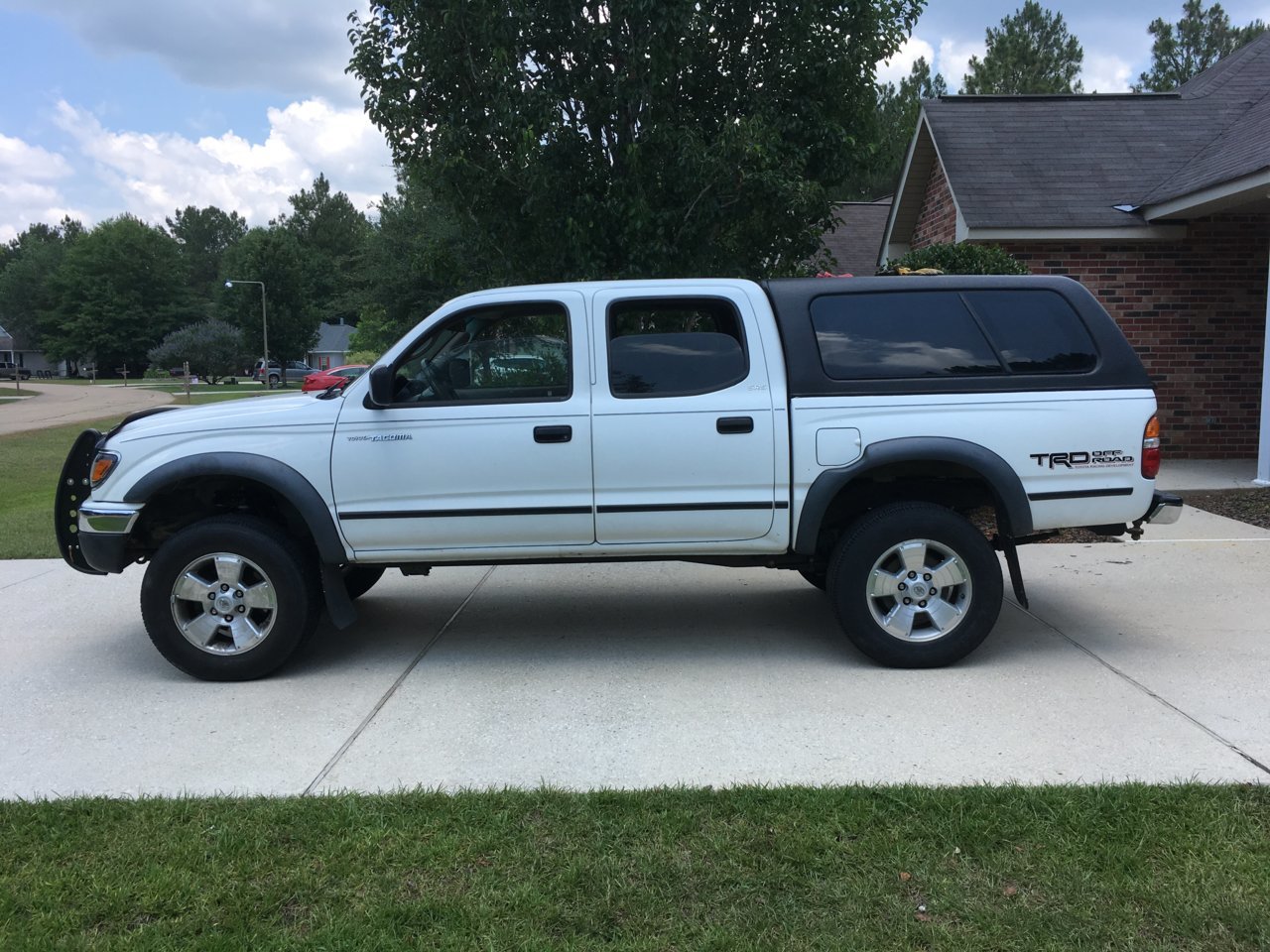

    pairodice
    pairodice Well-Known Member
    Jul 8, 2009
    #19456
    1,489
    Jay
    SF NM
    02 DCSB prerunner 4x4 manual
    265 75 16
    boostedka likes this.
  2. Jun 6, 2018 at 12:23 PM
    #3762
    Digiratus
    Digiratus Adventurer
    Mar 26, 2010
    #34006
    23,858
    Roaming the PNW
    The RedHead
    2002 XtraCab TRD 4x4 SCv6 AutoTrans With Lots of Mods ADS COs w/Compression Adjusters Camburg Uniball UCAs Whiteline Lower Control Arm Bushings Kartek 7" Limit Straps Plastics Guy Front Bumpstops Total Chaos Sprindle Gussets Custom Alcan Springs +800 lbs +3" ADS 10" Stroke Triple Bypass w/Resi Rear Shocks Custom Rear Shock Relocate All-Pro U-bolt Flip w/Timbren Bumpstops 4.88 Nitro Gears ARB Front Locker ARB Twin Compressor Black 17x8 Konig Countersteer Type X 285/70r17 Falken A/T3w Gunmetal 16x8 SCS Ray10s 255/85r16 Maxxis Bighorns Limited Edition (Relentless) Elite Front Bumper Smittybilt X2O 10K Winch Diode Dynamics SS3 Sport Selective Yellow Fog Lights in the Bumper Diode Dynamics SS3 Pro 4,000 Kelvin SAE Driving Lights with Clear Lenses on the Bumper Morimoto D2S Projectors XB35 Ballasts + 4300K Bulbs Badland Sliders FrankenFab Tire Carrier Swingout bumper w/kitchen BudBuilt Front & Bellypan Skids BAMF Rear Diff Skid Dometic CFX 55im Fridge/Freezer Alpha II Hardshell RTT Badland Custom Bed Rack Denso 210-0461 105 amp alternator Dual Northstar 24F AGM batteries BlueSea 7622 ML-ACR Battery controller Peak DBI Dual Battery Voltage Monitor Haltech IC-7 Display with Mako Dash Insert Haltech Elite 2500 Standalone ECU Magnuson MP62 Supercharger w/URD 2.2" Pulley Doug Thorley Headers Denso 650cc Fuel Injectors Aeromotive Stealth 340 Fuel Pump TransGo A340F Reprogramming Shift Kit OEM ECU Delete Full A340F Trans Control with the Haltech 2500 ECU 2.5" Magnaflow Hi-Flow CAT Magnaflow 18" Muffler w/Vibrant Resonator 13WL Brake Calipers with OEM Rotors & Pads Braided Steel Brake Lines Kenwood TM-71A Dual Band Ham Radio STI-CO Flex Whip VFH/UHF 1/4 Wave Antenna Midland MTX275 GMRS Radio w/Roof Mount Antenna Pioneer DEH-P9400BH HU Alpine Amps & Type R components (F) and coaxials (R) Wet Okole Seat Covers Weathertech Digital Liners Deck Plate Mod 1" Diff Drop Carrier Bearing Drop
    More than 39"s on the front with 32" tires is a bit ecessive and will leave you with little down travel. Hopefully is settles a bit for you.
  3. Jun 6, 2018 at 1:24 PM
    #3763
    pairodice
    Jul 8, 2009
    #19456
    1,489
    Jay
    SF NM
    It's taller than i expected, but when i 4x4 swap it should add a little weight. Plus at some point bumpers, winch and headache rack

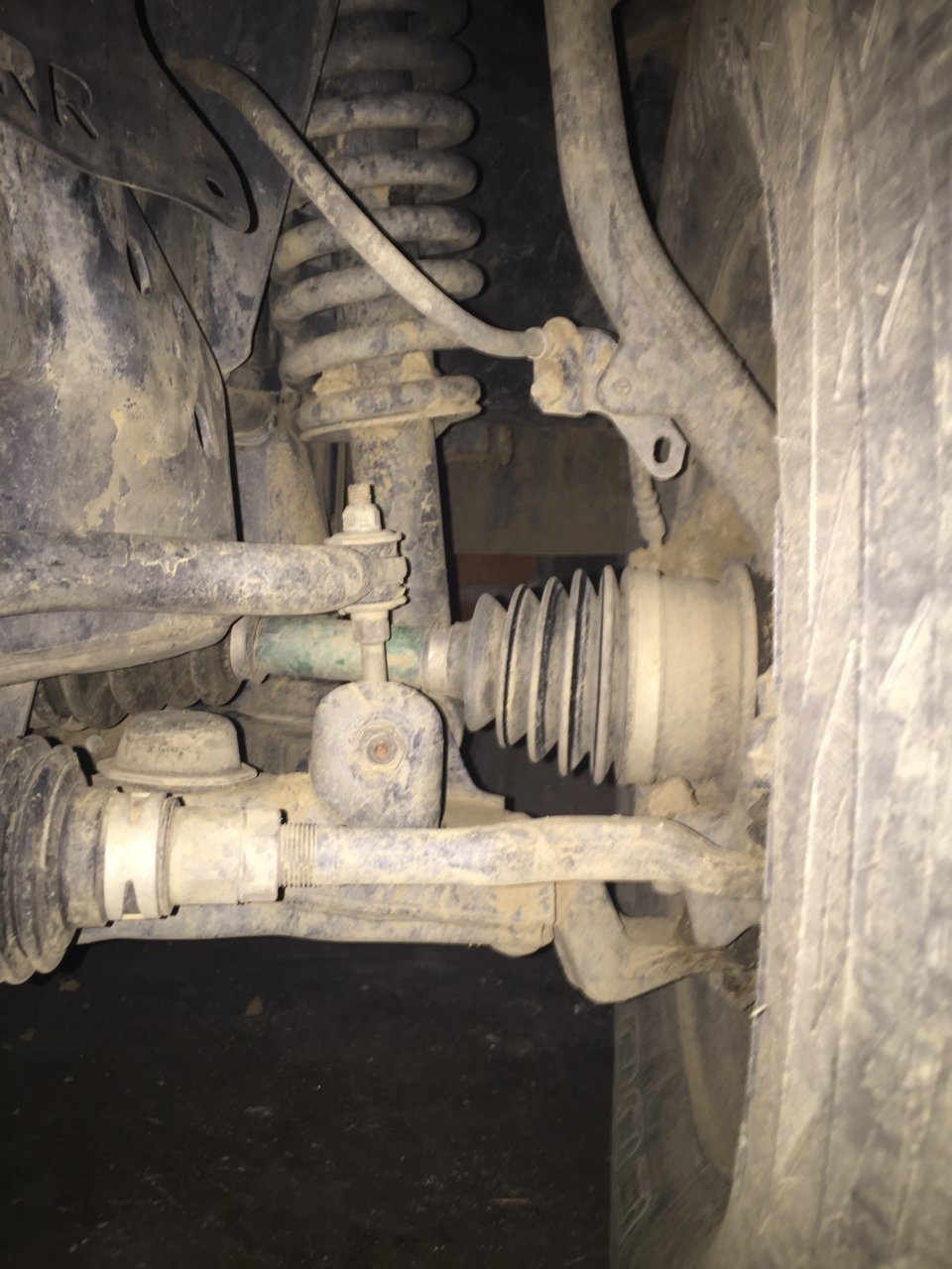

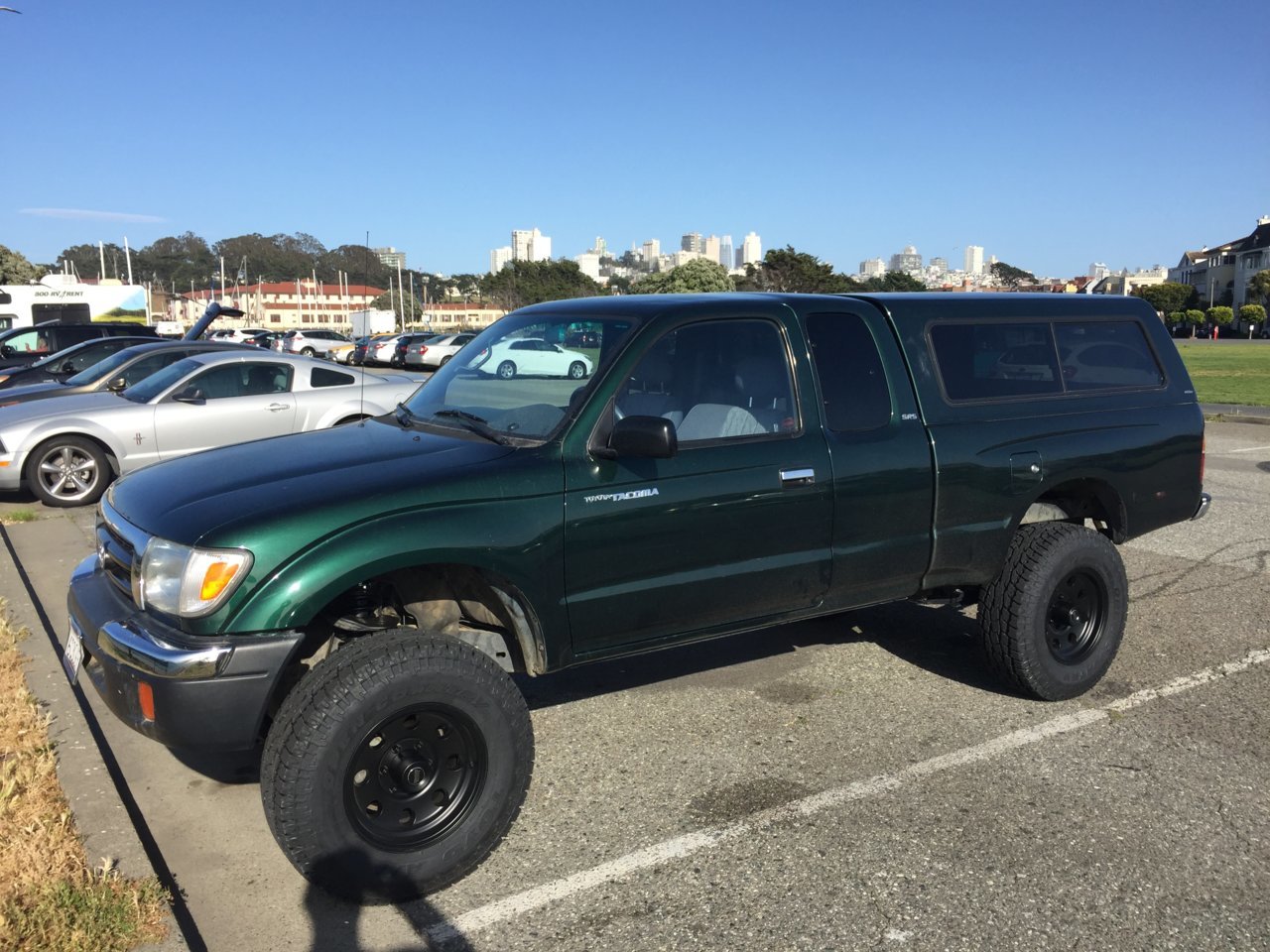

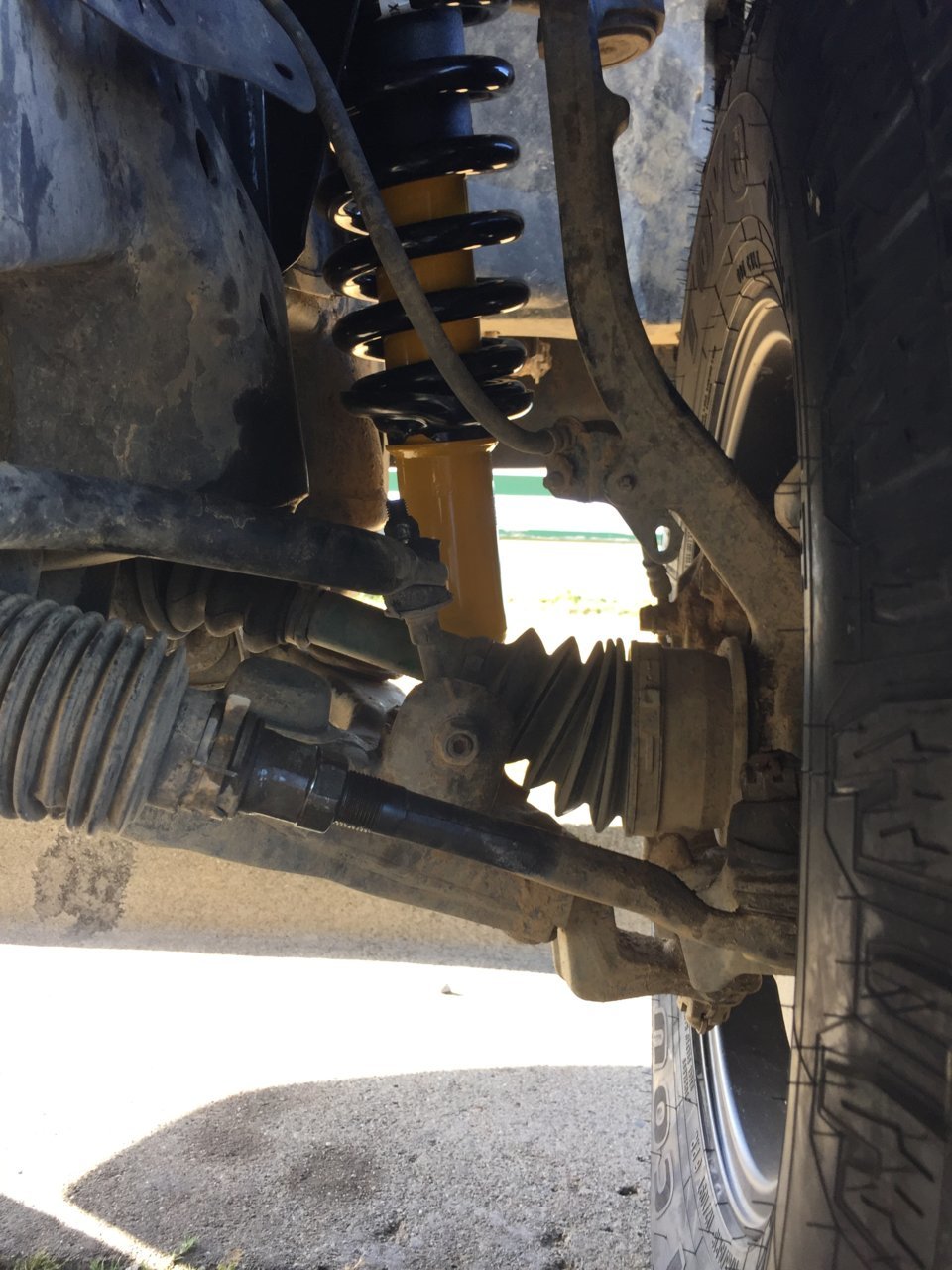

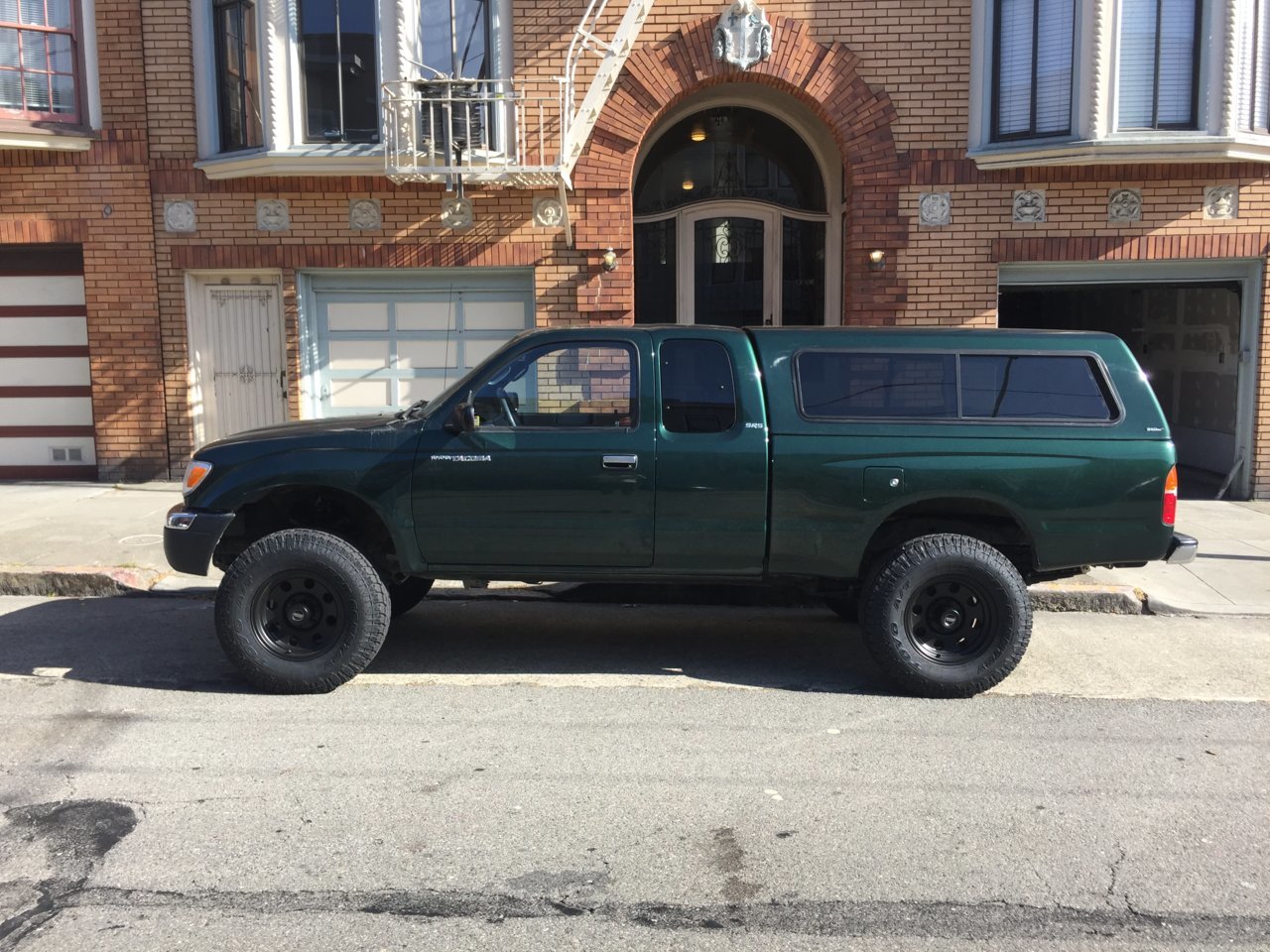

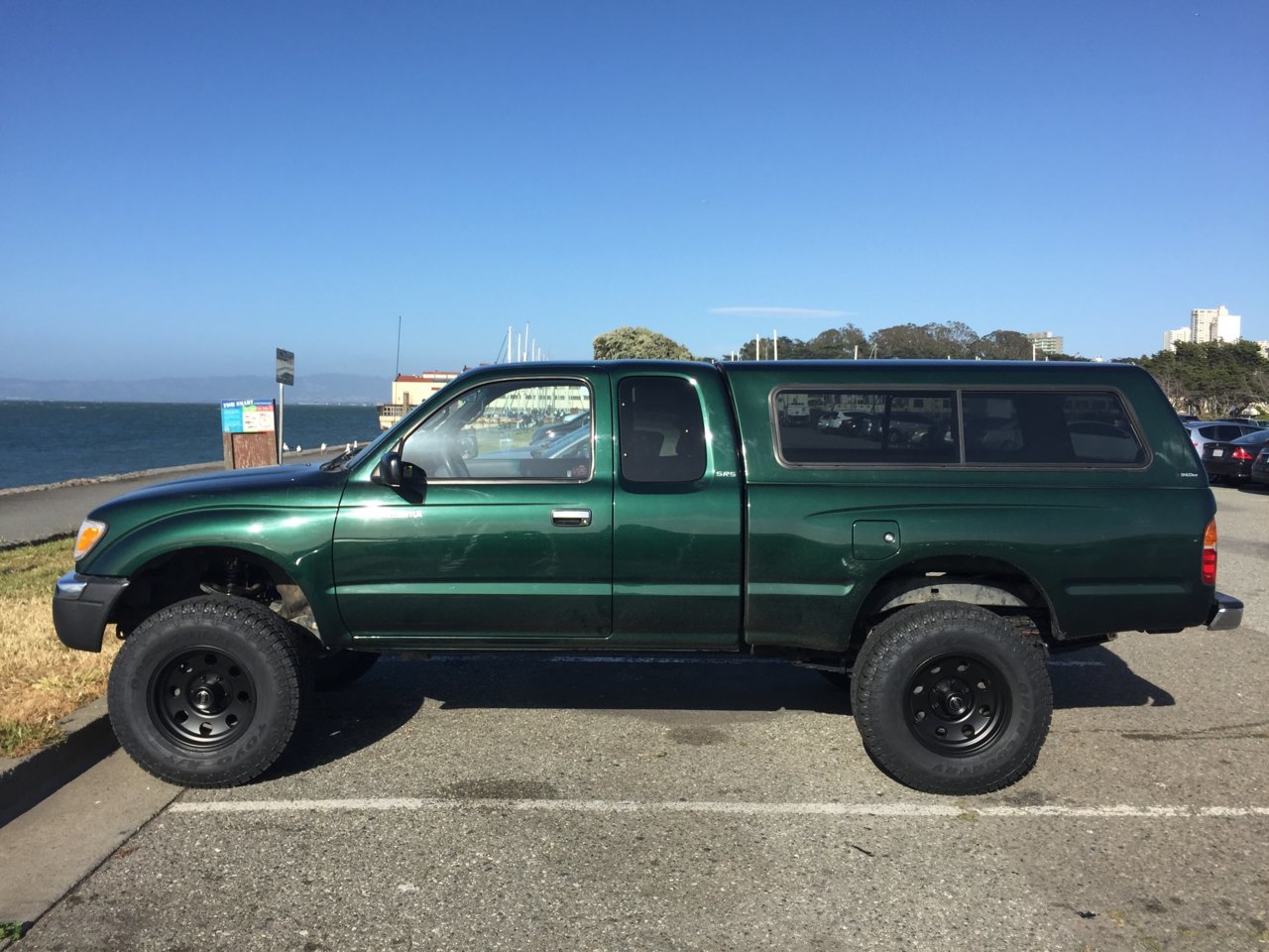

    Hey all, got the lift, wheels and tires installed.
    Truck: 1999 Tacoma, xtra cab, 4x4, v6, 132k miles
    Lift: OME kit, 883 coils, dakars (no aal), OME nitrocharger sport shocks.
    Tires: Toyo Open Country ATII's, 265/75/r16
    Wheels: American Racing Baja AR172, black, 16x8
    Before: (corner, center hub to top of wheel well, ground to wheel well)
    Driver front, 21inches, 34 1/3
    Passenger front, 21, 34
    Driver rear, 21, 34
    Passenger rear, 21, 34
    After:
    Driver front, 24 5/8, 39 3/4
    Passenger front, 24 5/8, 39 3/4
    Driver rear, 24 1/2, 34 3/8
    Passenger rear, 24 1/2, 34 3/8
    Basically 3.5 inches a lift overall, which is about an inch more than expected. Hoping that addition of a new front bumper and winch bring it down slightly in the front and soften the ride. The ride with 883's is a lift rough with no extra weight up front but not bad, hasnt bothered me. CV's aren't looking great, another reason I am hoping it relaxes in the front with weight. About 400 miles in, I haven't seen any change in the ride height.

    Looks good, I'm running the same setup w/5100s on a double cab. Almost 4 inches of lift after install last month. It has broken in and lowered about 1/2 to 3/4 all the way around. Still sits perfectly level. I'm a bit lighter up front since its a prerunner but not for long. Bumpers and winch going on in the future one I get the 4x4 manual swap completed

    I know it came up 3.5”. I wonder how much of that is because your old suspension had sagged.
