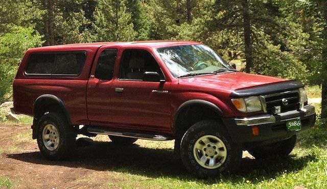

    here's my 99 with its new OME kit...
    Tacomaman63 likes this.
  4. Jul 9, 2013 at 1:42 PM
    #364
    Madjik_Man
    Madjik_Man The Rembrandt of Rattle Can
    Dec 2, 2009
    #26893
    19,725
    Colorado Front Range
    1998 Ext Cab 3.4 4x4 TRD 5MT, 2004 DC 3.4 4x4 TRD
    That looks great. Same with the other pics in your gallery.
    Not too much wheel well gap at all.

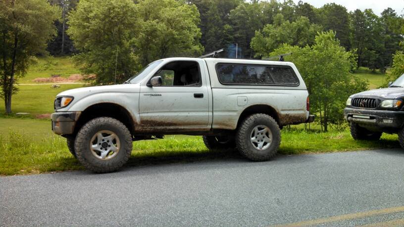

    Pics I posted before. 883s on 255/85/16 bfg km2s

    Nice !! you'll love the 883#'s & looks like you need about 1.5" to level out...:thumbsup::thumbsup:
