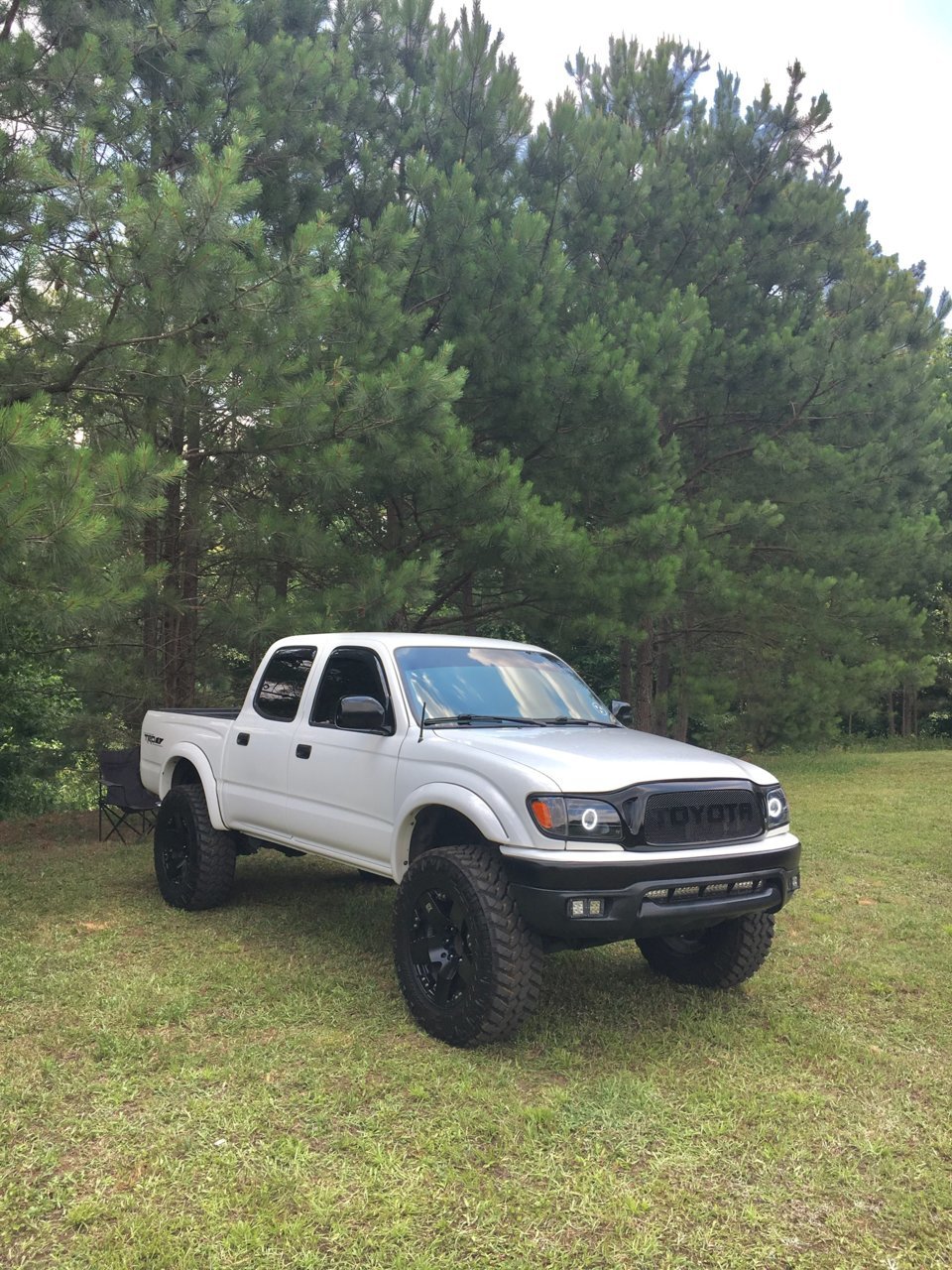

    #3798
    Suggs12
    Suggs12 Well-Known Member
    Jun 24, 2014
    #132572
    253
    Logan
    Johnson City, Tennessee
    2004 PreRunner
    3" Lift kit, Bilstein 5100 front and rear, 2881 EMU coils, 2" Deavers AAL, 18x9 KMC rockstar 1 wheels and 33" Nitto Terra Grapplers, Debadged, Grillcraft insert, clear corner and turn lights, 6k Leds, 30" Led light bar, 4 Pod fog lights.
    Bilstein 5100's front and rear, 2881 coils, and Deavers AAL. Front is set on second notch which is .67" I believe.
  19. Jun 29, 2018 at 5:55 AM
    #3799
    taco03Trd
    taco03Trd 03 rig trd v6
    Sep 29, 2016
    #198568
    1,154
    Carlos
    Riverside ca
    03 DC prerunner trd v6 2wd
    Ome 881 5100's jba's looking for more
    Looks good @Suggs12 any top spacer ? Hows the ride feel ? Whats size wheels
  20. Jun 29, 2018 at 5:56 AM
    #3800
    Suggs12
    Jun 24, 2014
    #132572
    253
    Logan
    2004 PreRunner
    No top spacer, could really use some UCA but rides not terrible. Wheels are 18x9 0 offset, tires are 275/70.
