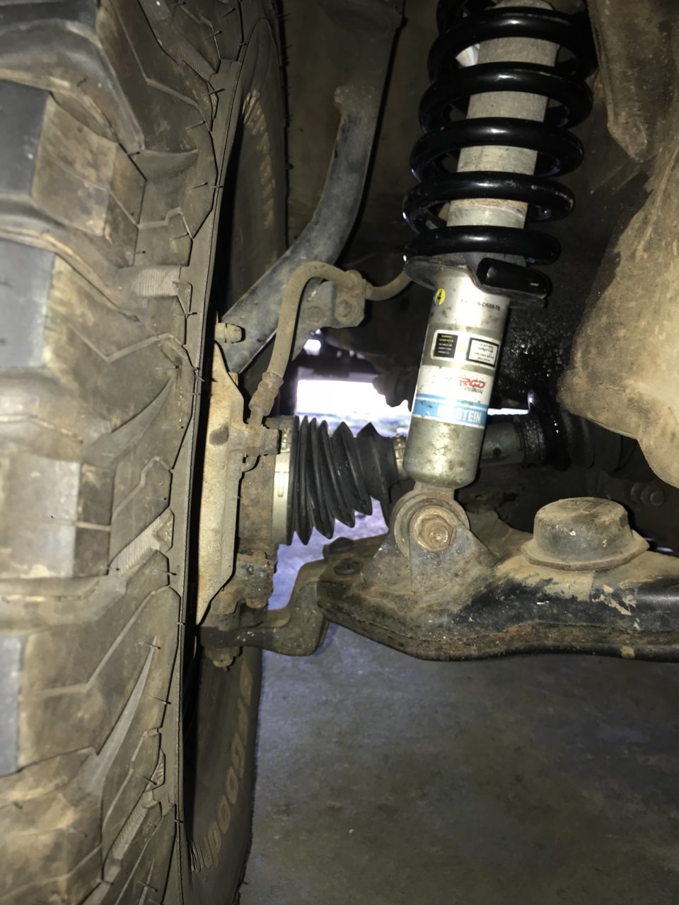

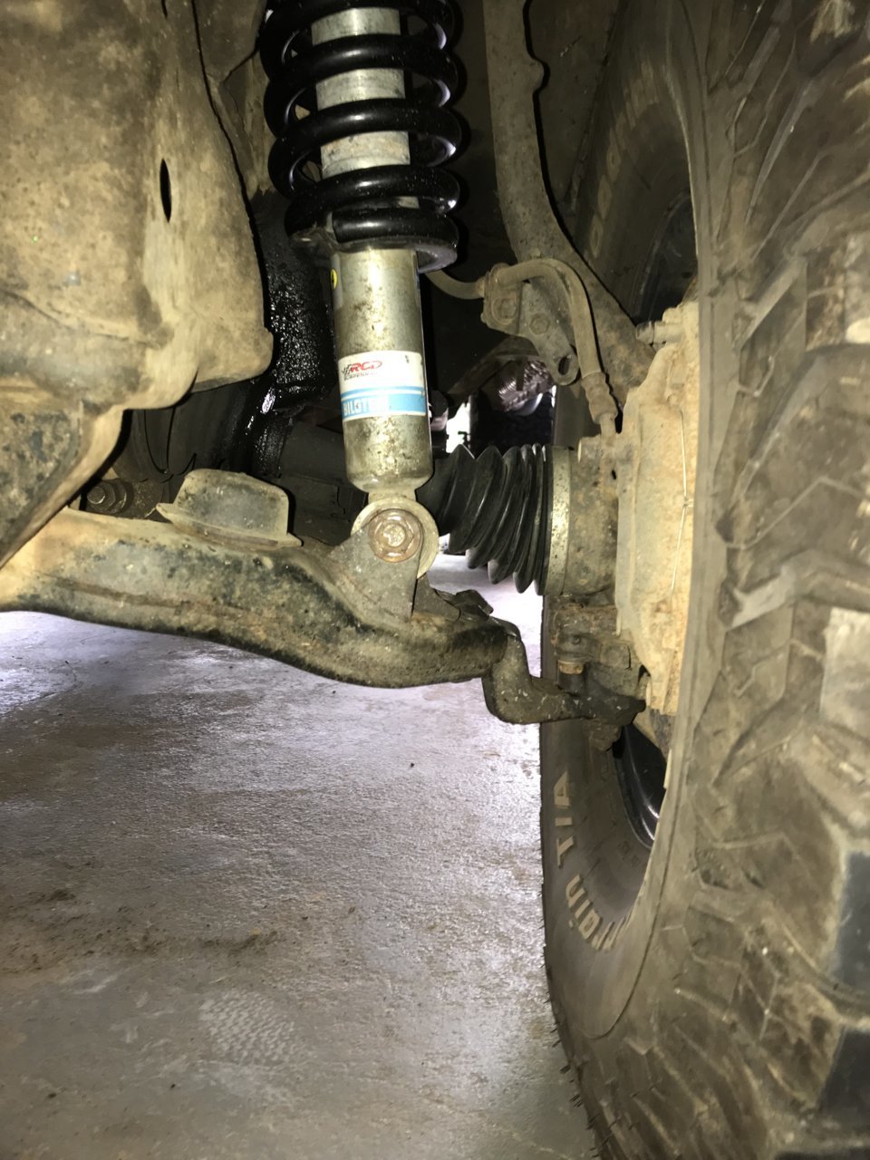

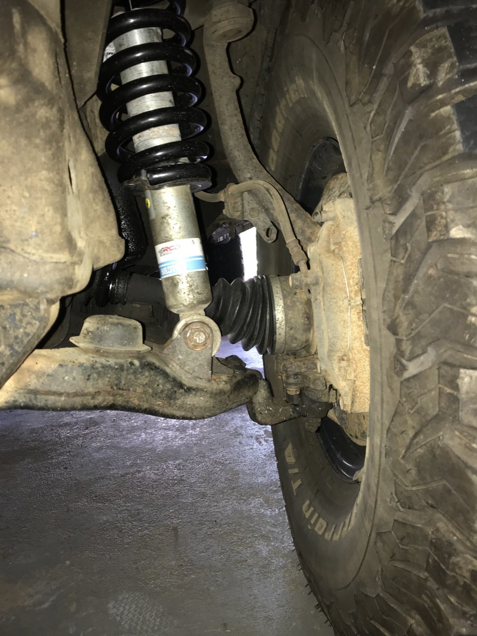

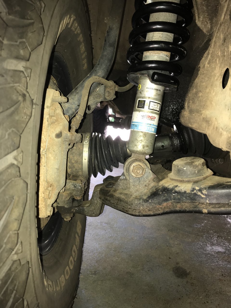

    Just got some 881s w/ a 3/8” top plate spacer installed on 5100s. I also just finished installing the @Wheeler's Off-Road Inc differential drop kit. The pic of my truck is on a slight incline but it’s relatively even on flat ground. 4F41E4BA-A541-4290-8476-A477F77B6158.jpgBefore diff drop64D94A4E-AC4A-4EEF-8F79-646757D8CED4.jpg75C11B77-4279-4B9F-85DC-A727D2B43478.jpgAfter diff drop34561C42-8375-4DD1-8A89-73BA2AE20842.jpg4AE6D300-E34E-45EE-BEAD-B207495F08D6.jpg

    I don’t know if I’m seeing things or not but it sure looks like his cv axles are leaking if not tore.
  10. Jul 1, 2018 at 7:27 AM
    #3810
    Smash8ight
    Smash8ight Well-Known Member
    May 6, 2017
    #218360
    160
    Steve
    04 trd
    Bone stock
    Something is definitely wet in the back.

    Definitely leaking CVs

    For sure. What’s the easy fix, if any?

    New cv axles. Might as well get them. Unless you want to re-boot but you’ll be pulling the cvs anyway. if you got the coin just get some remannads somewhere
