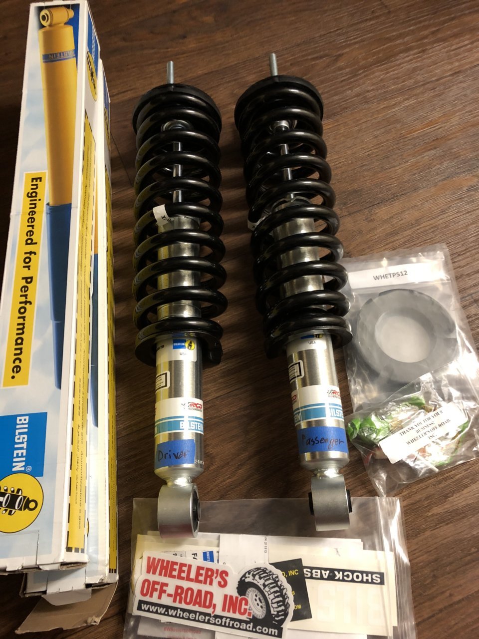

    I spoke to wheelers and got some 881s, ill be installing on monday. They told me with a trim packer, 1/2inch spacer plate i should get about 2.5-2.7 inches of lift. (Which is what i want). And i have 265s/75/16.
    Currently with a 3inch spacer lift i sit 38 1/2"
    When i get my 881s done ill get back and share where i sit.
    Now my truck is a prerunner so its lighter, im guessing im gonna sit higher.
    People with 4x4 dbc have recommended 882s and 883s.Weight plays a big role in the amount of lift achieved. (I didnt get the 882s or 3s because i don't want a harsh ride and im not running a bumper or winch)
    But again, ill report back with my measurements

    Im trying to upload a photo from my Galaxy S8, but it wont post :mad:
