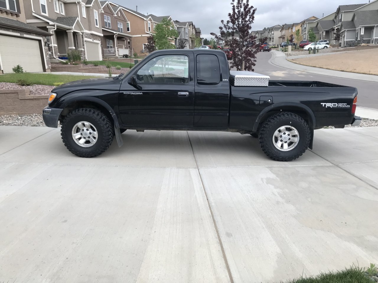

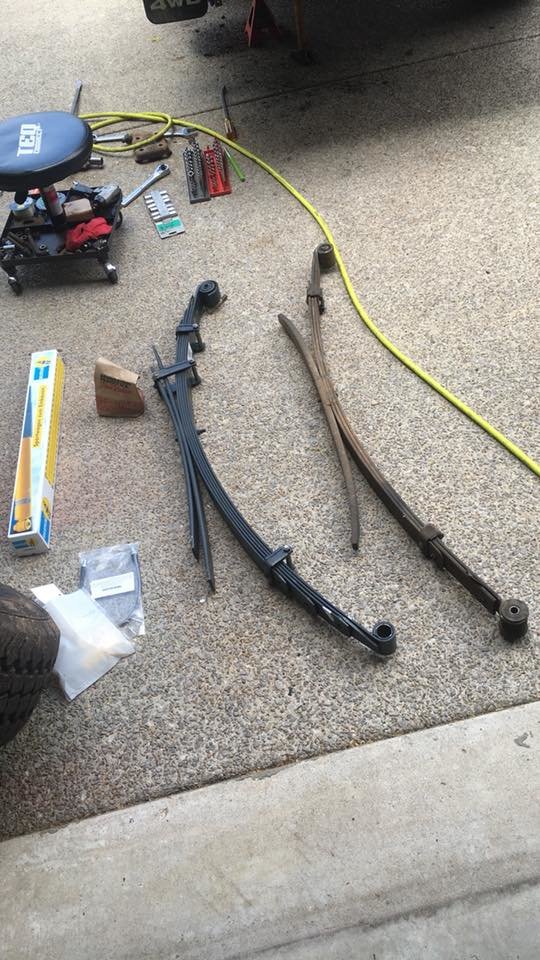

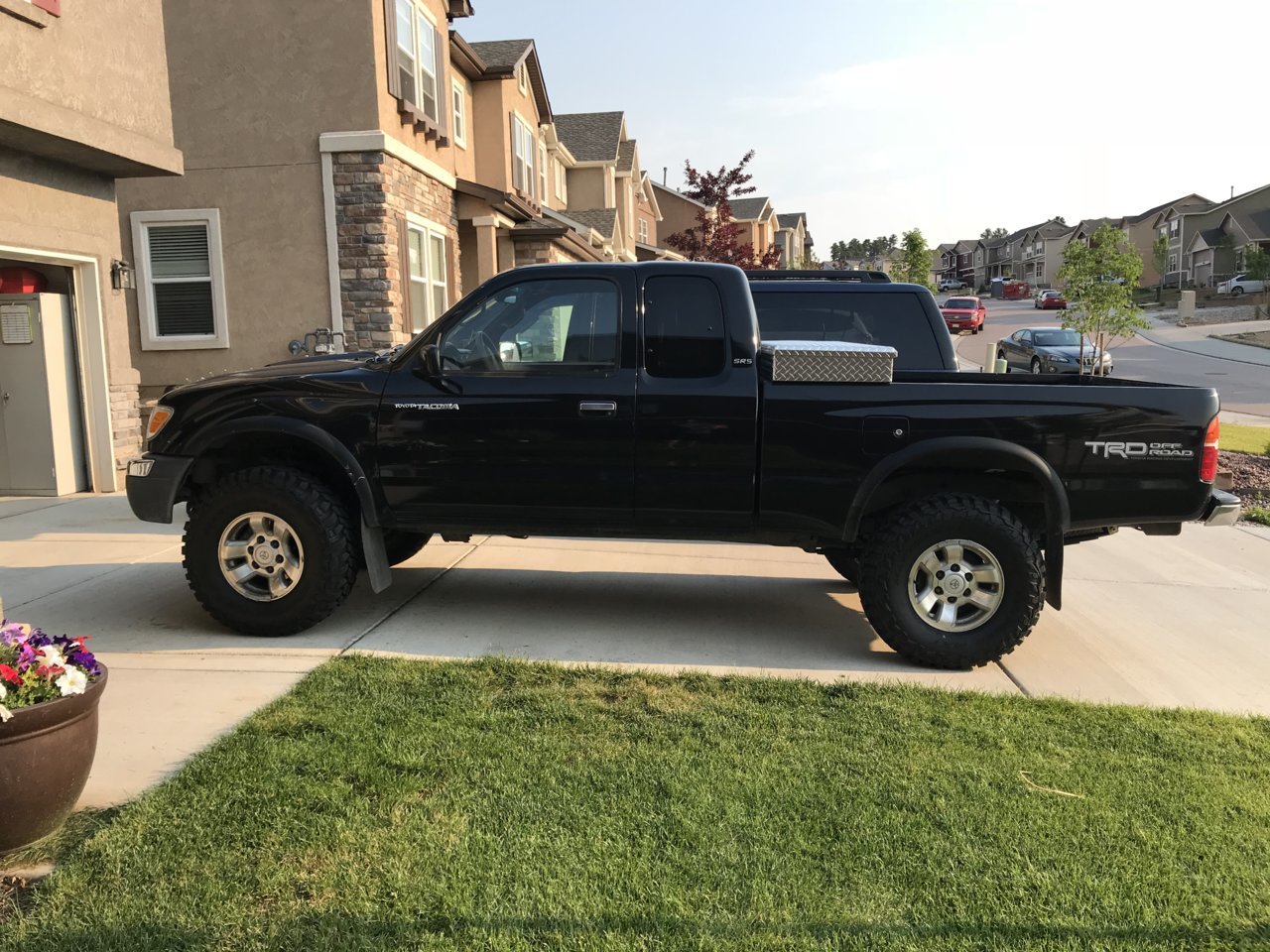

    OME 880's on Bilstein 4600's OME Dakar Leaf Pack with 5100's in the Rear 32x11.5r15 Mastercraft Courser MXT's Diff Drop Sway Bar Delete
    Before:
    880 on 4600:
    OME Dakar Leaf Pack on 5100:
    After:

    Ajax hows the ride on that set up rig looks good man

    Surprisingly, very smooth. Soaks up the bumps really nicely. Feels 100x better than my worn out stock suspension.

    How much lift did u get over the stock set up

    taco03Trd: I got about 2.5 in the front and almost 3 in the back, but that was because my stock leaf springs were pretty tired. I did also add a 1/2 in spacer in the front to get a little more lift from those 880's.
    TheDamaso: I actually got the whole suspension setup for about $350 because my buddy had a bunch of spare OME stuff from a Taco he just sold. The tires set me back about $650.

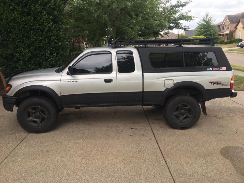

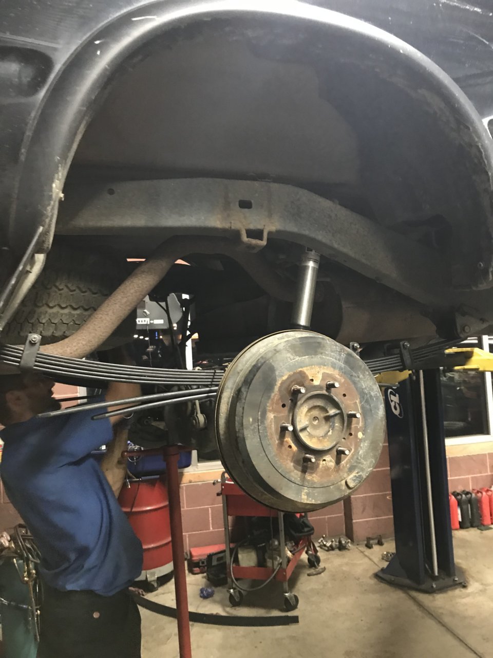

    Roof Rack Skid Plate OME 881/Nitrochargers Dakars/5125s FJ Grill

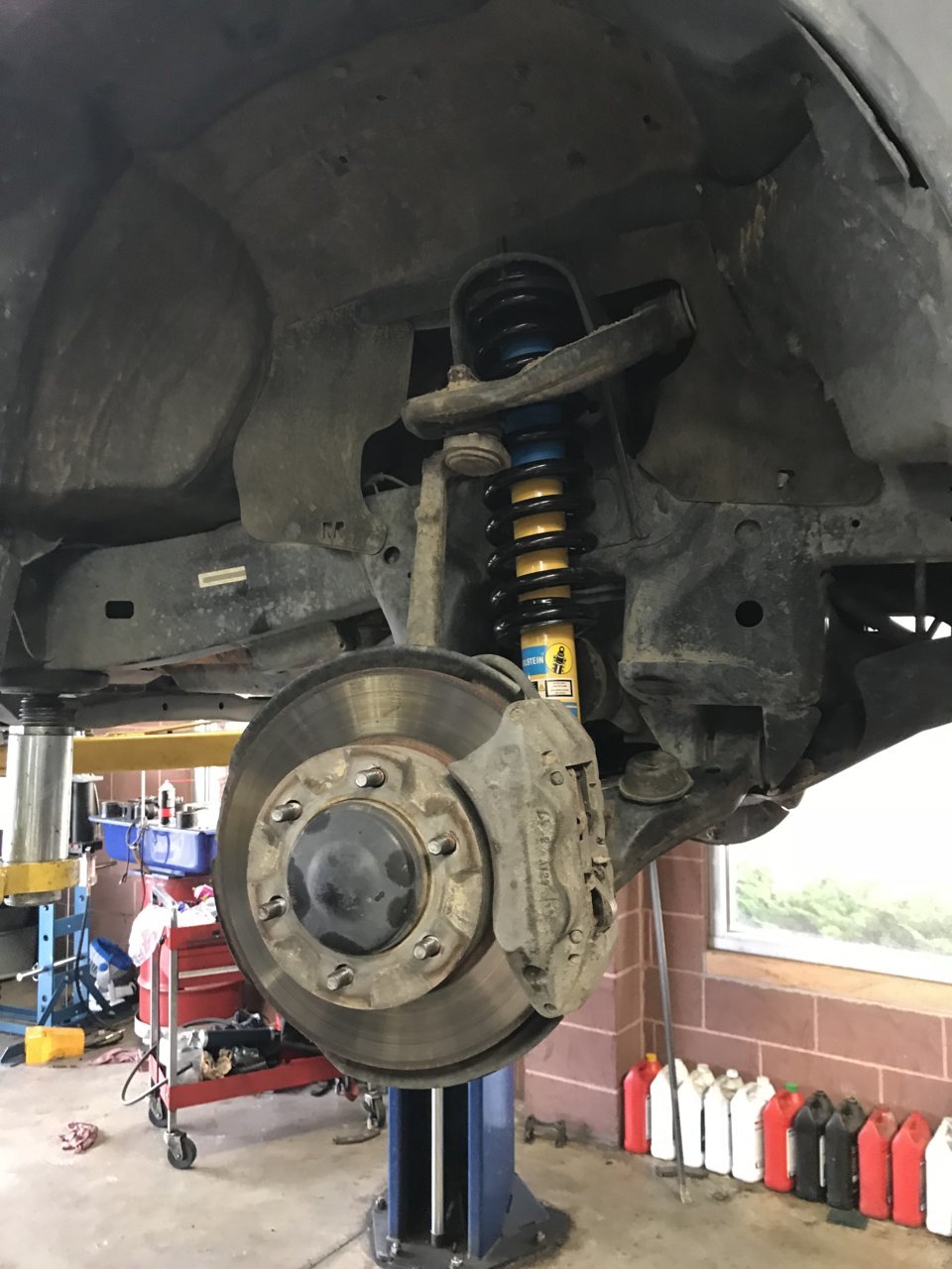

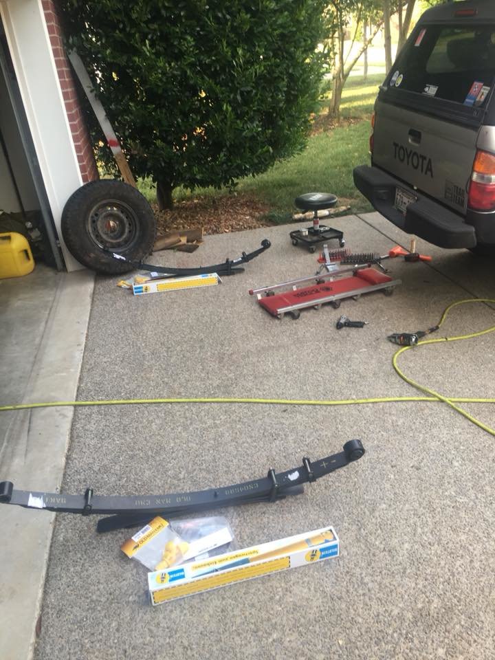

    Just finished my back this weekend, did the front about a month and a half ago. Running 881s/Nitrochargers up front and Dakars/5125s in the back. Replaced a bunch of stuff in the front while I was there and I'm probably going to have to replace the seat plates that the U-bolts go through soon as well.

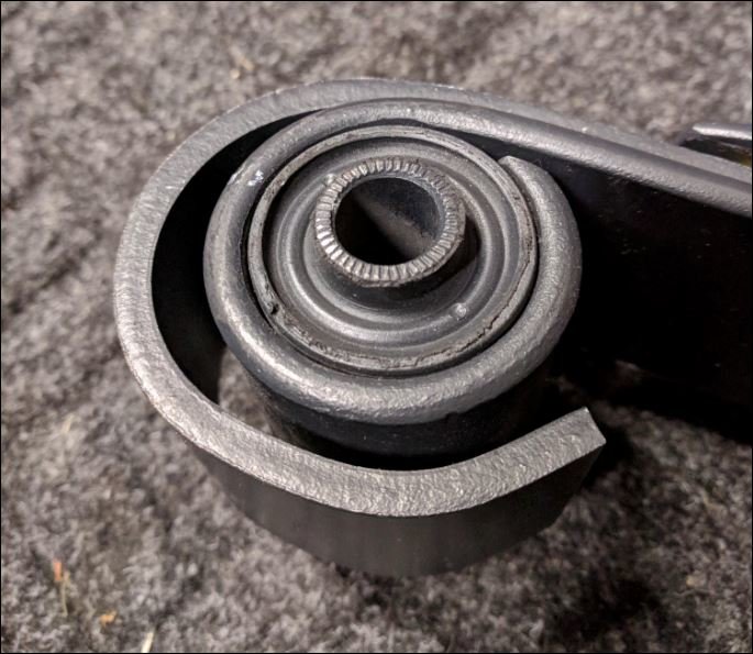

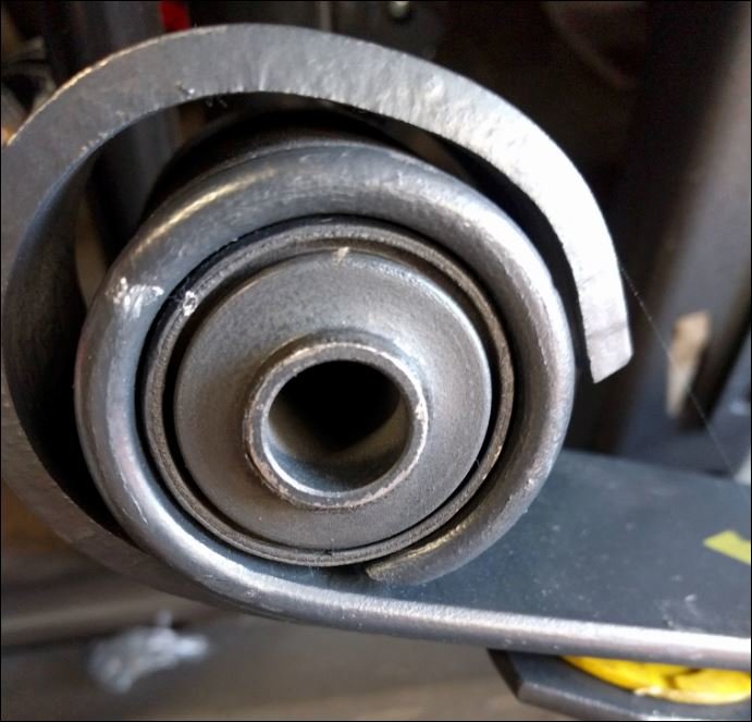

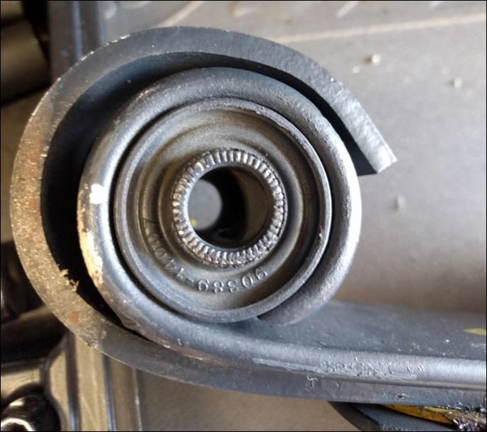

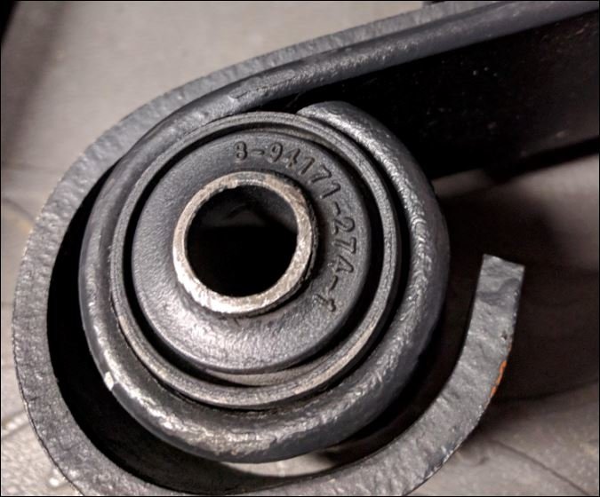

    Ordered the full kit from wheelers and during the install, noticed the dakar bushings were different for the front hangar. Really odd. Now I am doing one side at a time so I cannot compare driver for driver as I am on the passenger side. I checked and stock toyota front leaf hangar bushings have the same part# and look like the one I have on the passenger side dakar. When I googled the # on the driver side dakar bushing, it returns as a Honda/Isuzu bushing (WTF?)... Ok - here are the pictures:
    Anyone else notice this on their dakars? Expected? I'm going to reach out to Wheelers to figure it out but wanted to see if I could get some answers here.
    Driver Side 1
    Driver Side 2
    Passenger Side 1
    Passenger Side 2
    UPDATE: Response received from Wheeler's -
    Instead of these funky mismatched rubber bushings, I'm going to order the and give those a try.

    Cool - good to hear you didn't run into any issues. I ended up ordering a pack of Energy Suspension bushings from wheeler's and will complete my install this weekend. This thread made me feel a bit better with the decision to swap them out as well. https://www.tacomaworld.com/threads/change-the-front-bushings-in-your-dakars.479071/#post-14571486
    On a side note, two of my inserts for the spring clips on the passenger leaf were cracked / broken. Reached out to Wheeler's and they took care of it by dropping replacements in the mail. A few others had this issue as well and reached out directly to ARB who also resolved immediately. https://www.tacomaworld.com/threads/ome-dakar-spring-keepers-damage-rant.416812/ Good to know the support is still there and folks stand by their product.
