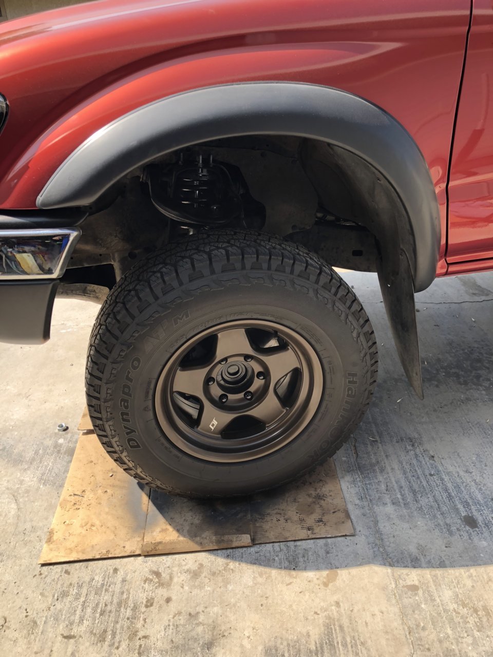

    I'm running 24 1/2 center hub to fender with 5100s at the lowest setting and ToyTec 620# coils.
    Measured against a friends stock double cab I was 3 inches higher than him. Meaning he is at 21 1/2 stock. I think your old coils were sagging.

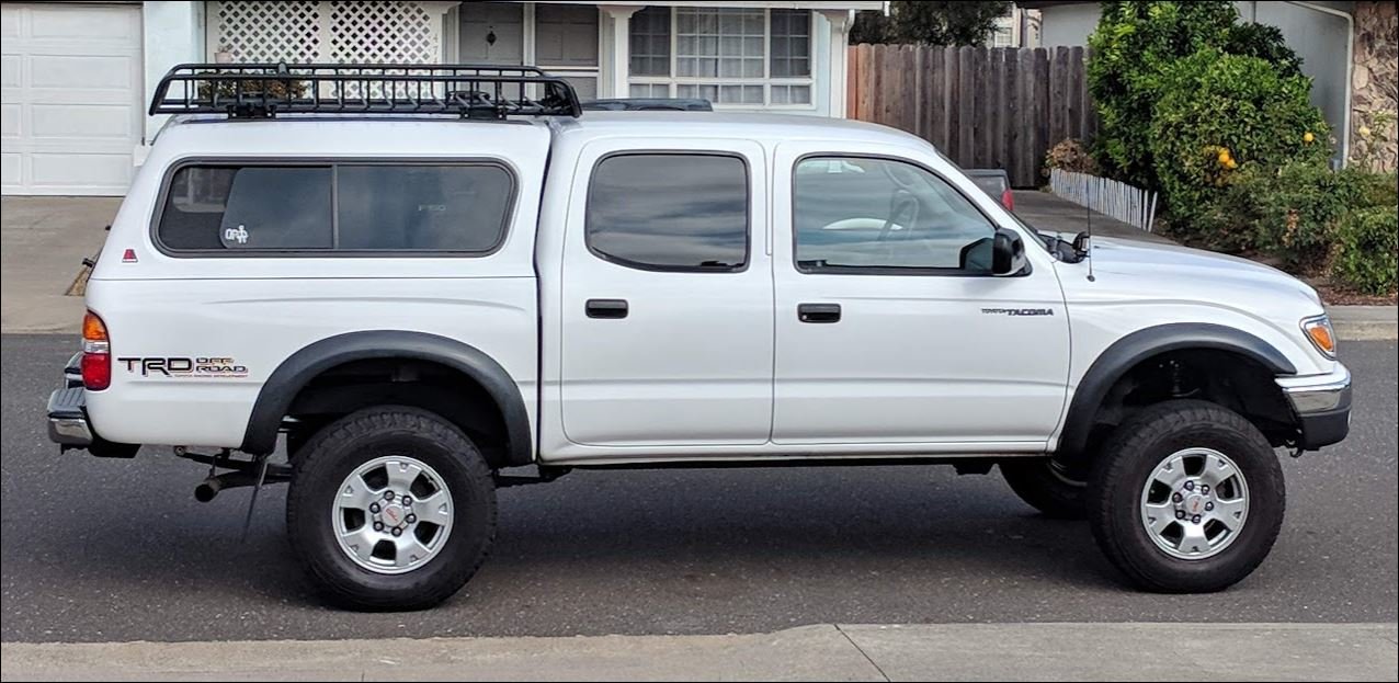

    Agree with above...
    If its on the ground now, let's see it!
    EDIT: just went out and measured again to be sure but I am sitting at approx 24" hub to fender with 881s/nitros - stock bumper.

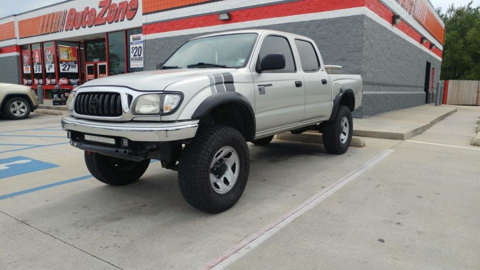

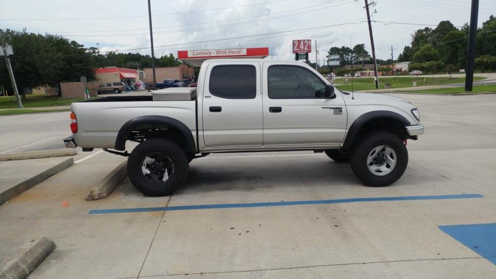

    Only pictures i have right now

    looks great - nice looking rig! damn, now perhaps I should take off my cap lol. Still need to swap out my wheels and new tires but I'm satisfied for now. Much better than those 16 yr old tired suspension components.

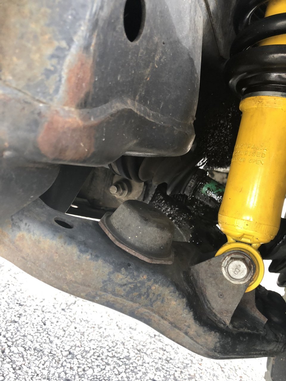

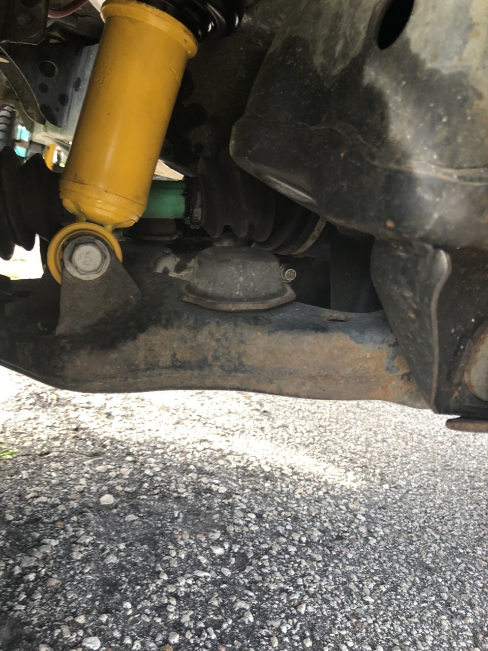

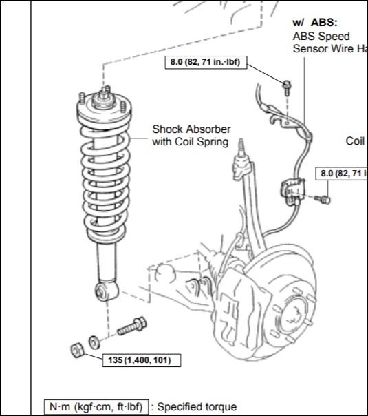

    Dont RIP your CV boots open with that lower shock bolt. The OEM bolts go nut out for that reason. Went down that road, on compression and turning. There was no getting out of it.

    I didn’t install it so I wasn’t aware. I’ll look at it. Is it gonna take disassembly of the front suspension to be able to flip that around?

    ooooohhhhh good eye!
    I just pulled the coilover yesterday. Didn't take long at all. You won't be removing it so even shorter amount of time. Might need a second jack (i used the bottle jack), to put a little downward pressure on the UCA or upward pressure on the LCA to help line up that lower mount. Careful with any tapping the bolt into place to avoid damage to the threads.
    Put the front on stands, high enough to be at full droop of course
    Remove lower shock nut and then bolt
    Flip it around and snug it up hand tight
    Drop the front and once on the ground, torque it to 101 ftlb
    As an alternative to doing it yourself, just go back to the shop that did the work and have them follow the correct orientation for that bolt. They should be fixing their work.
