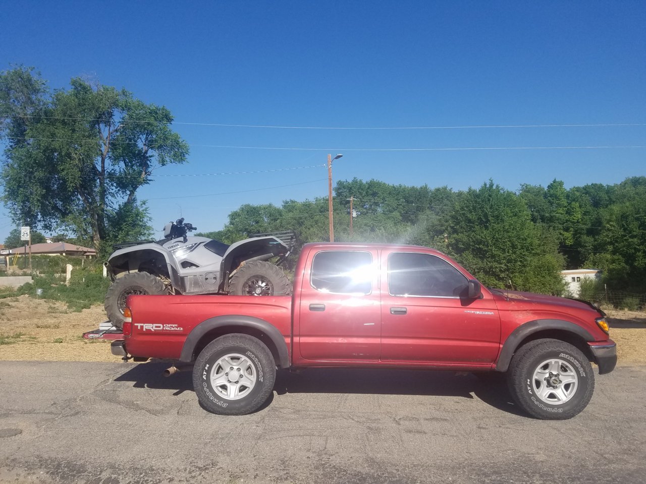

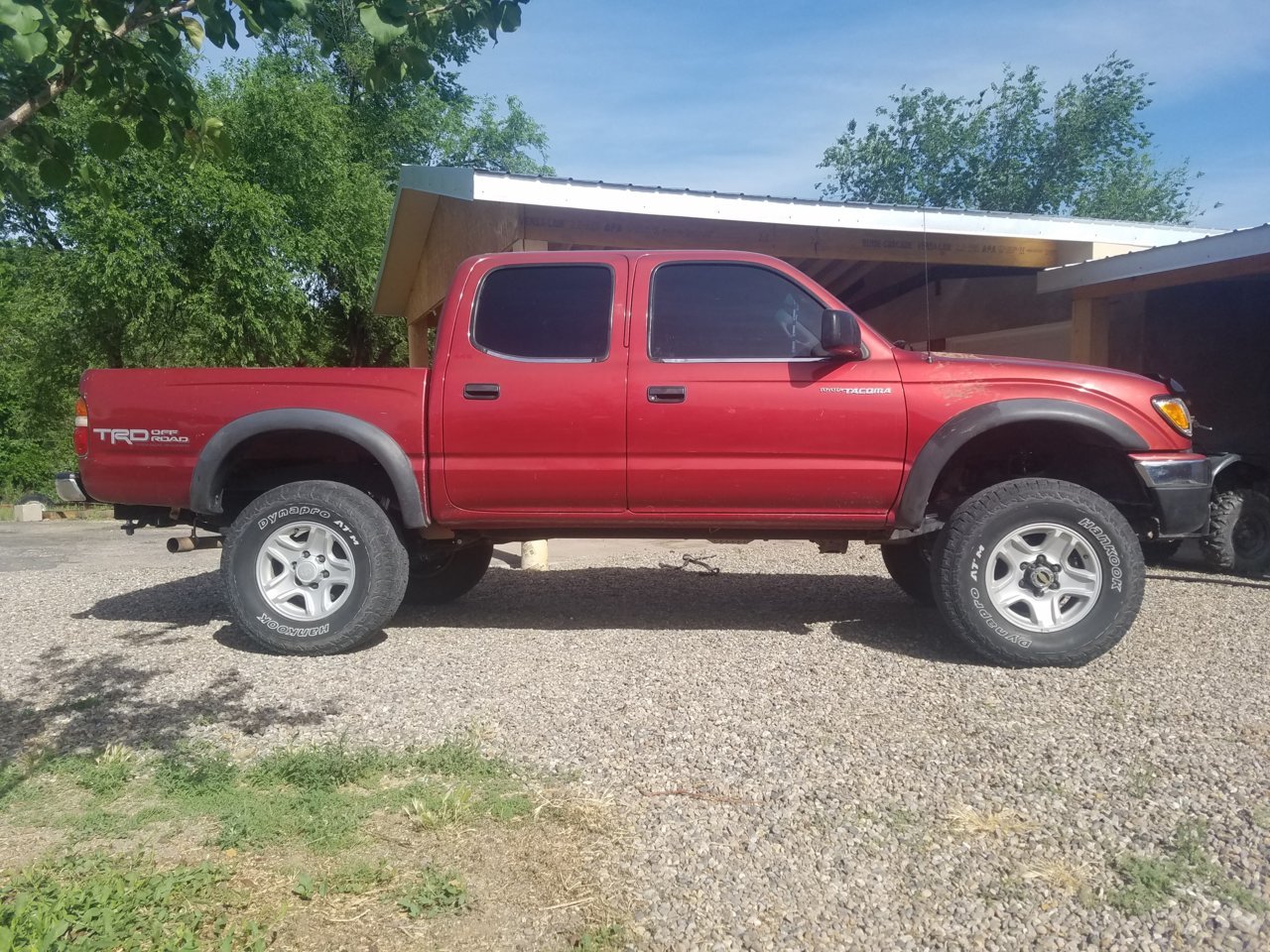

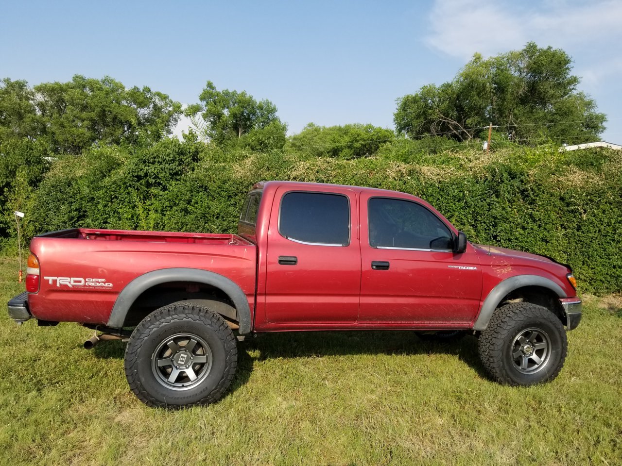

    It rides firm but not rough. It definitely rides better after springs break in. Also I removed the sway bar it helped smooth out the harsh bumps. Before it was was saggy lca were flat up front, rear 2 inches from bump.
  16. Aug 11, 2018 at 4:56 PM
    #3956
    pairodice
    pairodice Well-Known Member
    Jul 8, 2009
    #19456
    1,490
    Jay
    SF NM
    02 DCSB prerunner 4x4 manual
    Rear was 35 inches from the ground to the bottom of the flare in the center of the wheel before 39.5 in after. Front was 35in from the ground to the bottom of the flare before 39 1/4 after. It had come down some after break in. I'm on 285s now, let me take a frame measurement

    I don't. Current frame height front behind body mount 19 3/4 in, rear flat part of frame forward of the front spring hangar 20 1/4

    Truck looks sweet with those new wheels and tires. Did you notice a difference in the ride going to a load E tire?
