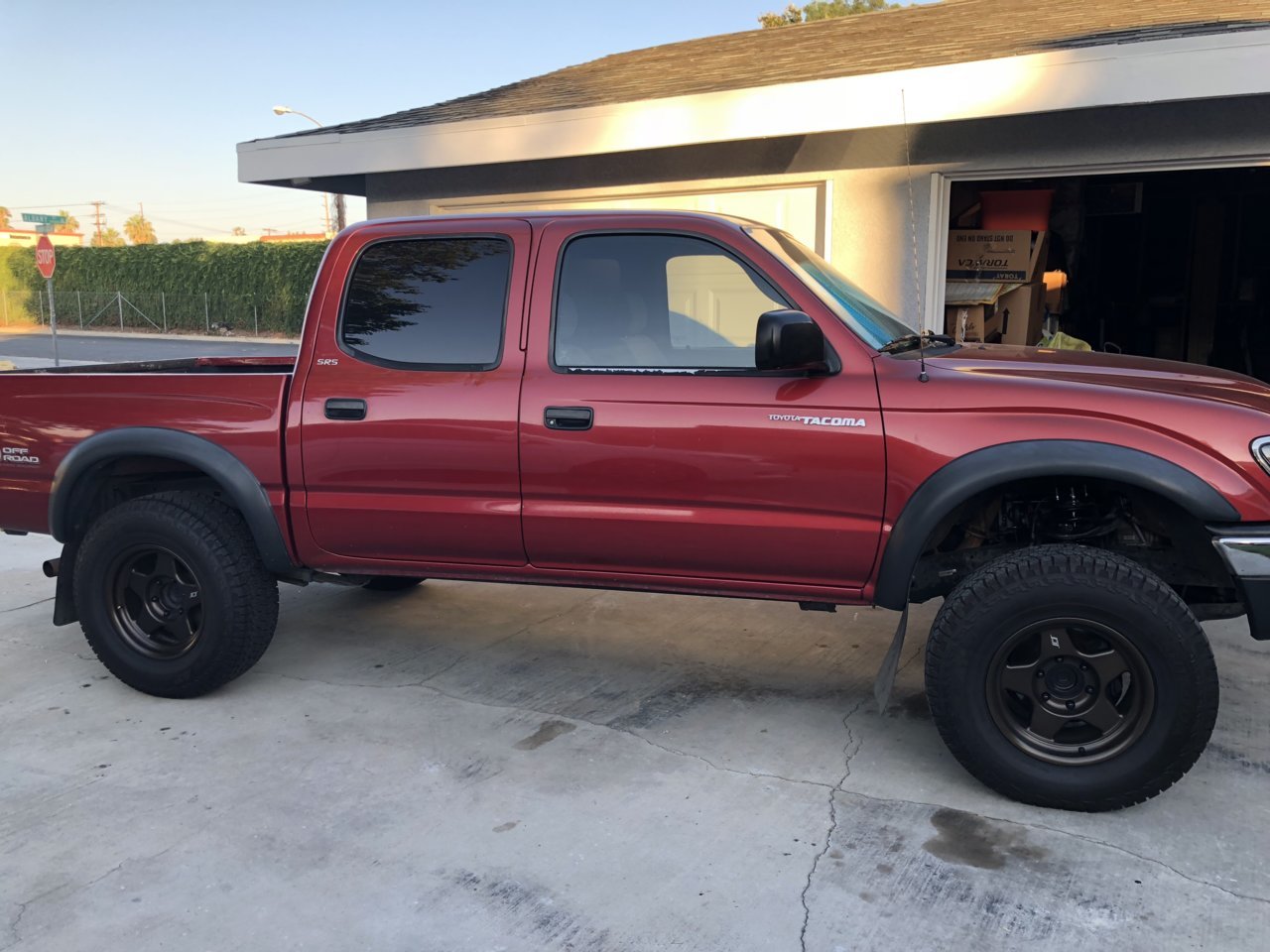

    03 DC prerunner trd v6 2wd
    Ome 881 5100's jba's looking for more
    Heres my with 881's n 5100's put in last Saturday got over 4" of lift i have 1/2 spacer on driver side an 3/8 on passenger side after a whole week of driving still at 39" from ground to fender no change :confused:

    SF NM
    02 DCSB prerunner 4x4 manual
    What position are your struts in. My 883s took about 1k miles before the settled down about an inch
    Bottom clip so just keep driving till it goes down a bit i only have about 300 miles on this set up i was thinking of removing the spacers off wht u think ?
    Go bomb some dirt roads or find a neighborhood with speed bumps it will speed up the process. Springs need to be compressed to break in. I would leave them in for now. Most people complain about 881 not having enough lift
    I would hit the bumps but my ubj's are screaming for help lol just need to take it easy for now till the springs are broken in 3460E59A-D7BE-41A5-ACF3-18EB4956C158.jpg

    02 DC 3.4L PreRunner. 1STGENN
    881 + 5100s + 10mm spacer plate 265s with TKOS Roof Rack Pioneer stereo Tailgate brake light Spyder tail lights Custom grille with toyota letters JBA UCA's Nerf Bars
    your truck looks soooooo good bro. Just get some new ucas and keep the 4inch lift lol
