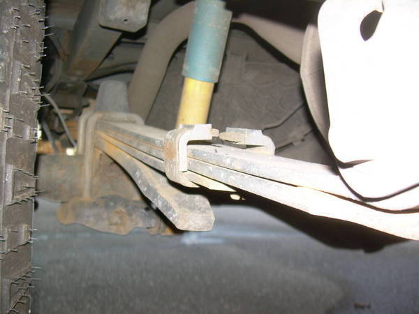

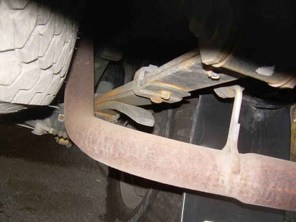

    Here's the pics, they look a little flat to me, im kinda leaning towards the Dakkars, any suggestions?

    your leafs don't look very happy :( I would go for the Dakkars if it was my choice.

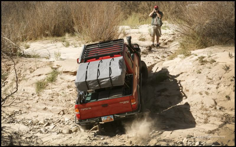

    '96 with full OME (881s up front)
    01 with OME in the rear and Kings in the front:

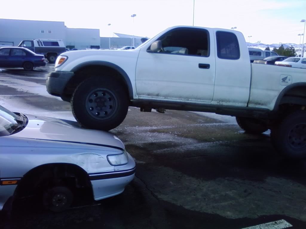

    bunch of crap
    and for kicks.... ha
    this is my full ome kit, no sway bar. spacer and shackles are coming :D

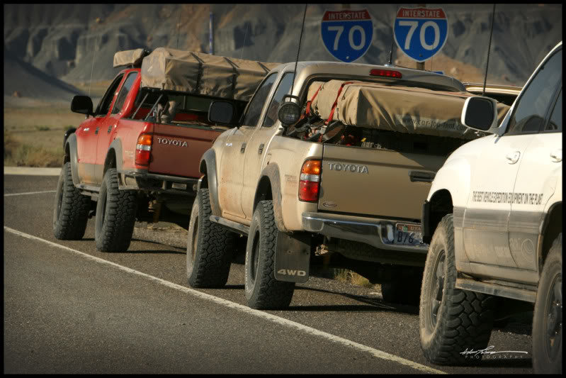

    This truck is running a full OME suspension with a few mods, like an extra 10mm trim packer in the front, and the OME AAL in the rear. Truck is owned by Kurt Williams, owner of Cruiser Outfitters (best source for ARB/OME products IMO). His truck works awesome and I would say flexes quite well with the AAL. You must remember that this suspension isn't designed as a super flexy rockcrawler suspension. The OME suspension is designed in Australia for trucks that venture into the bush for hundreds or thousands of miles of corrugated and rutted roads. The OME stuff can still rockcrawl but if you're after a ramp queen you need to look elsewhere for suspension.
    This is one of the only pics I have of Kurts truck, but I'm showing it because its a good example of constant load requiring the AAL. The truck has dual batteries, ARB bullbar, winch, hot water shower, supercharger, full Budbuilt skids, sliders, rear bumper, roofrack, bedrack with tent mounted fulltime. And when it hits the trails there is a full load of camping gear and tools etc. It's a pretty heavy truck, but Kurt has tried a variety of different suspensions and came back to the OME stuff as his suspension of choice. Seeing it firsthand I must say it does work quite well for how he uses it. Lots of overland miles and he probably camps more in a month than I do in two years.
    this last pic shows a good difference. Gold truck is mine with essentially the exact same suspension minus the AAL. My truck is carrying far less weight overall but you can see the Dakars just aren't handling the load as well as they are on the red truck with the AAL.
