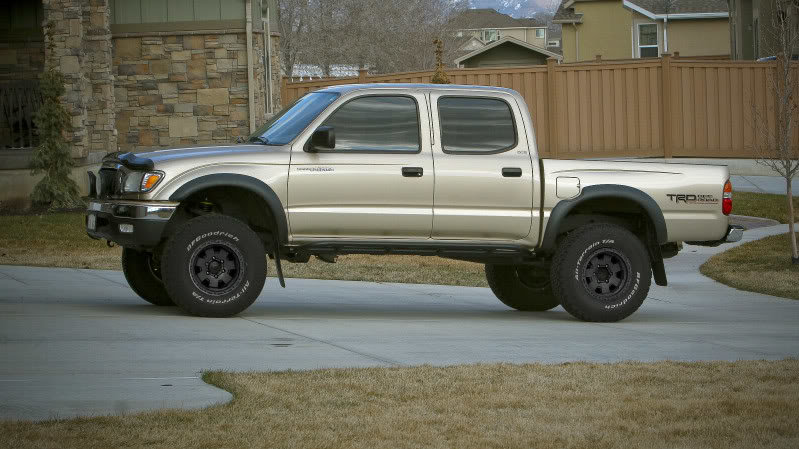

    I actually really like the 32x11.50's that were on my truck when I got it. Great size tire with a small lift. Back when my truck was naked.

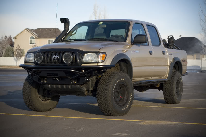

    What's the spec on the lift in those pics? The 2nd pic looks like 33x12.5s, right? I do really like the look of that a lot in the first pic though.
    Just don't want to crush my fuel economy or power, so I'm a bit trepid.
    EDIT: nvm just read your build page, post #1. 2" spacer lift?

    Same setup in both pics except for the armor. OME 882's 10mm trim packer, Dakars. 32x11.50 BFG ATs.
    Edit: the spacer lift was gone within the first couple weeks.
