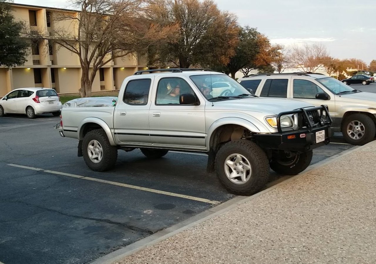

    I’m currently running 882s with one 5mm trim packer and dakar leaf springs. I'm going to be adding a front diff/tcase as well as a skid and winch so that will solve my PreRunner on 882 coil problem. This picture is with a half full tank so it gets ever so slightly worse with a full tank of gas. I'm going to install my add a leaf kit during the 4WD conversion and see what it looks like then. Right now I'm thinking a second trim packer and a leaf spring shim might be the only way to correct it.

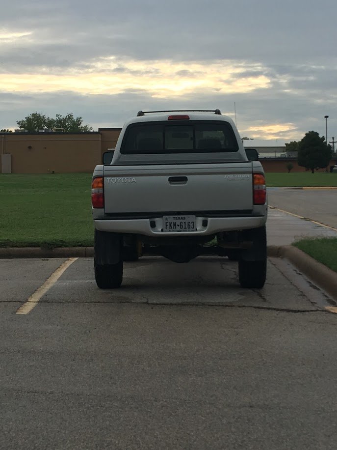

    Main reason I'm getting the add a leaf.... I actually made some contact on the fender flares in the rear off-roading on this camping trip. Wouldn't have happened without the ass sag.

    Do you have a Dakar leaf pack or just aal? I have the same model as you but 4x4 and I have way more lift in the rear with the Dakar leaf pack from wheelers. Also how much is your lean, looks to be 1-2”? Seems like you have more lift in the front even with the arb bumper.

    I have the Dakar pack but that bottom picture is with probably 300lbs in the bed. I bought the add a leaf to counter the sag from a load. I have a bit too much lift in the front right now since I'm still 2WD.

    Are you also running the Ome nitro shocks in the rear as well? That’s a lot of sag for 300lbs or maybe your front is really high so it throws it off?

    That's a lot of sag for only 300 pounds, that's like two average size dudes in the back of the bed :drunk:
    It's gotta be more weight than that.

    Nitros in the rear too. I had a ton of wood, a full cooler, and two people in the back seat. It was prbly more weight than 300lbs.

    Yeah doing the math it was probably a lot more than 300lbs. I had a jet ski that weighed over 300 in the bed and it didn’t sag at all really.

    I had 700+/- lbs of garden rocks in my bed for it to look like that. The back was 1” lower than the front from all that weight. So that looks to be over 600lbs at least.
