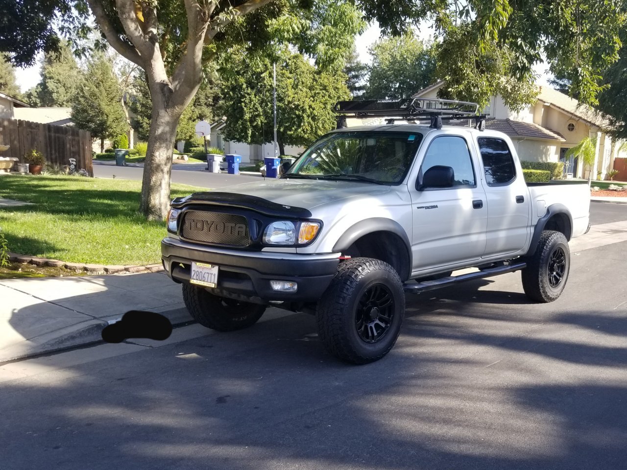

    02 DC 3.4L PreRunner. 1STGENN
    881 + 5100s + 10mm spacer plate 265s with TKOS Roof Rack Pioneer stereo Tailgate brake light Spyder tail lights Custom grille with toyota letters JBA UCA's Nerf Bars
    here she is: OME 881s + 5100s + 10mm aluminum spacer plate paired with JBA UCA's. Hub to fender measurements 24 & 3/8" inches.
    double cab prerunner 3.4L v6
