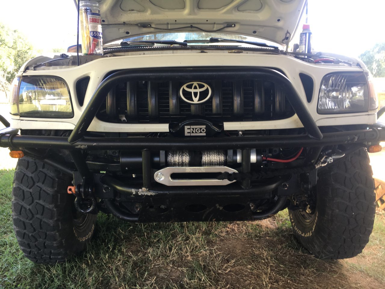

    Anyone know of someone here with a heavy truck and 4cyl. engine using OME springs?
    The addition of a winch has finally found the limit of my 881s, so I'm looking to swap coils. I'm trying to find a point of reference with someone else's truck. However, it's very hard to find an apples-to-apples comparison because there doesn't seem to be many heavily armored trucks of my same configuration. If you know of anyone fitting the description above, I'd appreciate if you could point me their way.
    Pics for attention :p

    based on a quick scan through posts it seems like the 883’s are ideal for added weight to the front end? i could be wrong though i dont really know much about any of this

    also is that a trailgear bumper? and did you paint your grill white?

    Thanks, but I know. Looking for real world feedback from trucks of the same configuration. My truck, is much lighter from the get-go than others. I4, ext cab, manual trans.
    All-poo Baja. Yes, painted white.

    I'd suggest the 882's. you're not that heavy with the tube bumper and a 4 banger. 883's would be fine, but maybe a little stiff. I'm heavier with the hybrid bumper and the v6 and I run the 882's.

    Between the 882 and 883, I agree that the 882 would be best. I'm more concerned that either of them will end up giving me too much lift. I'm not about the torn boot life. haha.
