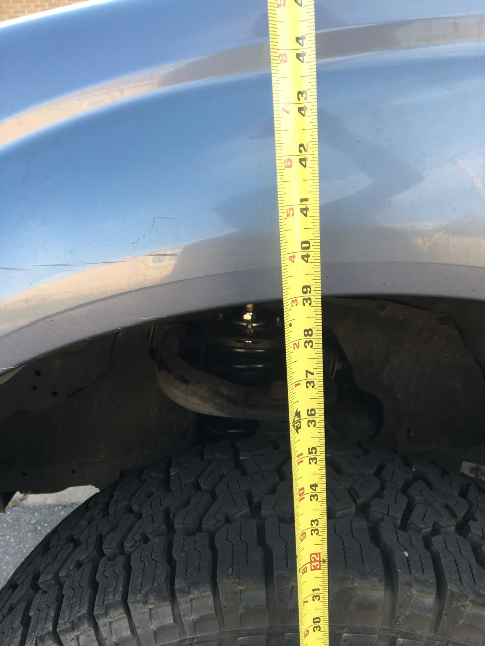

    If you don’t mind can you measure from the ground to the bottom of your fender? For the front ome880 and nitrochargers. Thanks. And also the rear!

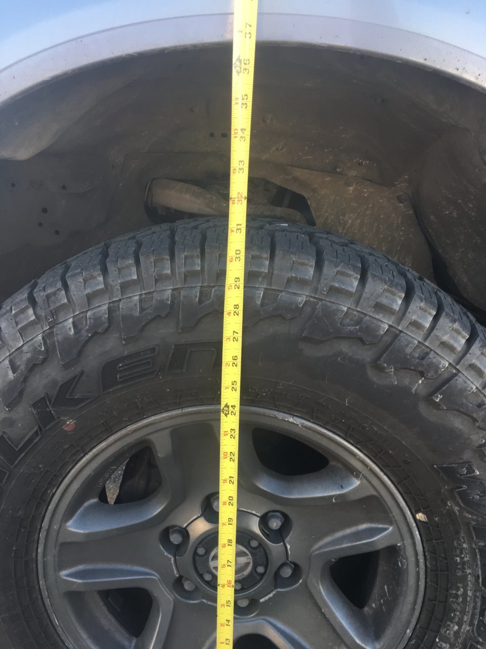

    @tommik11 Ground to fender, 880 and nitrochargers on the same configuration (reg cab, 4x4, 2.7)
    Rear right after install, it's come down a bit since then.

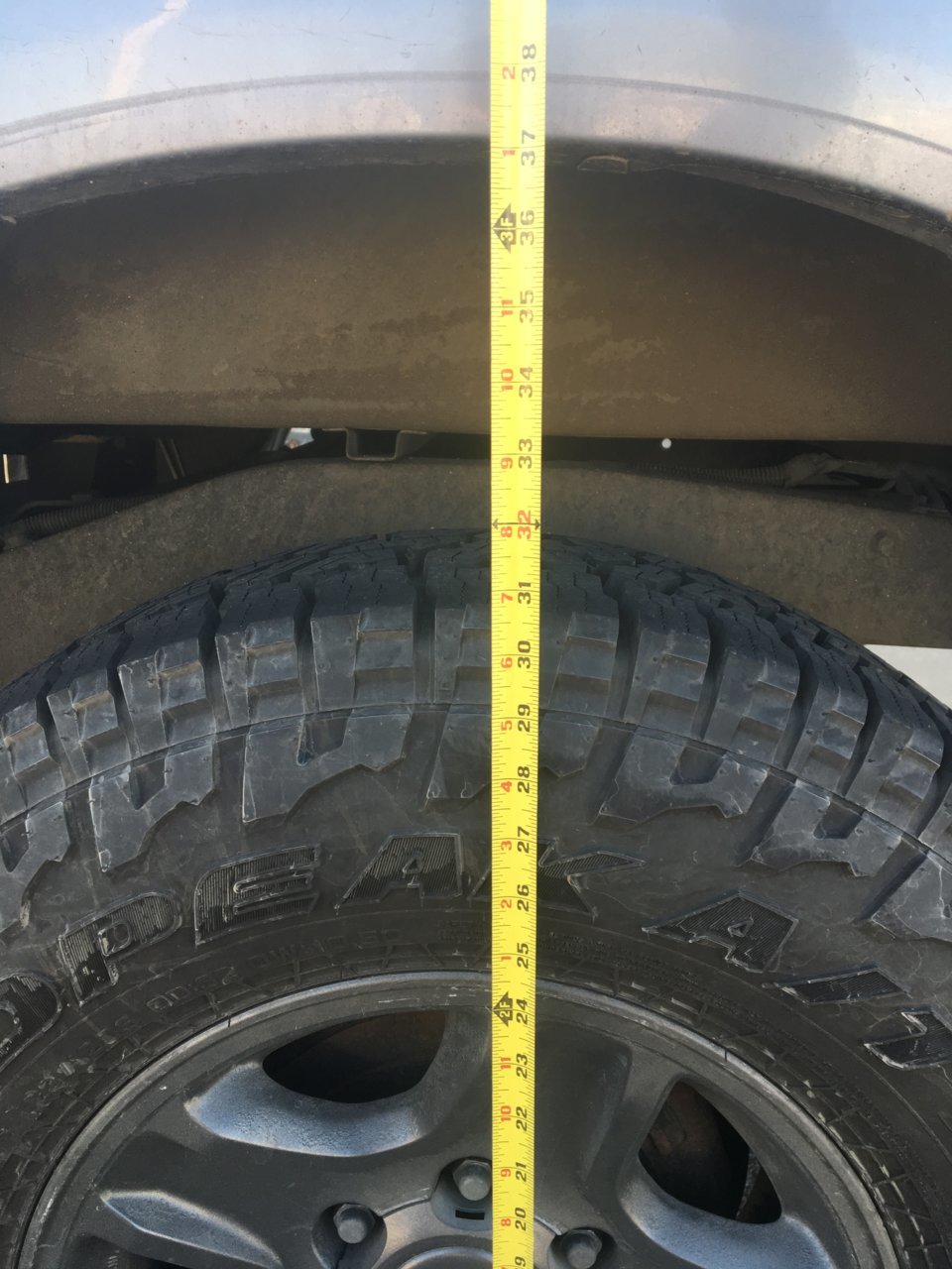

    And how it sits with a topper, no meaningful weight in the bed:

    It looked weird at first, especially with the rake before I got weight in the back to break in the dakars. I'm real happy with how it looks now.
    I think these are my original measurements
    Right after installing:

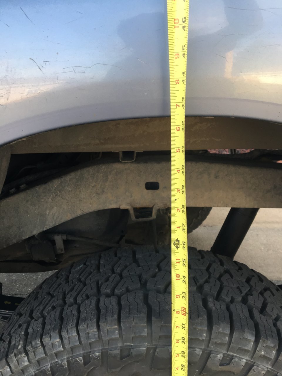

    Mine is 37" up front from ground to center of wheel well and 36.5 " in the rear. I have about 500 lbs on the back including the topper.
    OME 880's up front. Nitrochargers all the way around and Deaver J59 leafs. 245/75/R16 tires. 2004 RC 2.7.
