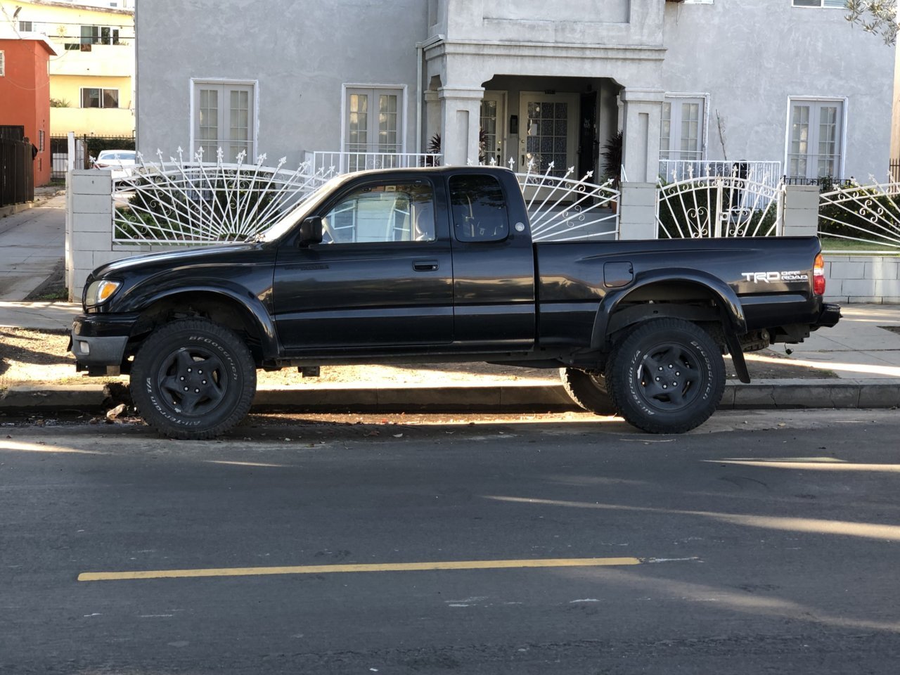

    2003: Bad clear coat, OME HD kit w/Dakar leafs, ShmellFab sliders, Badland Bumpers rear bumper, Bestop Supertop & Yakima/Tyger roof rack. SOLD - 2002: TRD PreRunner with a DERP sticker, some desert stripes, couple of rock scrapes, E-locker, OME front & rear w/Dakar leafs, and CURT front/rear hitches.
    Had this 880 kit with dakars on here for a year and a half. The back sat a bit higher when I had gear back there. It's definitely taller in the rear. I never felt like I got 2" in front with the 880s, but it handled worlds better than the stock setup. This '02 taco's going up for sale, so I bought another set with 881s for my newer '03.IMG_1874.jpg
    Just glad UPS was able to hide the box so well...
    My '03 has what looks like a 1" body spacer in the front. I'm trying to figure out whether or not I want to keep that, or scrap it.

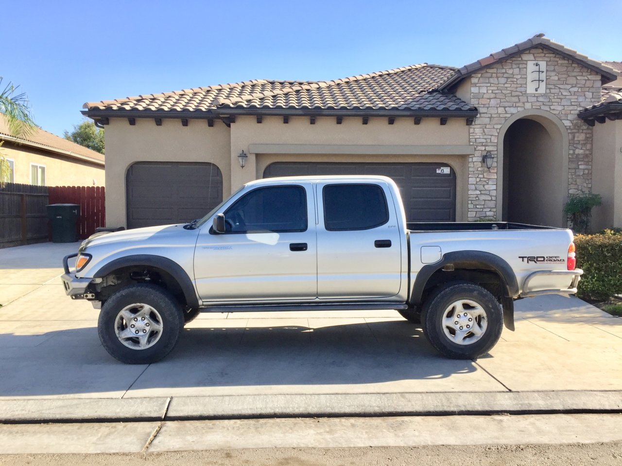

    After reading as much as I can without my head exploding, I jumped the gun and purchased 5100’s front and rear with 881 coils, Dakar’s CS019r leafpack. My original suspension has 302k on it. I was debating this setup with the full OME kit. A whole lot of valuable info was gained from this thread and I appreciate the wealth of knowledge that is on here.
    I’ll have it installed sometime next month and will report back with before and after pictures
    Kpatt9, beez, 2002Tacoma4x4 and 2 others like this.
