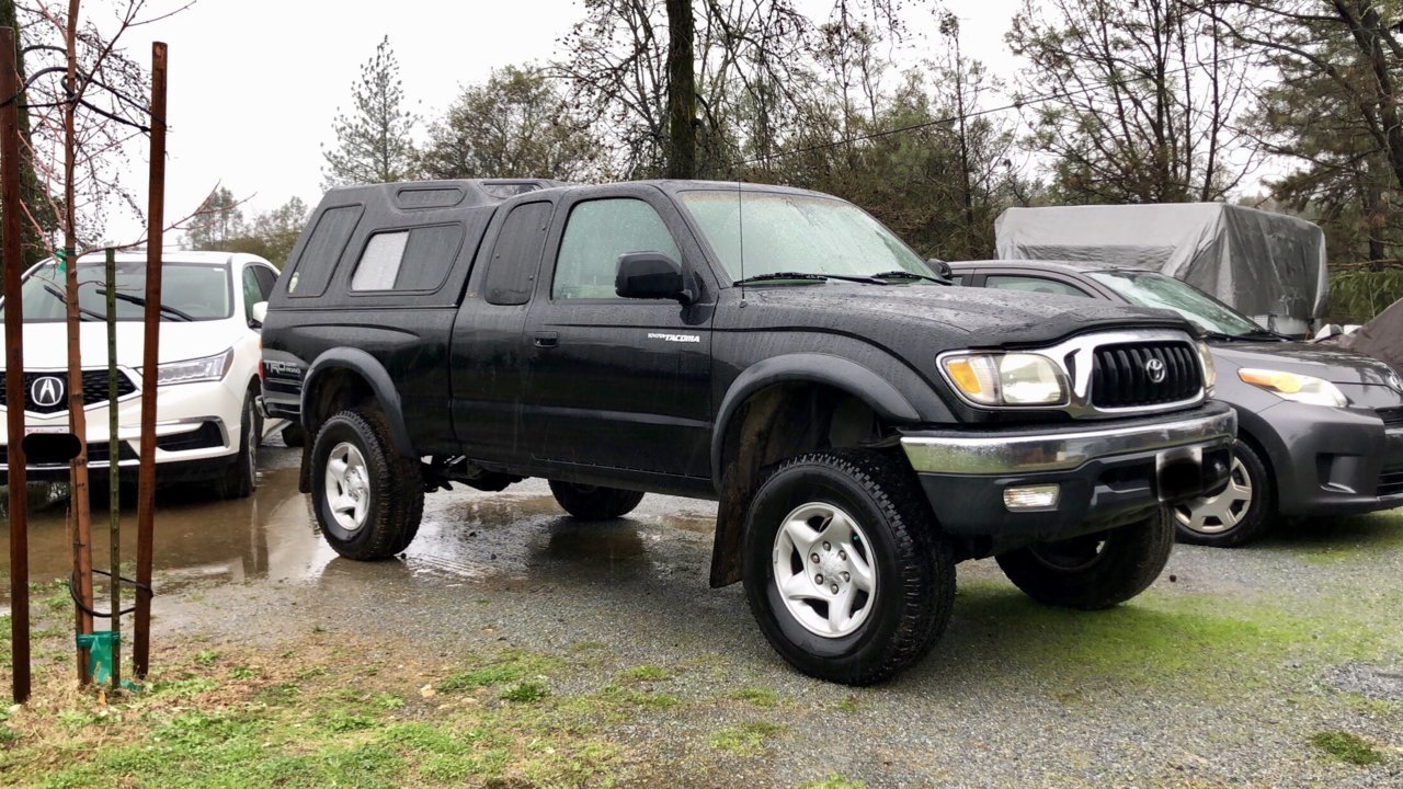

    #4162
    chrispchicken9
    chrispchicken9 Well-Known Member
    Aug 31, 2018
    #264753
    992
    '04 3.4 tacoma, '16 4.0 4runner
    ome 880 because pre runner, no front dif n all (n no CV's to worry about)
    also should have noted I added an extension to lengthen the driveline to make up for the added lift (as opposed to a dif or CB drop). Wanted to keep the angles more or less the same as stock - granted its rwd

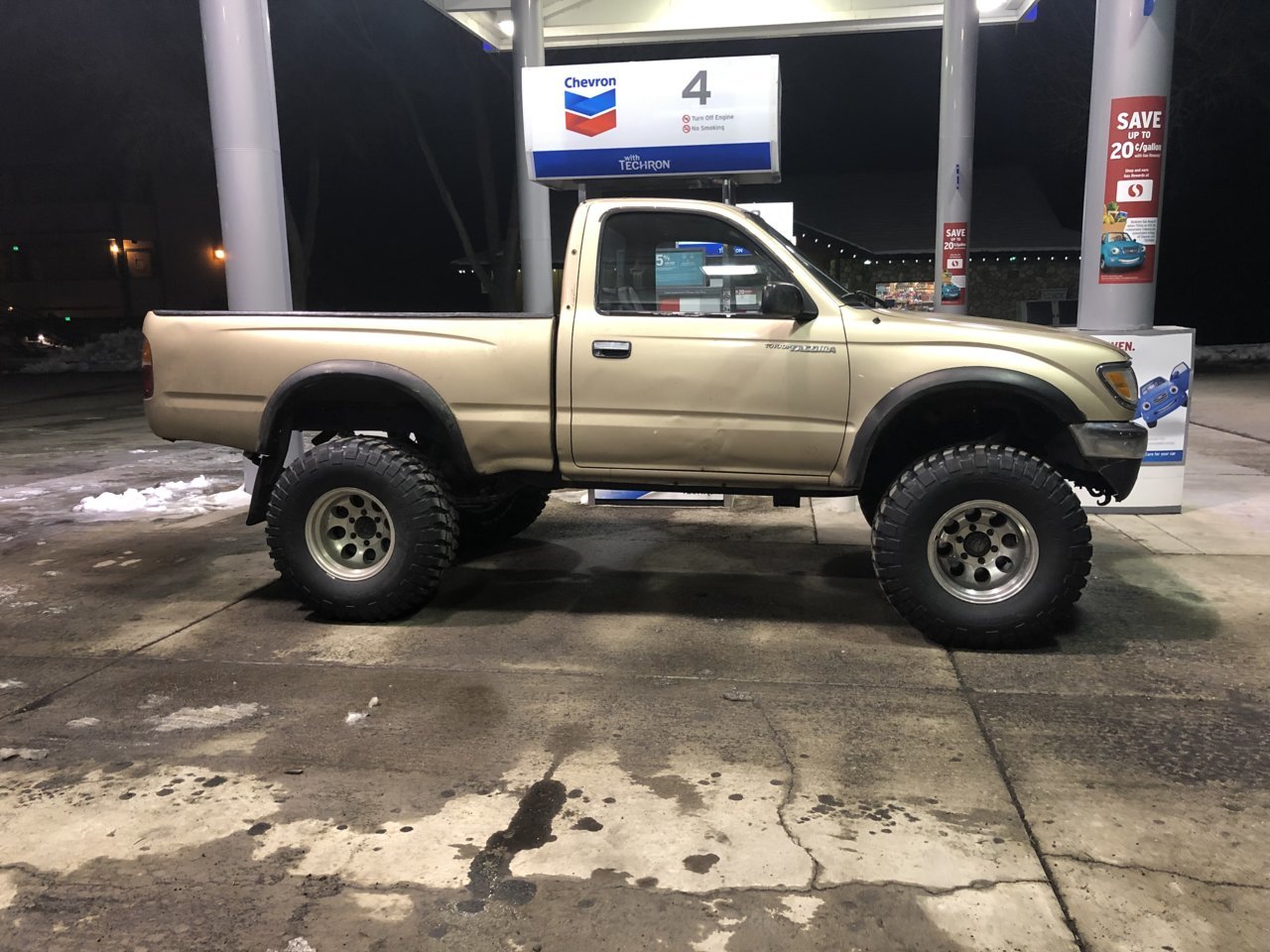

    Got those manual hubs :drunk:
    OneWheelPeel and DJB1[QUOTED] like this.
  5. Feb 6, 2019 at 6:42 AM
    #4165
    lukester78
    lukester78 Well-Known Member
    Nov 3, 2016
    #201425
    885
    Luke
    97 Tacoma Single Cab 4x4
    Ahh gotcha! Interested to see how much lift you have in front after the body lift is out. Wheeler’s suggested I go with 880s up front. The back end looks about as high as when I first installed my Dakar’s:
    Your truck definitely looks good!

    chrispchicken9
    Aug 31, 2018
    #264753
    992
    Thank you!
    Had slight drive line vibration at 20-25mph with the AAL
    Could have been because I lifted the rear first, without doing the front.. and i dang near got 2.5" of lift when I added the leaf.
    Was looking into carrier bearing drop to help straighten things out but thought was lengthening the driveline was the way to go to keep the angles more or less the same and add length to make up for the added lift.
    Runs very nice now
    The 880 coils on the new shocks are very nice, million times better than I had before. She eats up big bumps very nicely. I don't think I would have done anything different

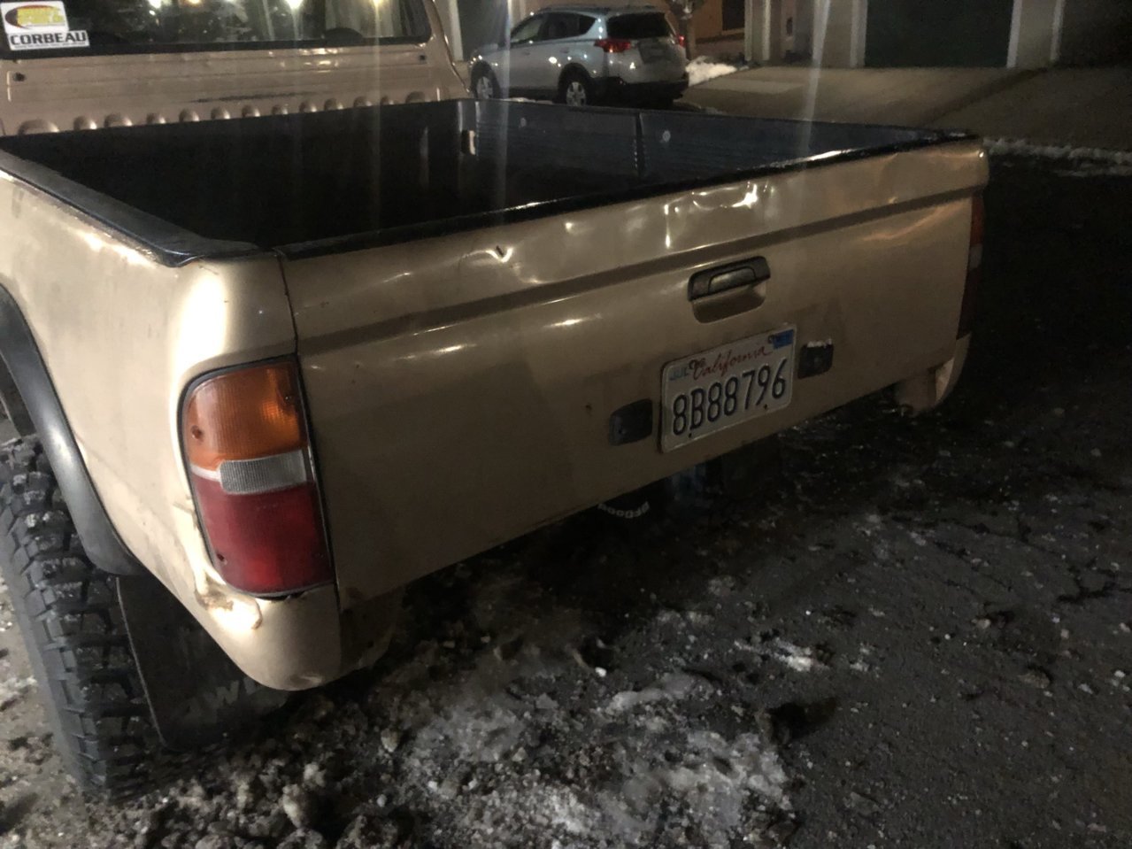

    Ben_B_Rad
    Ben_B_Rad Active Member
    Aug 22, 2017
    #227589
    26
    2017 DCLB Off Road
    Half the body lift is out! Those bolt were super rusted. Only took 3 hours to get out 5 bolts and drill and tap the other.
    “Custom” license plate location :notsure:
    Can’t wait to get the cab mounts off. It’s pretty difficult to get in and out of this thing.

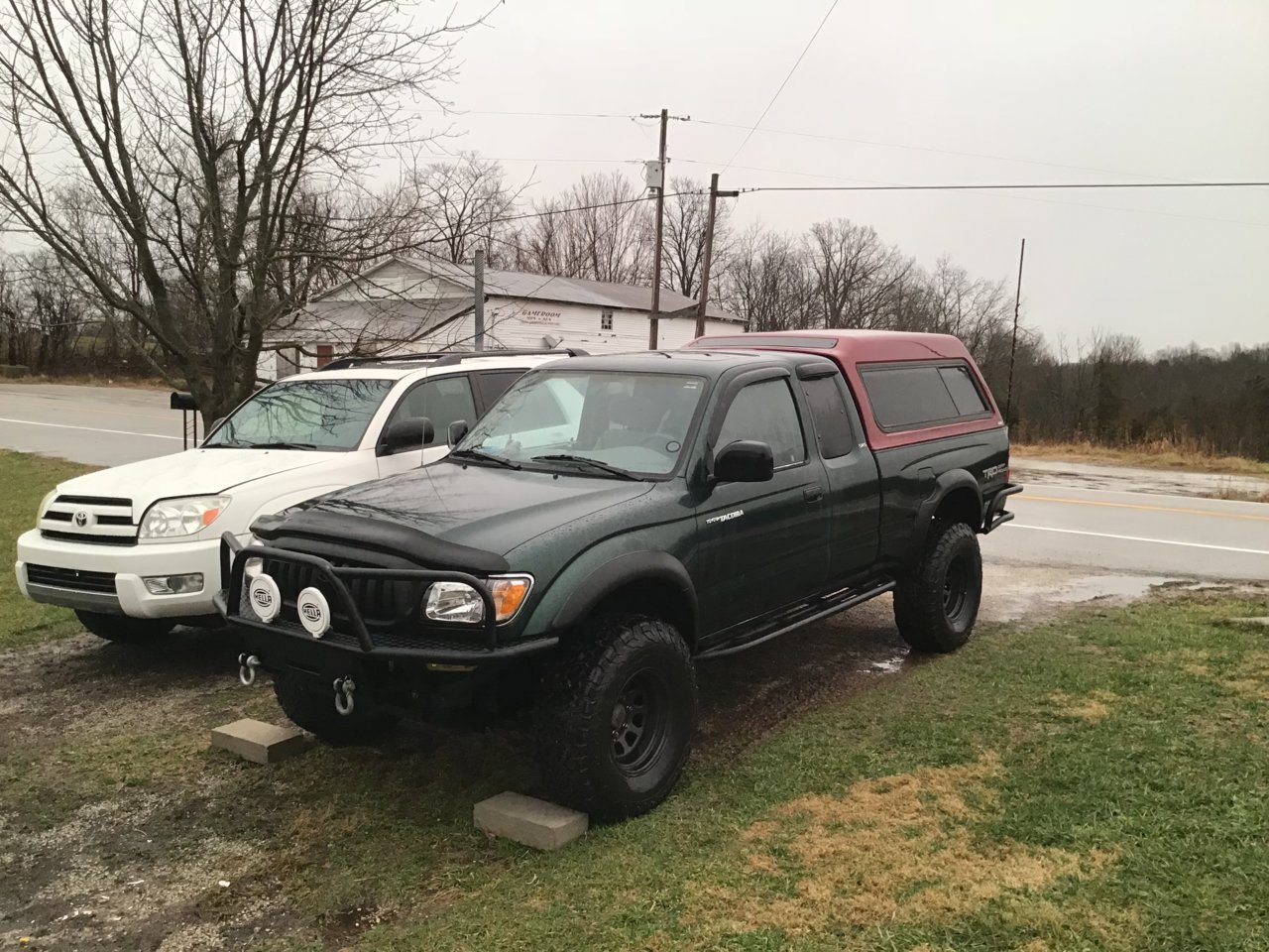

    DW85 Dude.....
    Jan 17, 2013
    #95397
    928
    Daniel
    Kentucky
    2001 XtraCab Tacoma TRD 4x4/2004 SR5 V6 4Runner
    Tacoma: Badlands basher front bumper Trail gear rear bumper Trail gear sliders OME Dakar’s OME 883 Coils Bilstein 5100s front Bilstein 5125s rear SPC Upper Control Arms Wheeler’s Extended brake lines ProComp 51 Series 15x8 3.5” BS 32x11.50x15 BFG KO2’s Honda CR-V windshield washer nozzles Hella 500FF fog lights Energy Suspension power steering rack bushings 4Runner: Hankook DynaPro ATM RF10 265/70r17’s TPMS Bypass mod RCI Skid Plate CBI Ditch light brackets 1.25” Wheel Spacers 2” Front Leveling Kit
    Front: OME 883 on Bilstein 5100’s Back: OME Dakar’s and Bilstein 5125’s

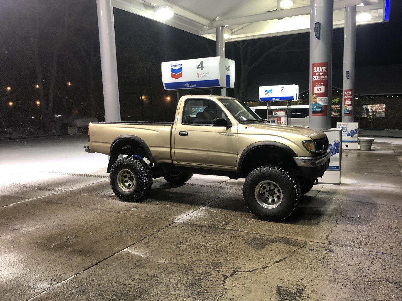

    Ben_B_Rad
    Aug 22, 2017
    #227589
    26
    2017 DCLB Off Road
    No more body lift and now I have only a 1/2 of rake

    DashMaple
    DashMaple Well-Known Member
    Feb 11, 2018
    #244129
    981
    Louisiana
    01 V6 4wd PreRunner DCSB OME lift
    I like that bumper, mind me asking what it is/ some better pictures of it?
