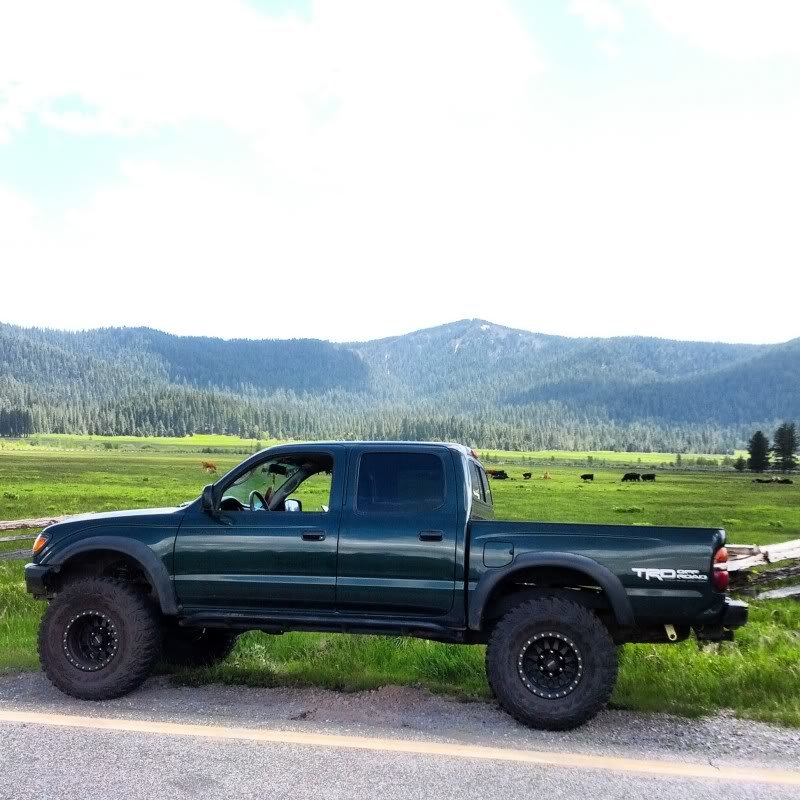

    BioWheelin
    BioWheelin Well-Known Member
    Jun 24, 2013
    #106978
    99
    California
    03 DC 4x4
    K&N air filter Wheelskin wrap

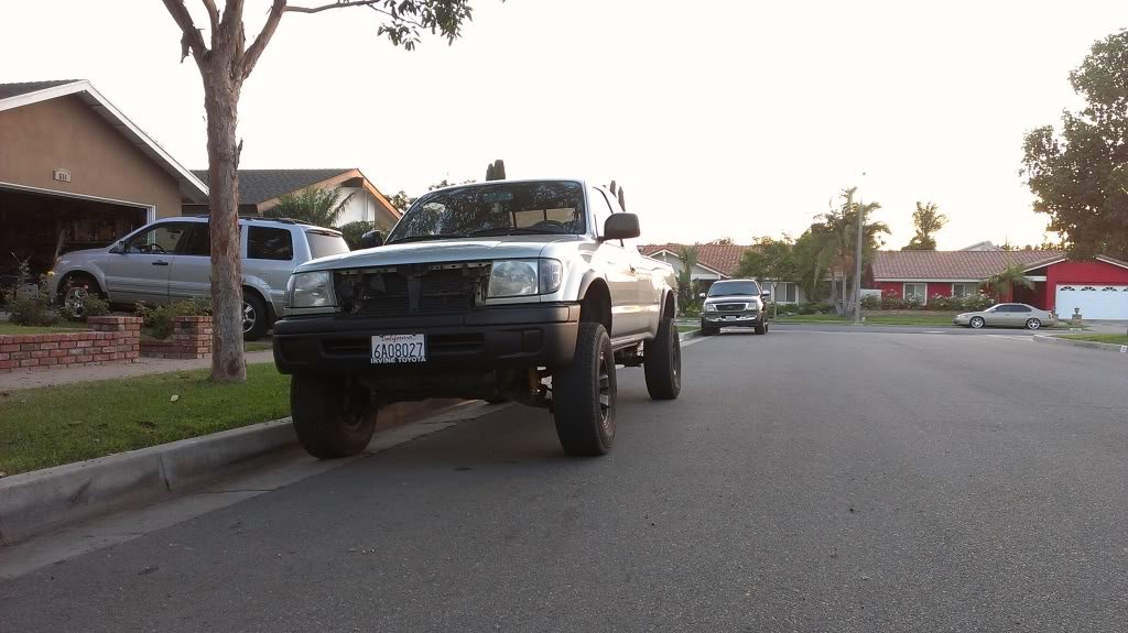

    davidjmay
    davidjmay Well-Known Member
    Sep 2, 2012
    #86090
    880
    David
    Orange County/Azusa
    '00 PreRunner
    Pioneer HU & door speakers, Alpine type R, Kicker dx1000.1, OME 883 lift, Wheelers 2" AAL, custom mesh grille, smoked LED taillights, LED light bar, Raptor exhaust dumped before axle, custom fabbed roll bar/light bar mount
    OME shocks with 883's up front, wheeler's 2" AAL in the back on stock springs, toytec extended length shocks!
    EDIT: That looks like a lot more bro lean than it really is. I think the camera was tilted but it sits pretty even

    ffirg
    ffirg Well-Known Member
    Jun 9, 2011
    #57975
    4,876
    mike
    Anchorage, Alaska
    2002 Tacoma SR5 TRD 4X4
    Those 883s will settle after a 500 miles or so. Especially if you load down the truck.

    davidjmay
    Sep 2, 2012
    #86090
    880
    David
    Orange County/Azusa
    '00 PreRunner
    Yeah I'm not worried about it. Like I said it sits pretty even as is

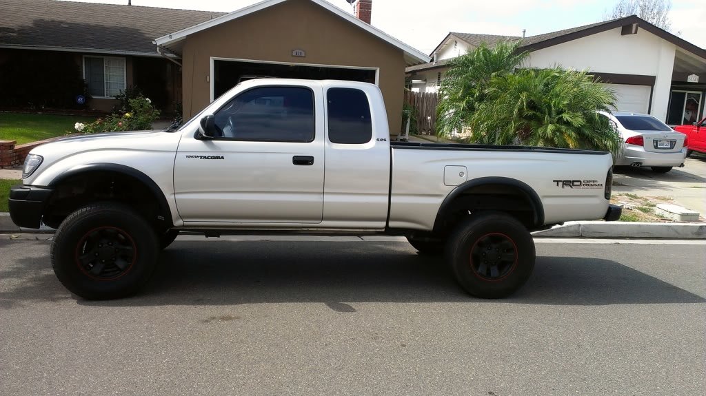

    lonzorizo
    lonzorizo Well-Known Member
    Sep 5, 2010
    #42784
    1,405
    Lonnie
    Hoopa, Ca
    2003 TRD OR, 2016 TRD OR Tacoma
    882's with 10mm top plate spacer. 3" AP's and AP shackles.IMG_20130518_190838_zpsd25e773d_89c75a37d16df8fd4e564cae73cf2f6d40c56ba0.jpg

    nigglewiggle60
    nigglewiggle60 Well-Known Member
    Jul 3, 2012
    #81858
    134
    Nigel
    Oakhurst, CA
    2004 DC 4x4 TRD
    Rubber mats, Bluetooth.
    ^ nice setting.

    lonzorizo
    Sep 5, 2010
    #42784
    1,405
    Lonnie
    Hoopa, Ca
    Yeah it's nice living by a national park lol.
