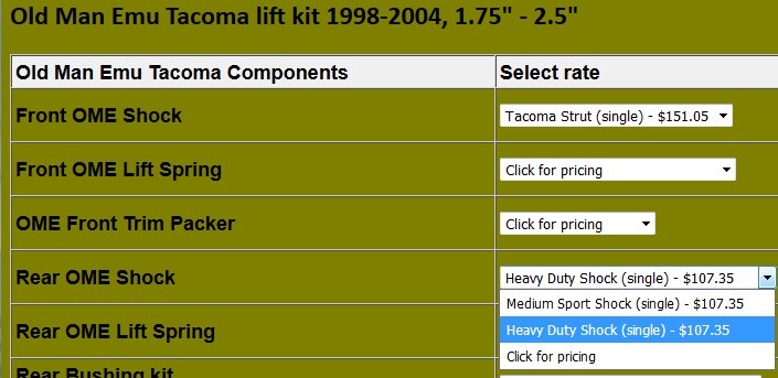

    What is the difference between the OME rear Nitrocharger Sport shock p/n OME60062 and a HD rear shock p/n OME60065?
    I have only seen the 60062's listed on most vendor's websites (e.g. Wheelers, Headstrong etc), but on the Rocky Road Outfitter's Old Man Emu Tacoma Lift Kit & Accessories web page, they distinguish between the two. But I had to put the Medium Sport Shock in the shopping cart to see it is the OME60062, and likewise, the Heavy Duty Shock in the shopping cart to see that it is the OME60065.
    When, if ever, would I want to run the 60065's in the back rather than the 60062's? Does the amount of weight that is in the back of the truck affect the choice of the shock? I thought that was more a function of the springs that one chooses?
