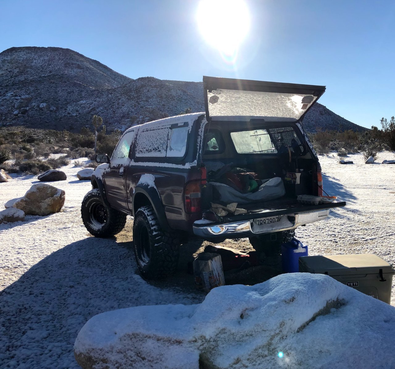

    Im planning to go OME... I have a 1996 Tacoma reg cab with an ARE camper on the bed. Right now i have bilstein 5100s front and rear set to the second setting with stock coils and leafs with a 1" toytec AAL. So far I am planning on getting OME 2883s to install on my 5100s on the second setting and OME Dakars in the rear. Anything else I should get? Longer shackles? Lift blocks? spacers? I want to clear some bigger wheels and get the truck higher off the ground in general. any help would be great. ive been asking everywhere and getting nothing.
    heres my truck

    The OME Greasable shackles are nice. Just say NO to the blocks and spacers. Because of the cap and any added weight (definitely do if you'll be +200lbs), order with an AAL. With an AAL, you'll need longer u bolts. Even if not going the AAL route, still order new u bolts. Should never re-use them (imo only of course :thumbsup:).

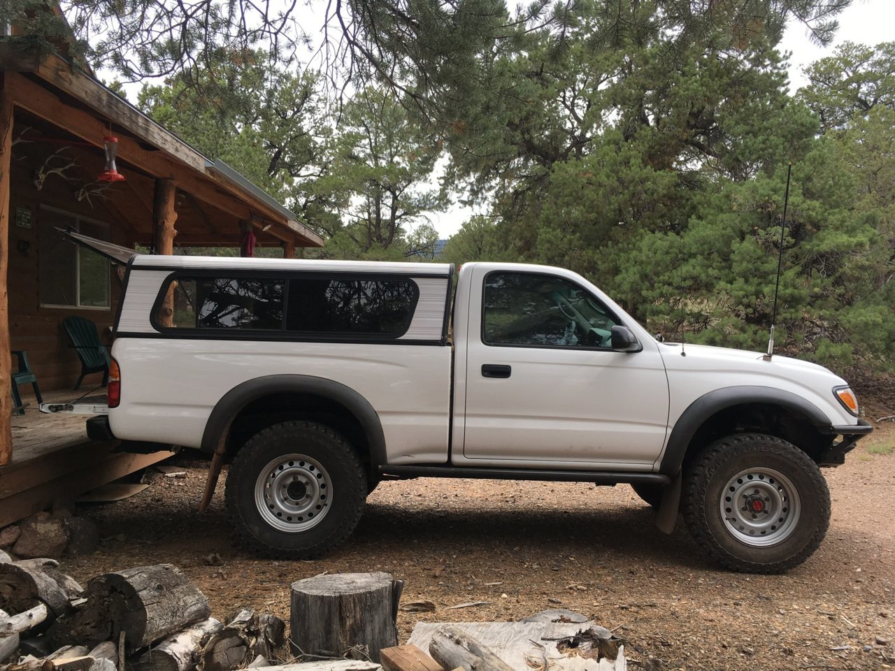

    2003 Regular Cab 4X4 5MT
    I do, @btbowie. Dakars, 880 coils and 235/85r16 Cooper ST Maxx’s.0DDE2010-FC39-4E31-AF5D-47CA000B3CA8.jpg
    I like the ride a lot, it’s not sketchy at all without the sway bar. The Dakars greatly improved the on-road handling as well.
