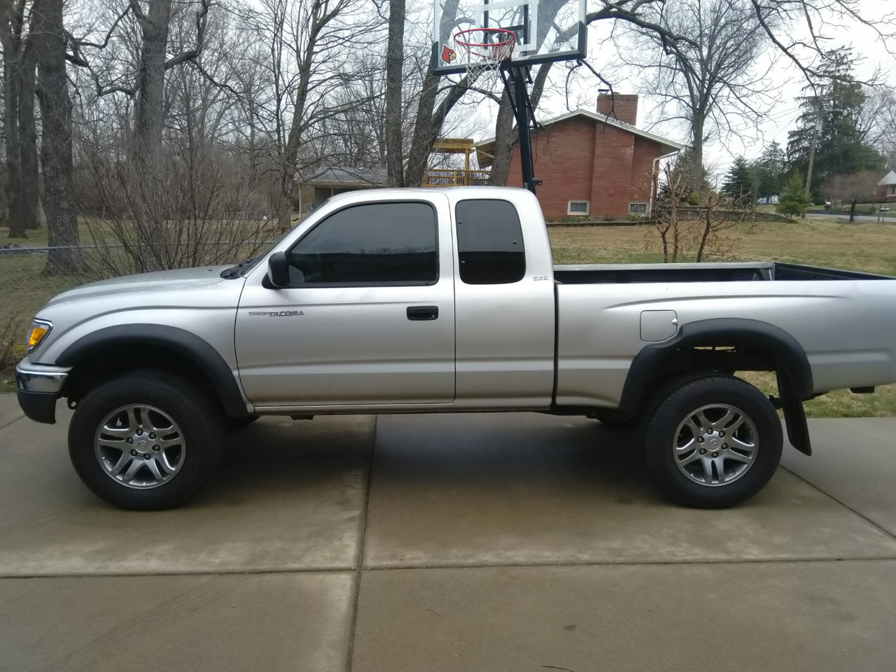

    Getting ready to order new suspension for my '03 extended cab. Full 3/16" skids, Trail Gear front tube bumper, All Pro sliders, with a cap on the back and like 400-500lbs of tools and gear. I'm looking to get just under 3" of lift over stock. This way I can ditch the crappy spacer lift. I was leaning towards Nitrocharger shocks all around with 882's up front and new leaf packs in the rear. Any suggestions? Edit: I already have the diff drop.
    [​IMG]20180923_184816 by Bob Condor, on Flickr

    Pulled the trigger today and called Wheelers. Ordered the 882's and Dakars w/ the aal along with the full kit. They were great over there helping me out and can't wait to get my parts!

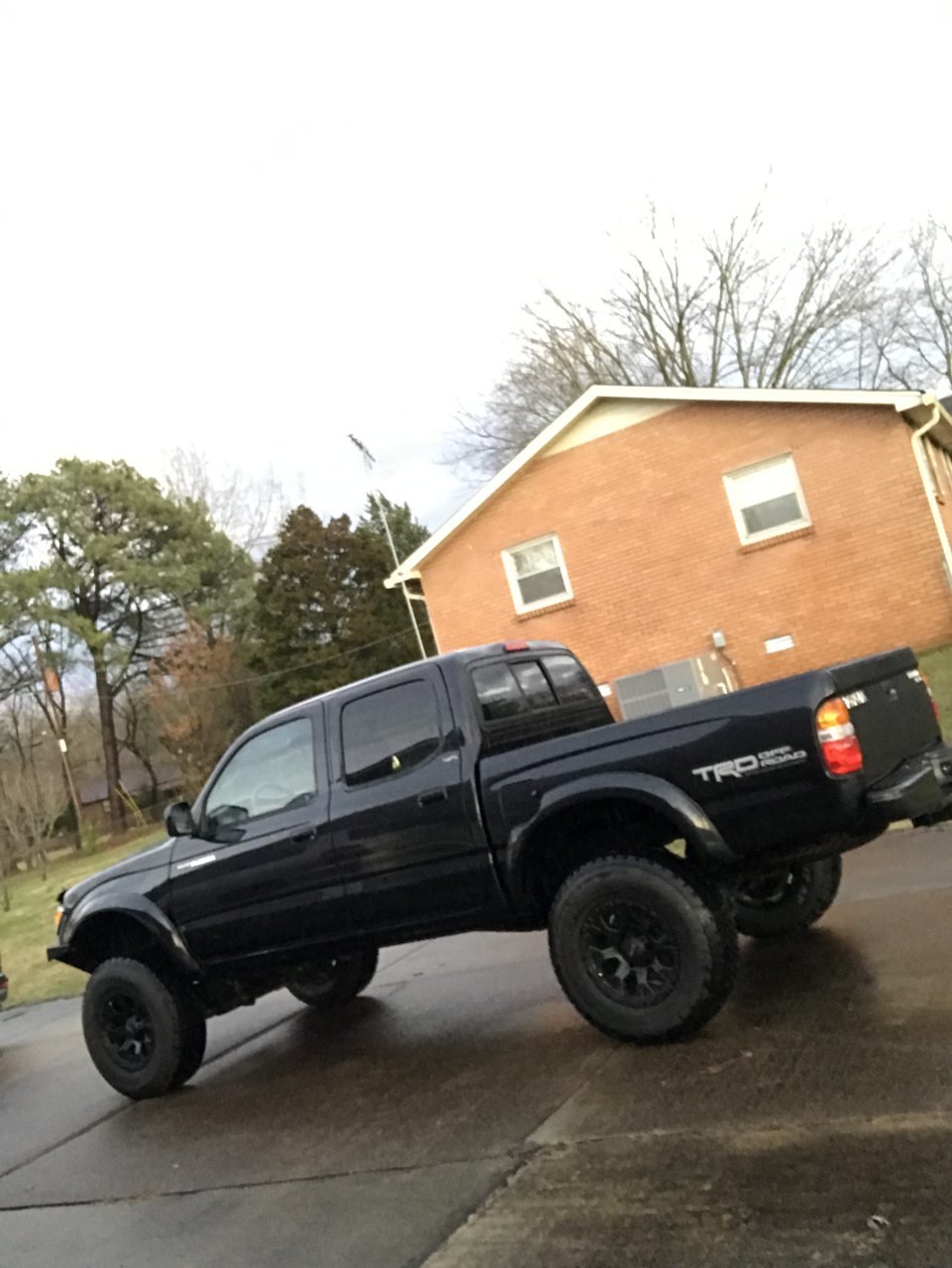

    A652B349-923A-498B-84F5-0F3DAF1B494E.jpg 5B2BDE2E-CE32-4E76-9101-80F57B4907DD.jpg 931F5A21-48AE-4152-B92F-883DCFE2CF3C.jpg I’ve got an 02 Double Can w/ OME kit and 881’s. Also running 255/85/16’s.
    Gave me ~2.5” lift over stock. Bigger tires gave me a bit more too.

    Nice truck! Do you have any rubbing with those tires?
